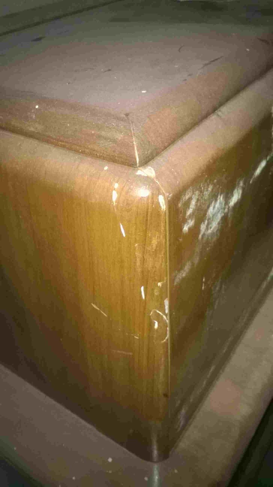

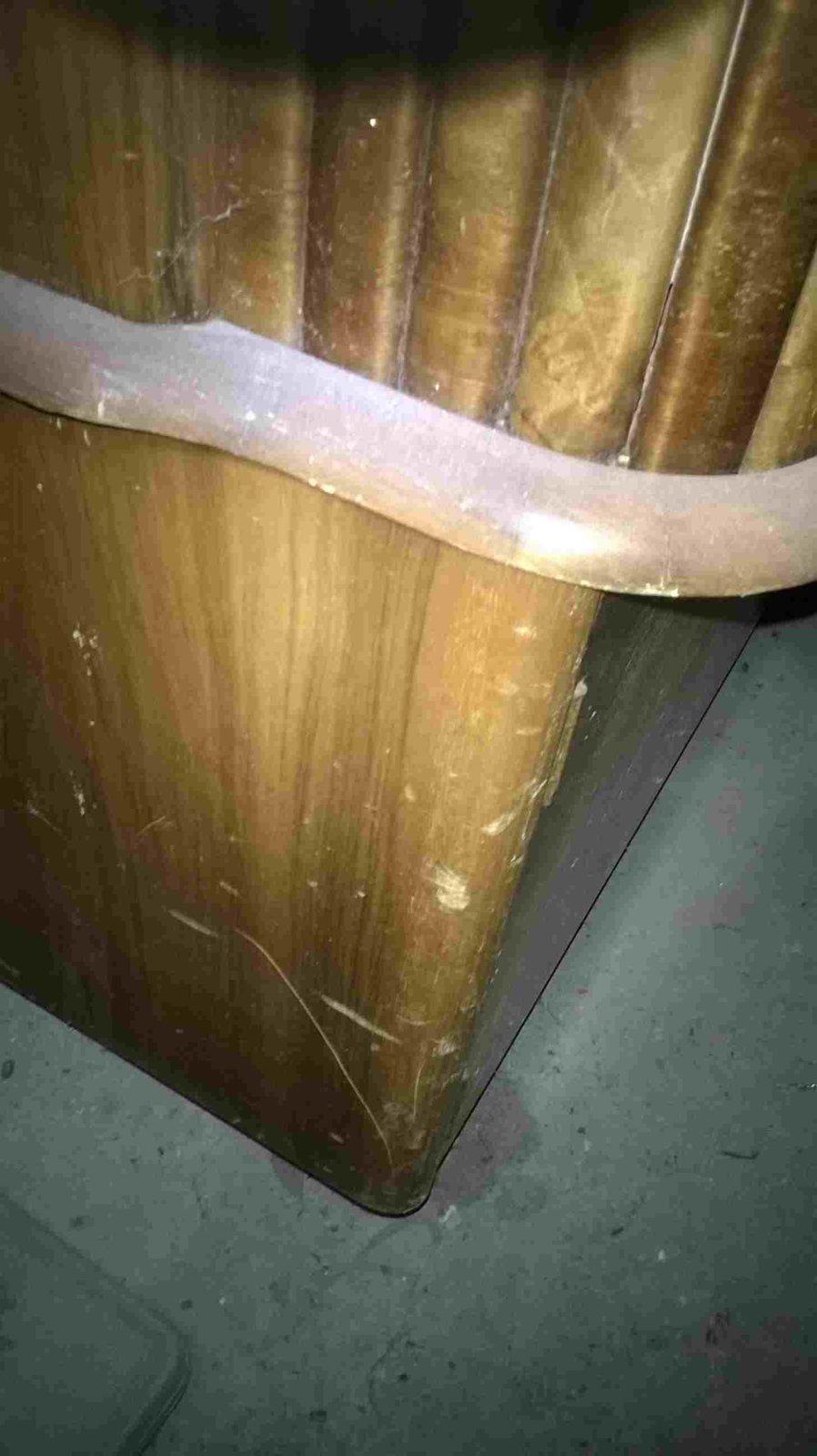

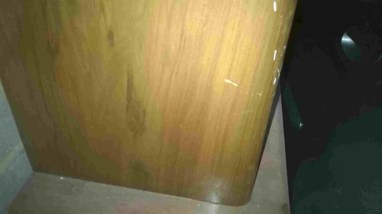

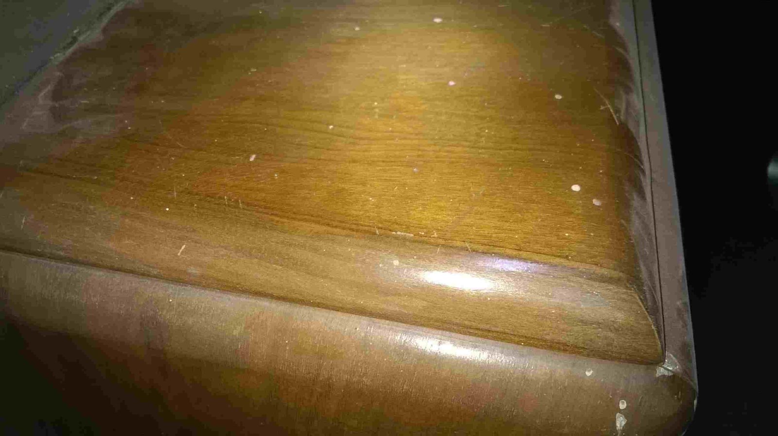

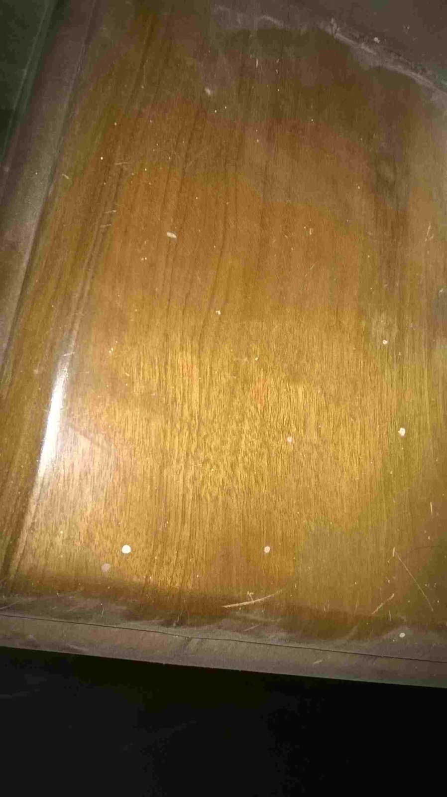

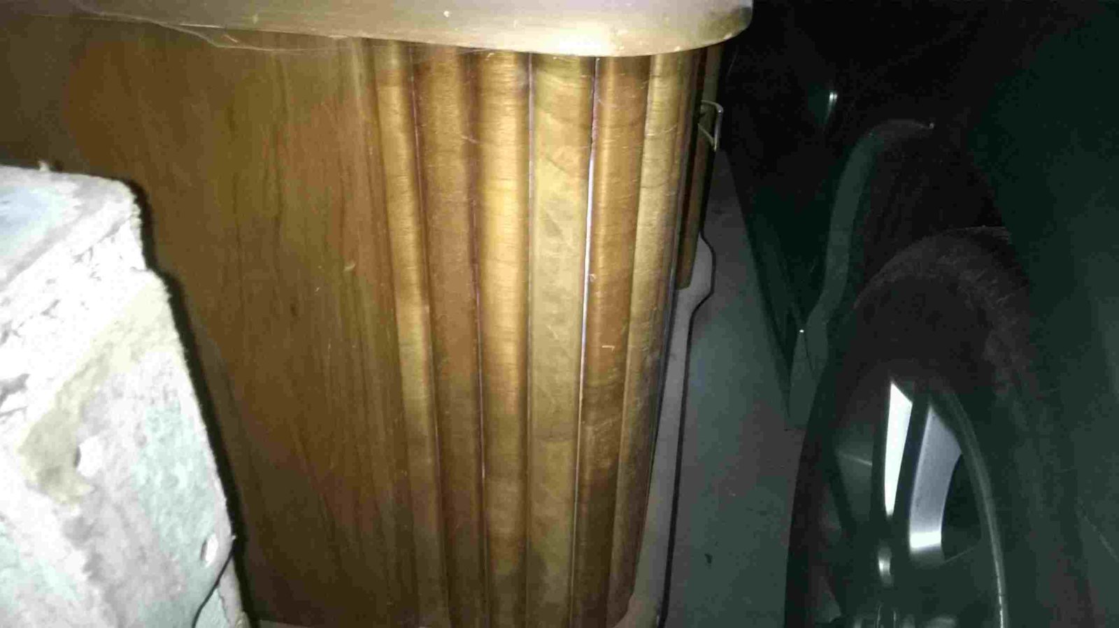

I'd like some advice before I start, on whether I should tackle this myself, or not.
It's a 1930's art deco cocktail cabinet, which has had its varnish deteriorate in places and I'd like to get it back to the original wood and stain and varnish it again.
There are a few chips in the veneer (walnut possibly), and a tricky job will be to refinish the slat doors - I'll have to remove the flexible backing to do this.
I'm a competent DIY enthusiast and can handle most things, but should I proceed, or get a professional to do it? It only cost £70, so the risks aren't too high.
Sorry about the crummy photos, it's hard to get to at the moment.

I guess that it would cost a fair bit to have a pro restore it, and wouldn't be worth what you pay them afterwards?
Refitting veneer is tricky but a light rubdown and refinish is more time than skill
big horrible job for a DIY. That finish needs stripping not sanding. Modern strippers are near useless!

I wouldn't hold out much hope for a diy veneer repair but if you are missing a bit, you might be able to find a hidden area on it where you can steal some. Or pinch some from a defined area, filling the hole with car filler, and painting that part with a paint finish - like an ebonised band
Whatever you do DO NOT SAND THIS ITEM (at least not with sand paper). Veneers on mass-produced 1930s furniture are incredibly thin (it was a time of major depression), often as thin as 0.5 or 0.6mm and as a consequence do not stand up to sanding. The finish is quite possibly a cellulose lacquer of some description or possibly even French polish, both of which can be removed using an appropriate solvent (cellulose thinners and methylated spirits respectively), so its probably worth doing some experimentation in a less visible area to see what works best. I've had some success using non-wovens such as Webrax in removing finishes with minimal damage

Firstly you really do need to ascertain exactly what the finish is. Have you tried to remove any of the finish with methylated spirits (which will re-dissolve the shellac in French polish but won't dissolve cellulose lacquer)? If you have tried that, but it hasn't dissolved the finish the next solvent to try is cellulose thinners (Wilko will sell you a very small bottle for about £4). If it isn't either of those there are some alternatives to try - but those two really are your best options - try them in the order I've given you. A well-washed all cotton T-shirt (clean cotton rag) will suffice for the first test. Don't skimp this - you really do need to determine what the finish is before you do anything else

I can report the lacquer was dissolved eventually by cellulose thinners (meths didn't do anything to the finish - it's high gloss by the way).
