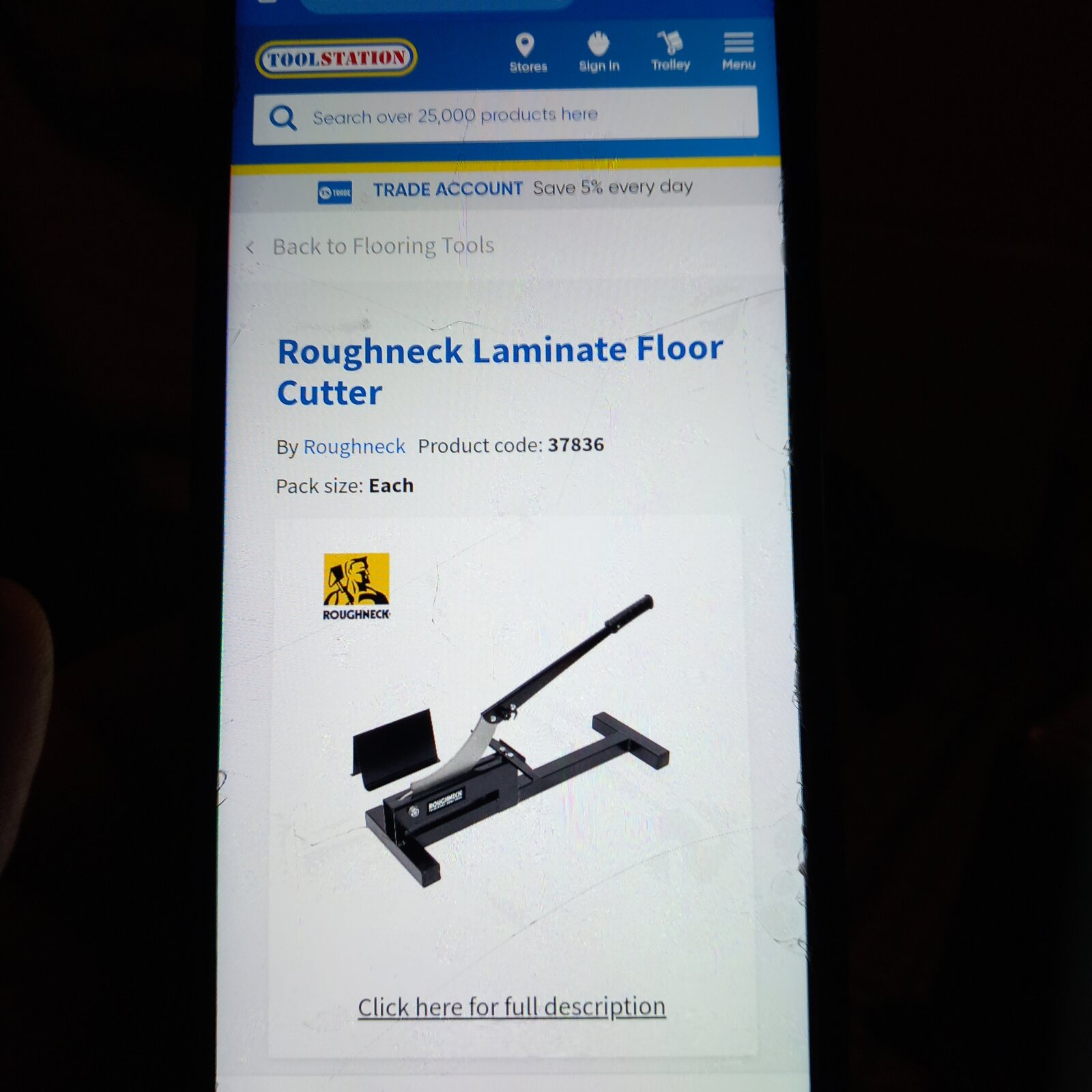

Use a guillotine for all cuts that will be hidden (99%); no dust and very quick.
For the 1% visible cuts, use a mitre saw with a new blade with at least 48 teeth.
Lightly score the visible face first and then cut fully.
For scribing around door frames, use a dedicated good quality jigsaw blade, although I have used bosch wood blades and they don't chip anything.
But as mentioned, 99% if not 100% of the cuts should be hidden.
Not rocket science.

Forgot to mention: if you weight less than 200lb/90kg, you'll struggle with the guillotine.
Get someone heavy to do the cuts for you.
I have never used a flooring guillotine. That particular model (and style of model) does have some pretty poor reviews with regards to the quality of cut though.
To be fair, it is at least six times cheaper than trade model though.
