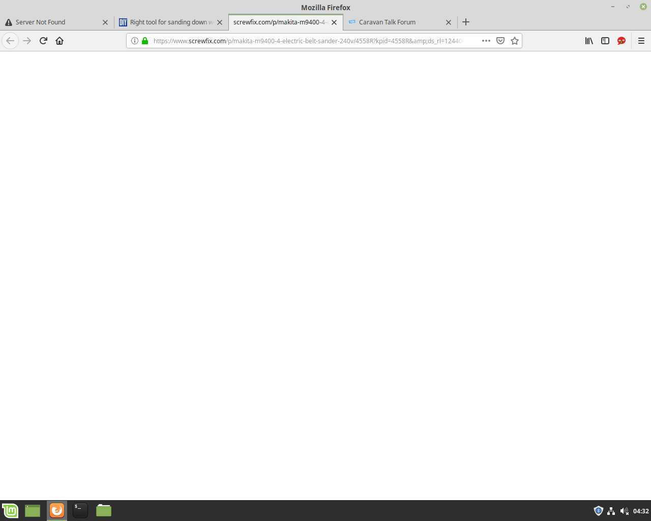

sorry but all the links from SF have been blocked from my browser and I dont go in there anyway
However I do do the others like tool station, travis perkins, jewsons
Makita mk9400, the red one. The blue industrial version is best but costs more.
