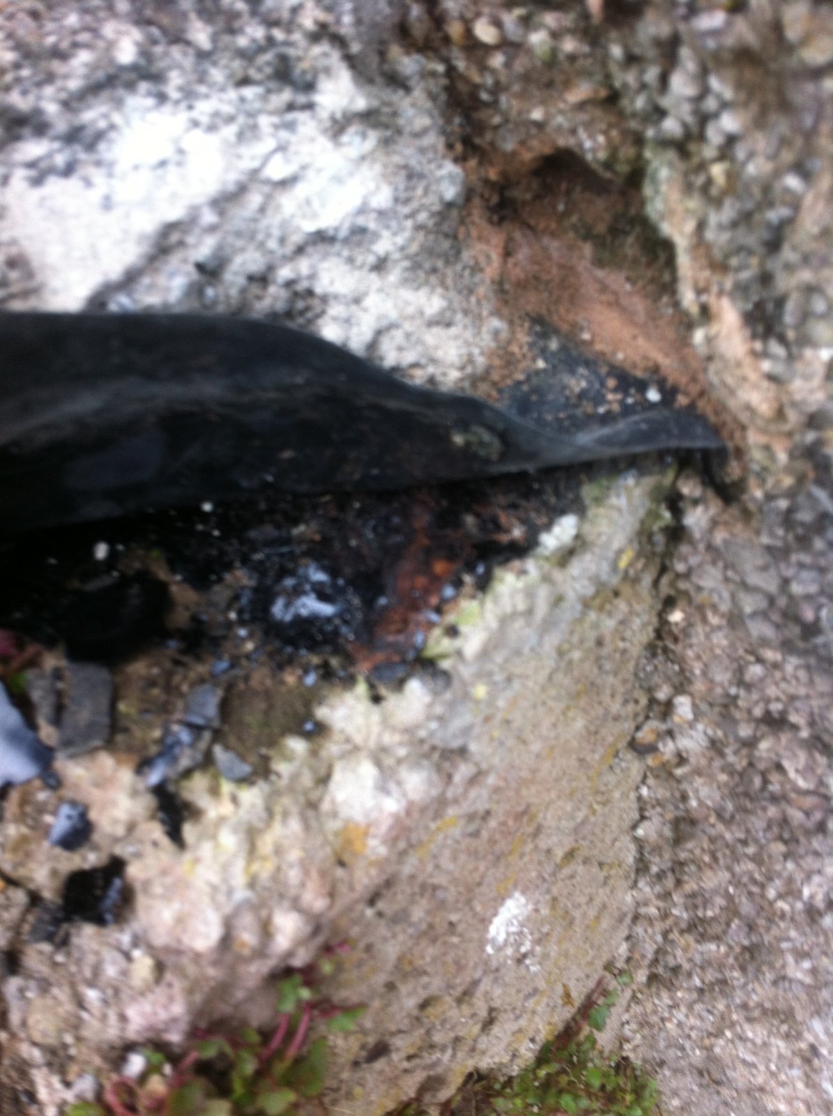

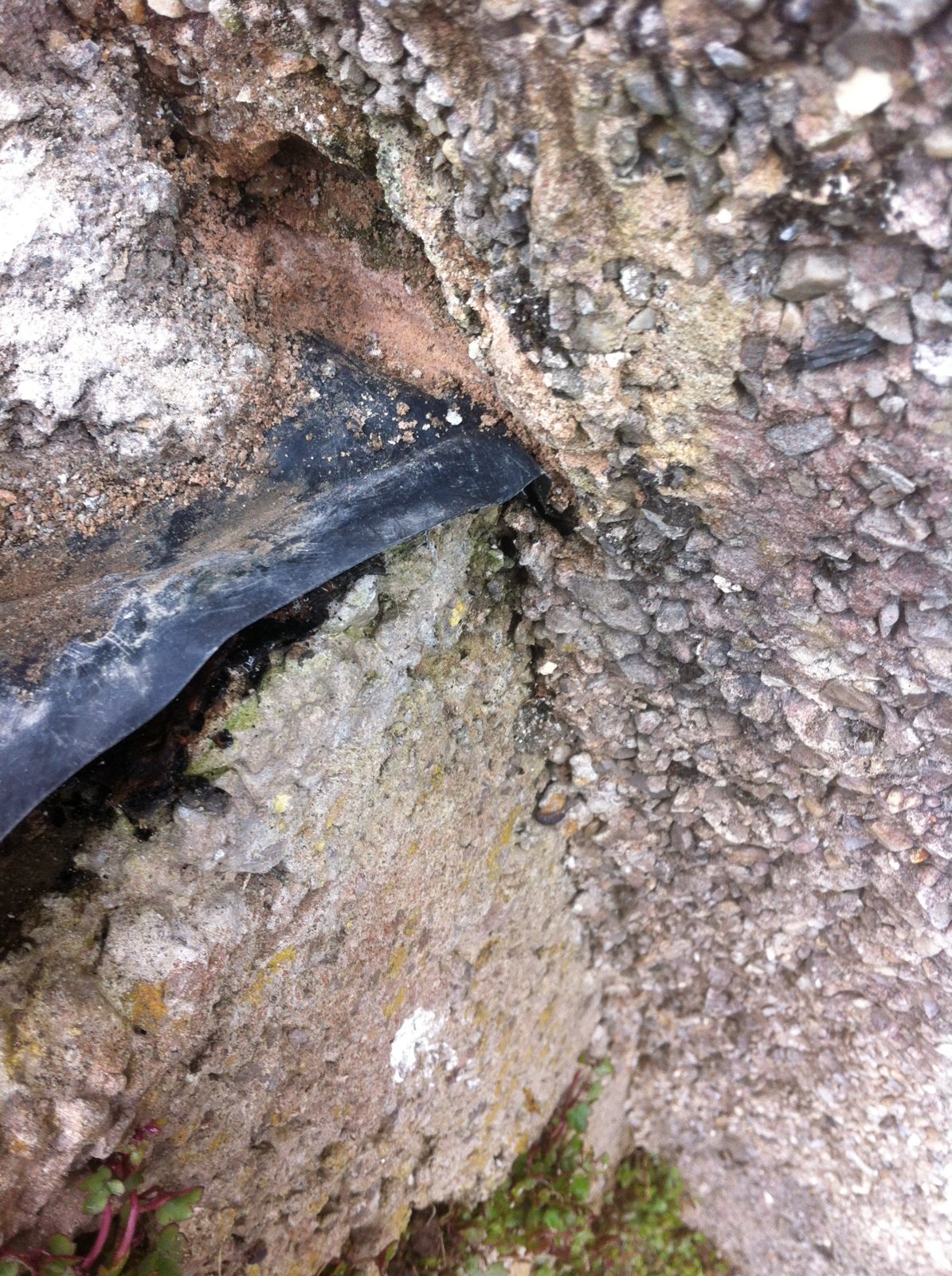

Ive hacked away at the exposed dpc to see how they've done it.
Seems like they put a membrane between the steps/raised paving, and the house wall.
But ruined it by concreting 4 inches over the top of the overlap?
I imagine that could be fixed by hacking out the 4" of concrete and laying a slot drain in its place?

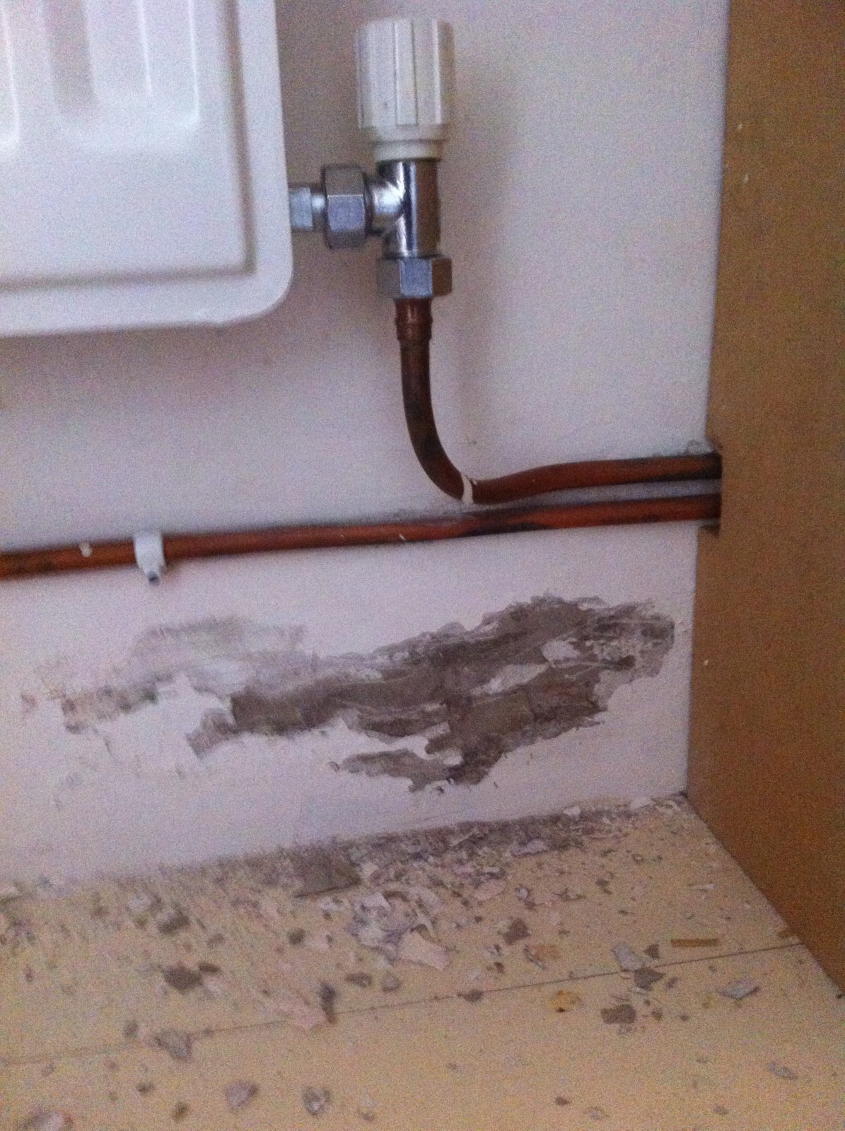

Now, its looking like the central heating!
Removed the piles of bedding etc from the airing cupboard, and the paint has blistered up just below the rad inlet.
This is the inside of the true outer wall, probably only a few inches undergound.
Plaster crumbly, meter reads 18% compared to 10% just above the pipe.
The rad. pipe has verdigris, and maybe feels damp, hard to tell for sure.

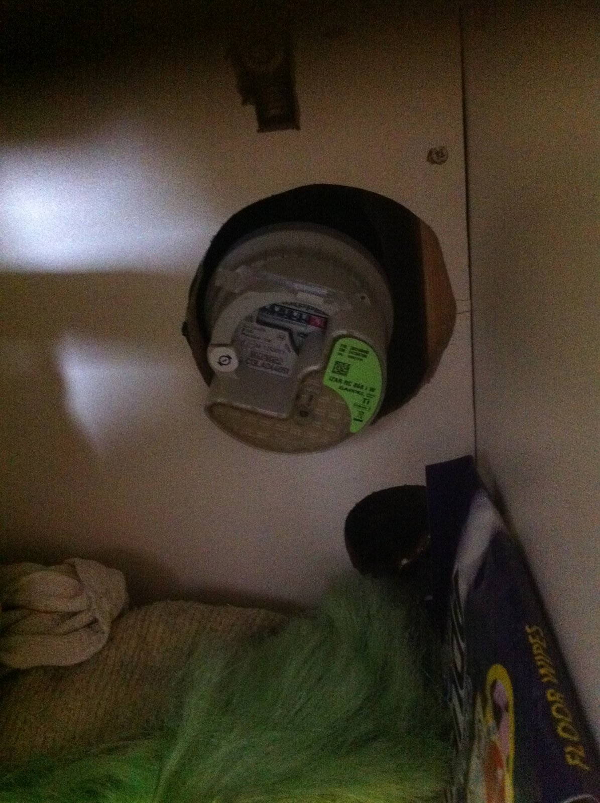

Yes, but it can only be a very slight leak. Check overnight?
You don't need to go by the digits reading.
Observe the top of the meter. It will most likely have a glass window. Rub it clean. Observe that there is an air bubble in it. All the time water is flowing, the bubble will turn.
You will need a torch, a rag or small paintbrush, and possibly a ladle or plastic mug if the meter pit is filled with water.
Hmm, I'm in UK, not the States
This is a picture of our meter
The green thing is on the cupboard floor.
The meter is facing out from the back wall of the cupboard.
The face of the meter can be rotated to any way up you want.
