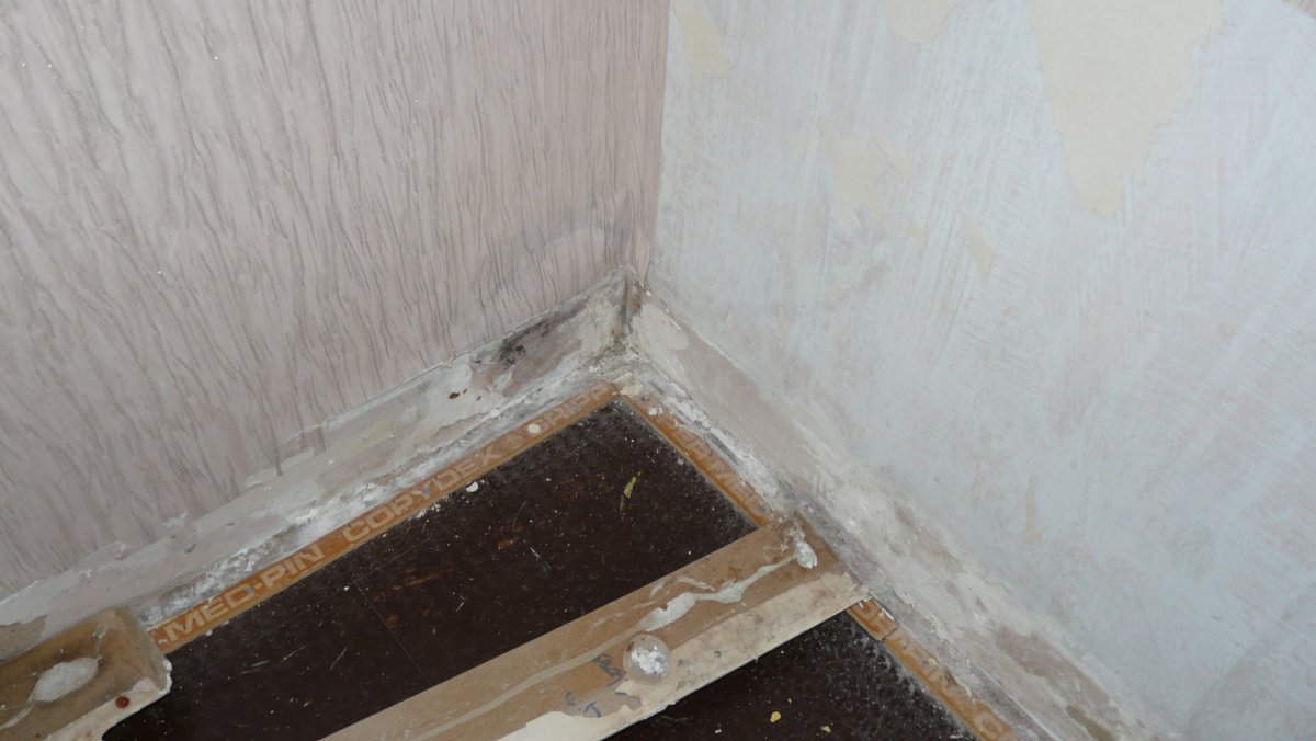

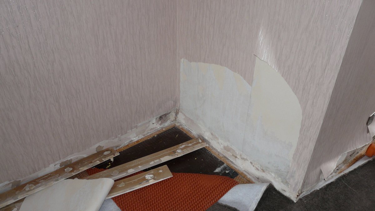

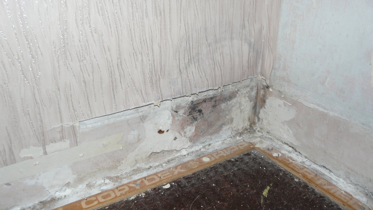

I've started decorating in my living room and notice that the skirting in the middle of one of the internal walls has started to rot. The wallpaper peeled off really easily, and I could see faint water stains up to about a foot above the ground. The plaster seems sound.
I've had one guy in to give a quote. He pointed out a pale blue/green section of plaster on the wall and said this was a special treatment used for damp - so the people who lived here before me must have had problems in the past and had had work done.
He also reckoned that this blue/green plaster stuff wasn't very effective. He quoted me 1200 pounds for knocking all the plaster out up to about a metre (this section of wall is about 5 metres wide) and redoing it with some special anti-damp stuff (I didn't really understand how this is different to the bluey green plaster that was already there, but he reckoned it would be a much more effective solution).
I'm waiting on some other quotes, but thought I'd best read up so I know what the next bloke who comes to give a quote is talking about ... but now I'm even more confused.
I read that the rising damp could be if something (eg plaster) was breaching the damp proof course ... but do internal walls have DPC? I thought it was just external walls?
If the plaster is sound, does it really all need to be taken our and re-done? It's definitely not crumbling away.
What's the best way to treat something like this? I've been reading about putting damp proofing membrane on that part of the concrete floor, with about an inch going up the side of the wall. I've also read about some sort of anti-damp sealant that you put along near the bottom to stop the damping rising any further up.
Any help please?

Thank you so much for answering. Here's some photos.
It's a 1960s semi, no no water metre.
My hall and kitchen are on the other side of the wall. I've checked them, but no sign of damp. I don't *think* there are any heating pipes in that bit of wall (I tried working out by following where the radiators go). Not sure if there's any chance of there being pipes in/under the concrete floor?

Did the damp man suggest the cause of your damp and its history?

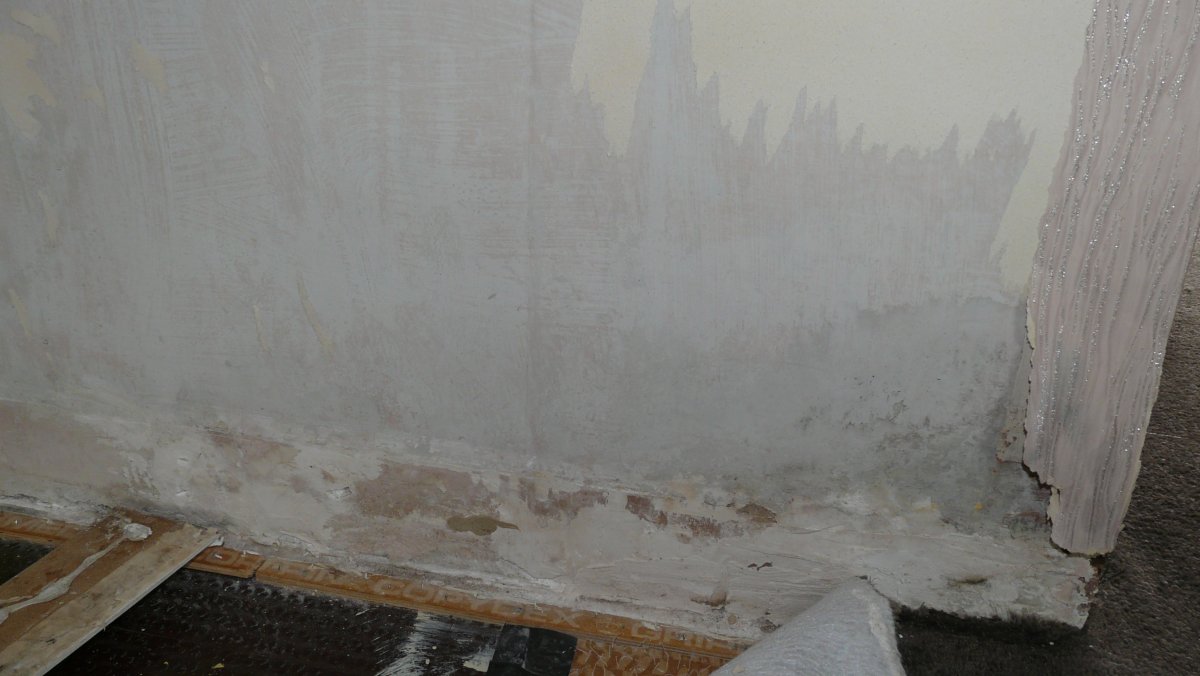

Your pics show signs of damp on two walls.
The skirting and the plaster do suggest that previous remedial repairs have taken place.
You should remove the plaster back to masonry to a height of 1m along both walls.
Re-plaster with a render mix of 3:1 sand & lime.
Break render contact 50mm above the floor.
Post close-up pics at the skirting levels on the other side of the walls in the kitchen and hall.

You might have a physical DPC thats been bridged by the old plaster.
But I think your problems stem from rising damp coming up at the edge of the concrete slab.
The S&L render will give you 20yrs trouble free from damp signs to the decorative finish.

Another man came to give a quote and reckoned 500 for the same work - knock the plaster out up to 1 metre, put in an air membrane, plaster over, inject some DPC cream into the foot of the wall.
But then a third man took a look and said the problem was that the plaster was touching the ground, so bridging the DPC. He said I should just chisel out the plaster to leave an inch gap from the ground and the problem would be solved - the plaster higher up didn't need replacing because the damp was only quite mild.
So today I got my son to do that and I'm even more confused now. There's a layer of something black and rubbery. I thought it must be the damp proofing but my son thinks maybe its the remains of the black tiles that they have under the carpet. Either way it's crumbling out. I can also see bits of thin plastic sheeting poking out ... I wonder if the previous owners of the home had put this down to try to fix it on the cheap?
