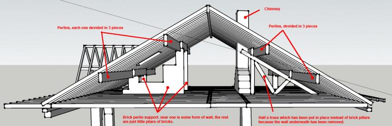

Hi,
I'm looking into the possibility to extend the loft with a (possibly two) dormers. The roof construction has 2 perlins each side (4 in total) each in 3 pieces supported by brick pillars (I know.... tell me about it). In the past, one wall has been removed which led to 1 brick pillar to be replaced by half a truss.
Just to give an idea, here is a drawing I've made:
Now... I have two questions:
1. In order to put the dormers in I will have to remove 2 pieces of one perlin (see drawing below). What might this do to the structural integrity? And what could I do to make it stronger (if necessary).
2. How would I support the dormer. On the perlins (and leave a stomp of the perlin that will be removed)? This gives the benefit that there is still room for a line (or two) of slate at the edge of it. Or on the inner gable wall? Stronger but less space at the edge?!? See this drawing where I've made a cut out of the roof where the dormer could be placed.
Any suggestions are very welcome.
Your first drawing shows the purlins (note spelling) set into the gables, I'll assume that's right. So bye cutting through these you have to be aware that their load bearing will alter, thereby requiring you to make good that support as you progress.
As far as "should the dormer be fixed to the remaining purlin" in one way or another it will be.
The bottom edge of the lowest purlin is the point where you drop a stub wall to the ceiling joists, making sure the studs line up with the rafters which will be removed to form the slap through the roof, also the two out-most rafters should be doubled up.

The dormer cheeks may be ok as they look as if they will get support from nearby masonry but if that low purlin is already maxed out then you may need additional support for the window elevation.
You'll need a ridge beam, and another beam to take the load from the dormer front - this one may also be the same beam to support the floor

Saying that, I would suggest that a new ridge beam would be in order, with effectively a new roof side incorporating rafters that are suitable to span the length without needing the additional purlin?
Additionally, the ceiling joists will not normally be suitable to carry the additional weight associated with turning a loft into habitable rooms. As such you will likely need new floor joists.

Yes, purlins (thank you for the correct spelling :oops:) are set in the gables. You can see them sticking out (just) from the outside. My rationale of being able to take that piece out is that at the moment that piece of purlin only supports that bit of the rafters (and tiles etc), so by taking that away it should be fine?!? But I have a suspicion that the forces on it are not that simple and might come from different angles as I think. Though the purlin consists of 3 pieces, they are nailed together and taking pieces out might make it viable to be pushed inwards by the roof?!? I think this will be ok with the half truss as this holds it on an angle anyway, but on the other side it just rests on a little pillar of bricks.
By "remaining" purlin I actually mean the little stump that's left in the wall. On my last drawing I've made the opening for the dormer slightly away from the gable wall (so I can still fit a column of tiles easily next to it), but the alternative would be to build the dormer on top of the gable wall (giving me a tad more space inside and is stronger?!?). Is this something that's done before or a no-no?
The drop wall to the ceiling joists idea is great, just what I need. Doubling the rafter up as well. I'll draw that in my next version. As for the drawing, they are indeed 3D in SU.
It's quite a big purlin which currently only supports that bit of roof. My gut feeling says it should carry quite a lot; but then again, I'm no expert. If it needs additional support, what would be the best approach? Would it be enough to have beams from the bottom of that purlin run to the floor joists (which will create the stud wall as described above)?
I'm not sure if I understand you correctly. It currently has a ridge beam, so your suggestion is to replace this with a stronger one so it can support the extra force? And the other beam, where would it run? I can't seem to picture this one I'm afraid.

As for the bigger rafters to support the missing purlin... I realise I might not have been clear enough. The middle purlin consists of 3 parts and I was thinking of only taking out the 2 side parts leaving the middle one supported by the half truss and brick pillar (maybe beef this pillar up??). That way I can take out (cut off) the rafters where there is no middle purlin for and all the remaining rafters will still have all purlins in place.
The ridge beam I can understand as that tends be be thinner since there's not much load on it normally. But by taking out (or seriously shortening) the rafters on one side, the rafters on the other side will push against it. Rather than replacing the rafter, would it be an option to reinforce it with an extra one which can then also be used to support the dormer roof?

It does not seem to have a ridge beam, rather it looks like a ridgeboard
The other beam will go wherever the front of the dormer will be
Also, you have no beams to hold the new floor
Have you researched roof spread and loading? You can't just cut a hole in a roof for a dormer
