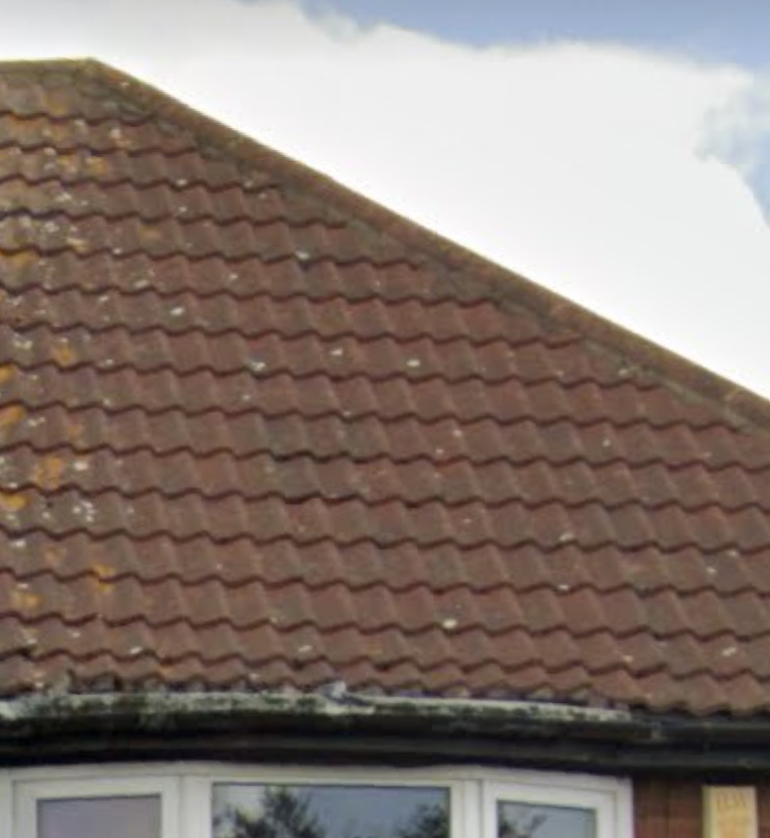

Hello.
Have just moved into a semi in York. Am looking to replace a roof tile to vent a bathroom extractor fan. Can anybody help me identify the kind of tile I have so as to get a good match on the venting tile that I use? Have attached a pic of the roof. Am hoping that this will be enough for an expert to go on!
If gutter is same age, check the make on that. There might be marks on the support brackets. Good chance both tiles and gutter are same brand. That was the case for me.
Klober do a vent tile with extract adaptor to suit the Redland and marley .. there are also universal units available
Easily available either merchants or online or message me and I'll sell you one we have lots
