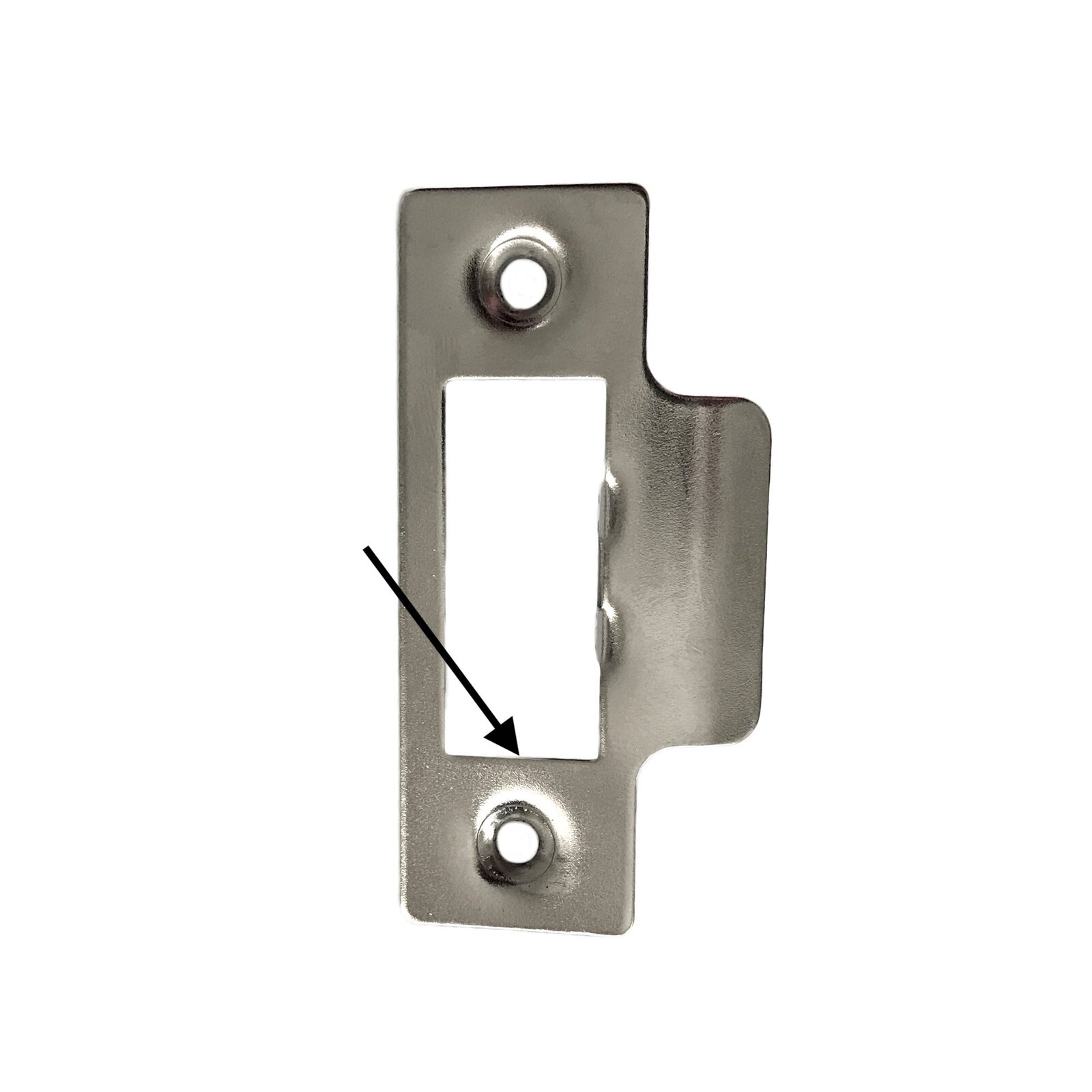

I have to file down the edge of some door strike plates. Is there a rotary/Dremel tool attachment that would be able to do this please? Thanks!

I'm trying to file down this edge, because the lock feature is curved and catches on it.

Thank you, I don't think using a scouring pad will work here and I can't seem to bend it, so filing it down is the only option.

The easiest way for this one is to buy a small flat file from Homebase or whatever, put the keep in a vice and the job will be done in minutes.
Using round rotary tools will give a lump in the corners.
If you have a vice of course! :LOL:
You don't need a vice, John you can file it in situ in the jamb.

Understood Burnerman, no vice though!
Filing in situ can be awkward depending on the depth of the recess cut in the frame, and how much metal you need to remove......
