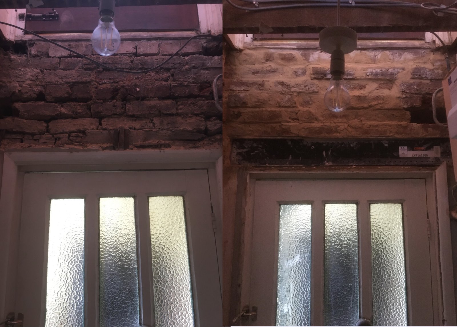

The second things is that I also discovered a rotten wooden lintel above the basement level floor. The two runs of bricks above it are also loose to the touch. This is an area where we’ve had damp problems and so I’m keen to safely replace the lintel but avoid creating damp with a concrete block or metal condensing moisture.
I’ve attached a picture of the basement door (with the lintel above) and the area where I removed a rotten joist (also above this door/ below ground floor entrance). Sorry, not sure how to orientate them the right way.

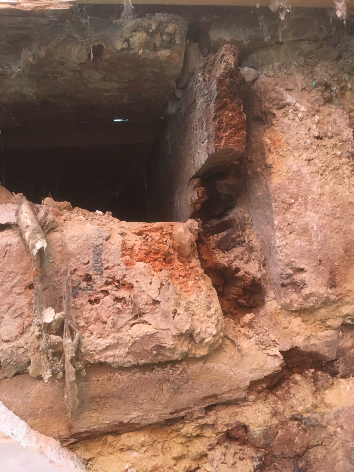

I had a closer look and discovered the joists rest on wood running horizontally on the bricks. Most of it is ok but the bit at the front (under the joists I need to replace) is rotten.
The other thing is that the wall the joist rests on (hall/sitting room) is only one brick thick so difficult to maintain 750mm on both. Should I look to widen the hole and overlap?

75mm, not 75 cm (=750mm)! A single course wall is 100mm (10cm) thick, therefore it is sufficient.
Rest the joist on the timber, no need for mortar.

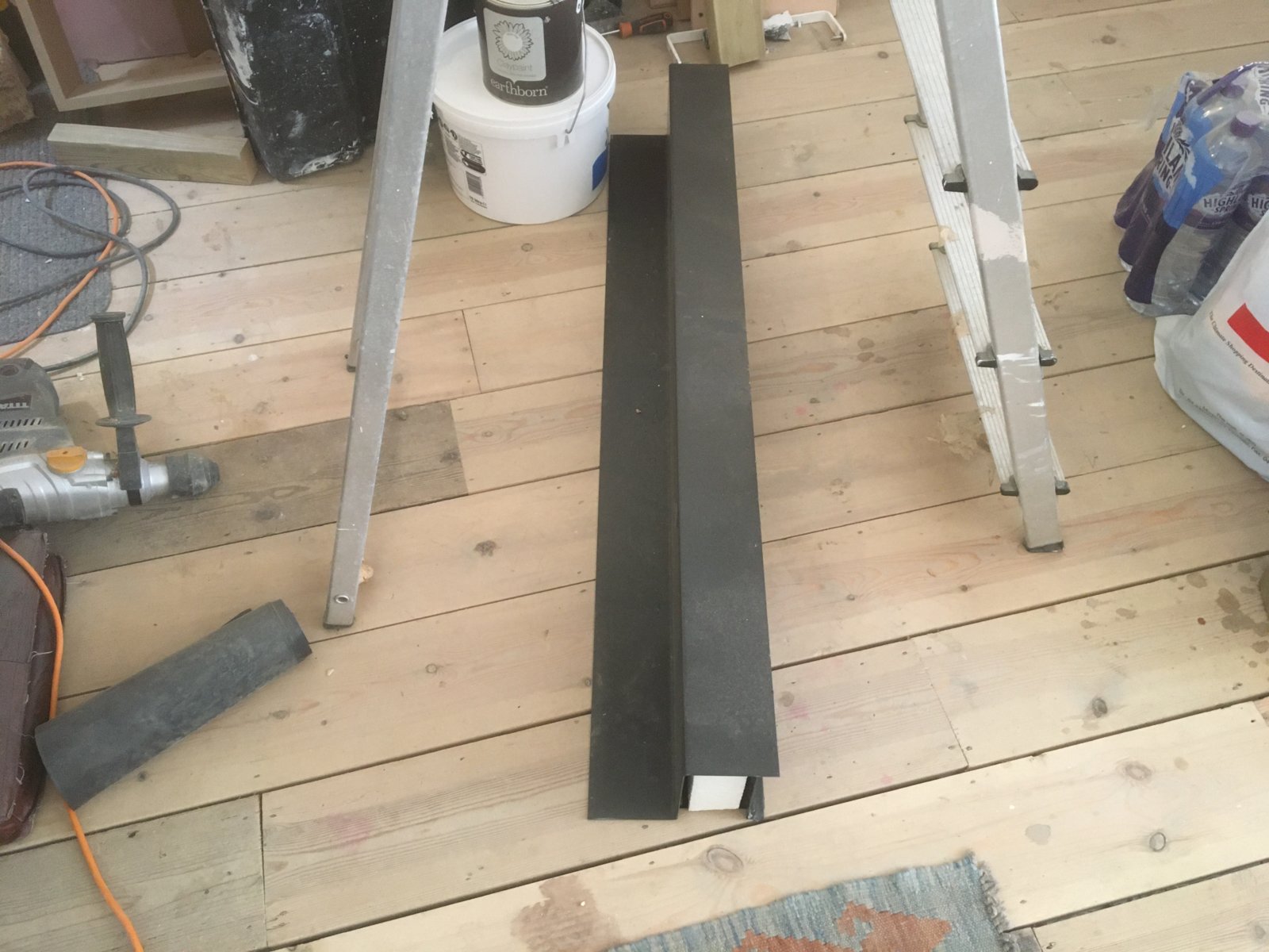

The builder’s merchants were unwilling to advise (due to company policy/liability) but I think this looks like the right sort of thing-
https://www.travisperkins.co.uk/ste...el-lintel-standard-duty-1200mm-cn71a/p/865798
At least it’s insulated and should help prevent or at least not contribute to some of the damp issues. If anyone has any thoughts on that, I’d be much obliged.
Many thanks,
Daniel
That looks like it'll do the job. Note the lip for the soldier course goes outside.

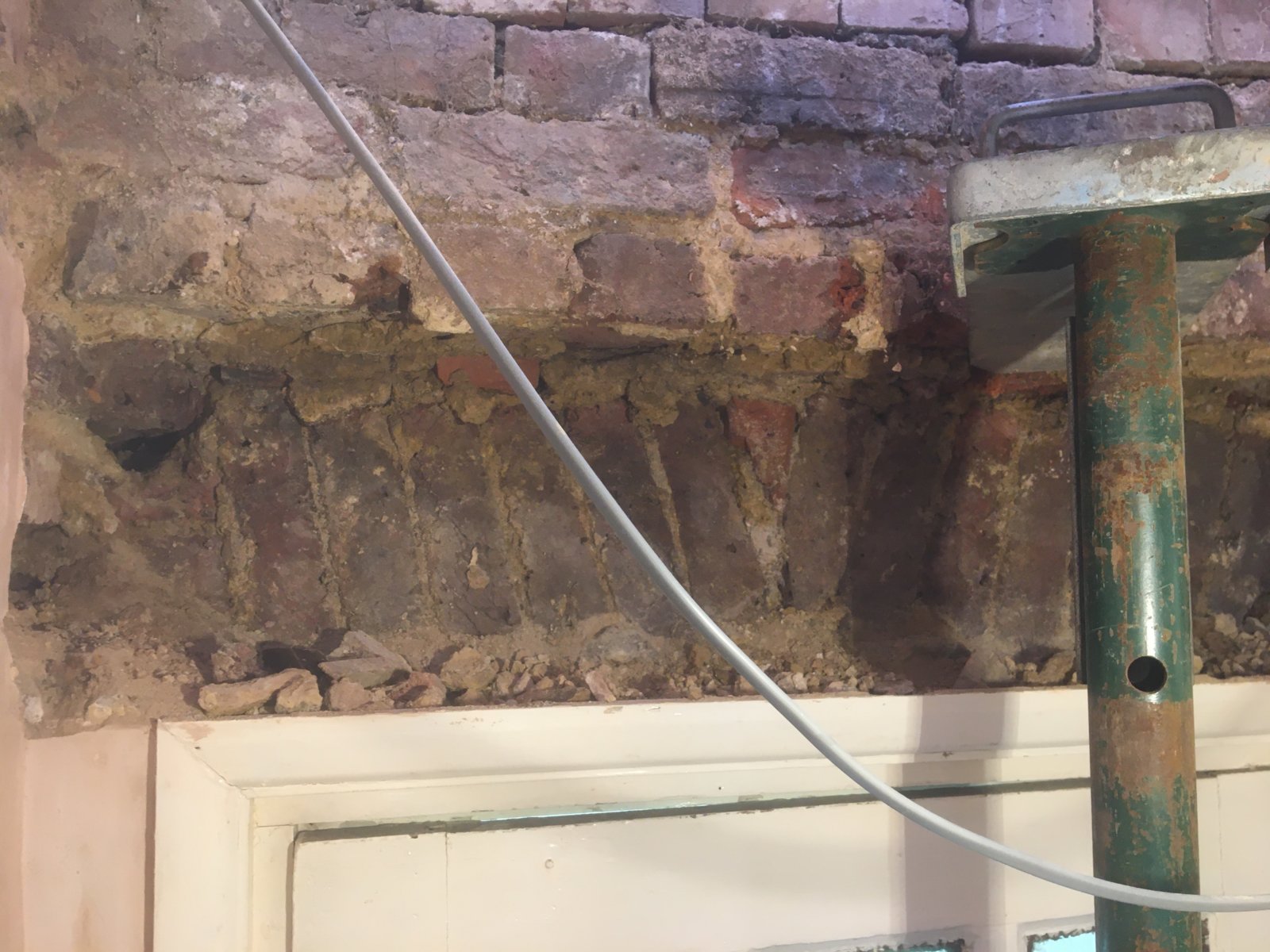

Hi Bobby,
I’ve got a support in and opened up a bit more. I can see there’s an arch brick support on the second row of the wall.
I’m wondering what I should do next? My uncertainty is about how I should get the lip on the back of the lintel in below the arch?
should I grind or drill out a channel and knock it in?
i don’t think I can just take the bricks out as there’s a gas pipe running along the front above the door!
should I just swap the lintel for a solid cuboid shape lintel, without the lip?
Any thoughts or advice welcomed.

If the arch is sound, you don't need a lintel for that skin.
Just swap the lintel for a single skin lintel for the inner skin.
Damn. I already started. I bolted some c16 to the outer wall and propped that with the strong boy for support. Have been drilling through under the arch... may as well carry on. Probably better to have this lintel in as it’s insulated. It’s just been a bit tricky!
Got there in the end. (The missing brick on the right is for where I’m going to re-route the water main). Thanks for all your help.
