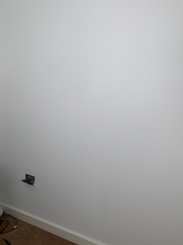

Here is my wall...
I have a stud detector, but it just doesn't work on this wall. The chap who came to quote knocked along the wall and found two partitions instantly. I just cannot differentiate between the noises when knocking.

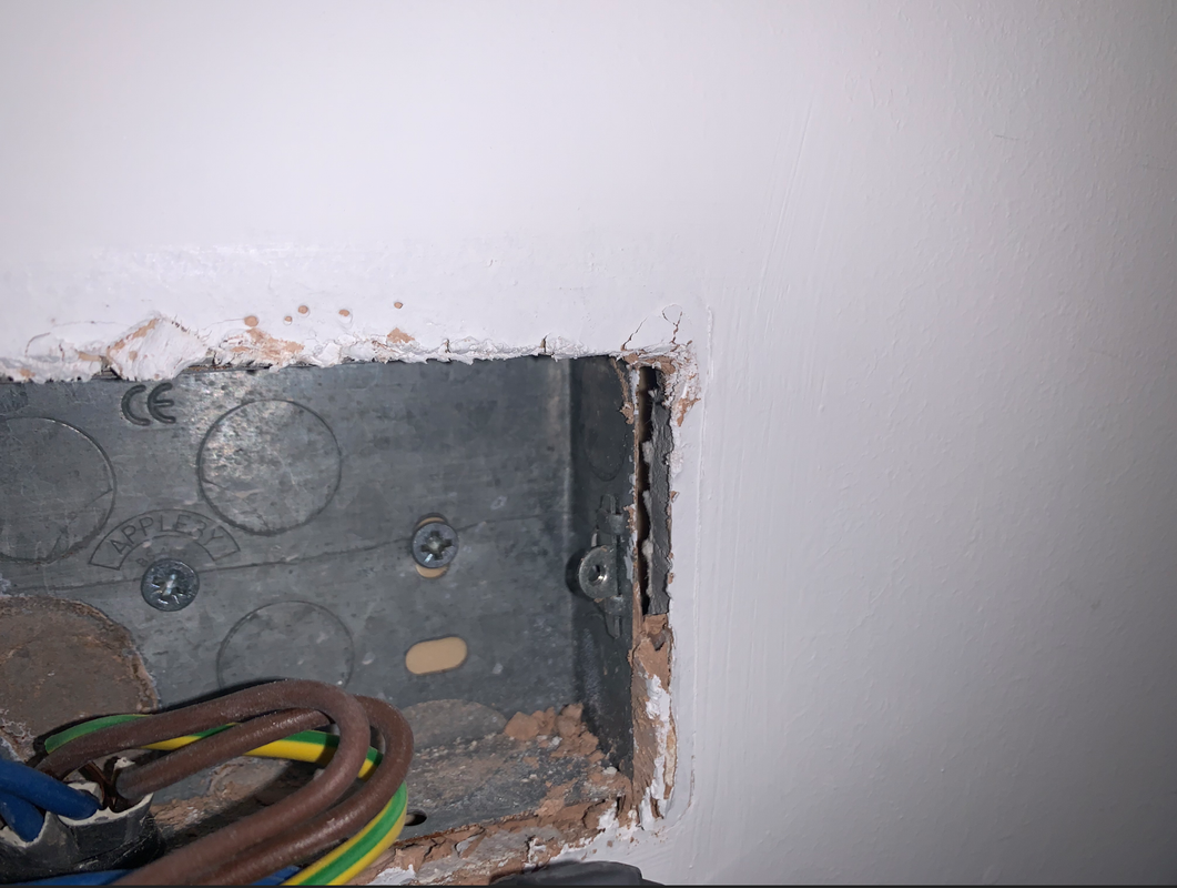

This is what the power plug and behind it looks like...
It looks like there is some wood behind the power socket but I an see that there is a gap behind the plasterboard and the next wall behind this room.
How am I going to work out where the stud is to drill into that? I could then use the grip it fixings for parts that the bracket would cover which are plasterboard.
Do you think this is deep enough a gap behind the plaster to do the brush plates and if so, can you recommend anything to fish the cables through with?
is there any timber to either side of the socket back box? if you can tap out the prepunched circles with a screwdriver(I know!!) and there is a space, using a straightened coathanger you can work out how far along the wall the stud is. same applies to the top of the box to see if there are any noggins. if you have a strong magnet passing that across the wall might find the nails or screws that fix the plasterboard to the studs as well
An update for you all. I got a company in who charged less. Still a lot but less money.
They managed to do everything but could not run a brush panel at plug socket level and one behind tv. The reason for this was because there is a horizontal length of timber behind the plaster running about 80cms up from the floor. Really annoying as the guy had already cut out the holes for the brush panel. He said the only way around it was to cut a hole where the timber runs, make a hole in the timber for the cables and then put the plaster back that was cut, plaster the gaps up and re-paint. I would be looking at a cost of £70-80 for that. Don't particularly want my walls hacked apart, so for now have run power down from loft, so the tv still looks like it floats.
He has put both brush panels in, even the one which does not have anything going to it, but he seems to have just screwed them straight into the plaster rather than put a backbox in. One has already come loose, which is not ideal. I am sure I have some self-tightening single backboxes in one of my storage boxes. If I get a knife or similar and make the square holes slightly bigger, could I push these in? It looks deep enough from what I can see to accommodate for a back box.
Overall, I am glad I got someone in as I would not have been able to do this myself. Particularly drilling down from the loft and fishing the cables in.
