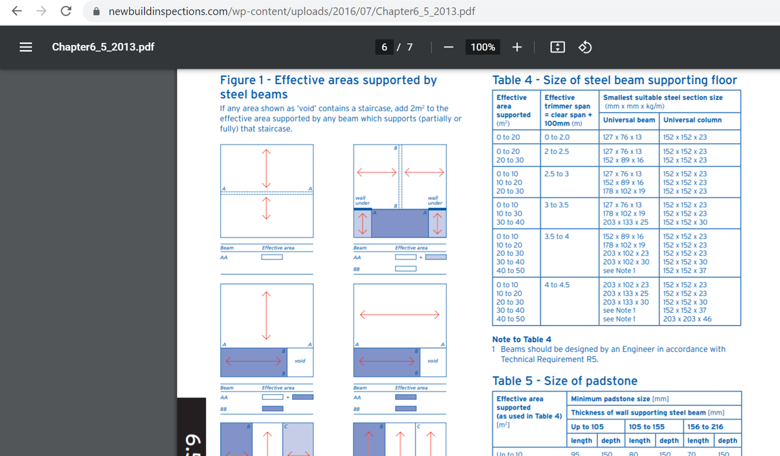

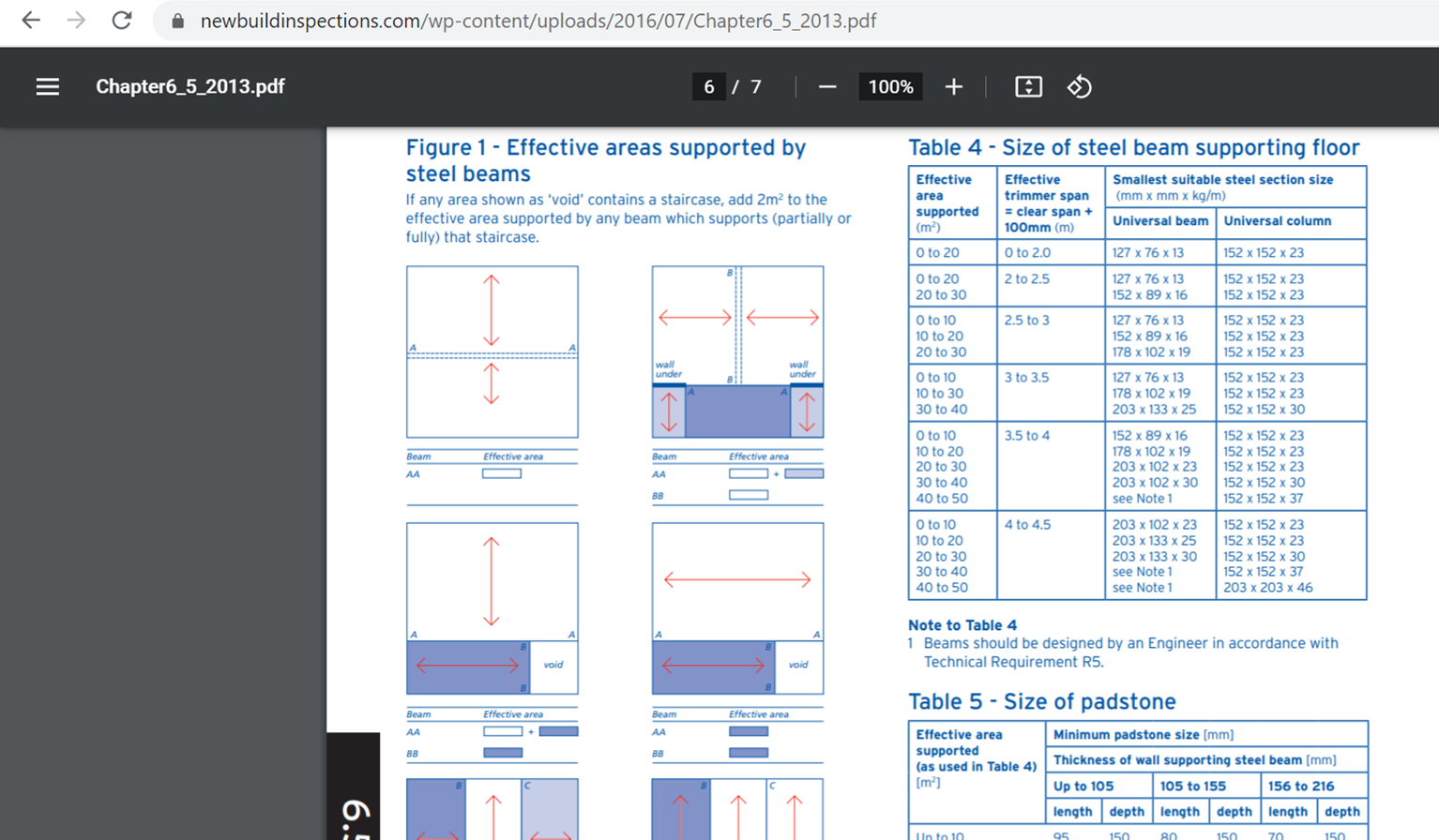

hi again all.. with regards to the structural post, i agree with the post being a 90x90 to fit comfortably in a stud.. so im going to change that.. also ive come across this table on one of the inspector websites..
https://www.newbuildinspections.com/wp-content/uploads/2016/07/Chapter6_5_2013.pdf
it does mention the 203x133x30kg UB, but also the 152x152x37kg.. the floor AREA its supporting is just under 40sqm at 39.95sqm, so am i right by saying the 152x152x37kg UC is more suitable or stronger should i say than the 203x133x30kg UB??

That table is OK so far as it goes, though it doesn't seem to allow for the load from any partitions which might be supported by the floor joists.
And your situation is different because your beam is 'continuous' in that it spans across two gaps. In fact, that makes for a lighter beam because the inevitable reverse bend over the support post helps to negate the downward bend mid-span. Because the spans are so different, there will actually be a slight uplift force at the outer end of the 1.9m span (assuming the load was uniformly spread along the whole length of the beam) but that would be countered by being built into the wall.
On those spans (assuming the beams are just carrying floor load) you could safely use either a 152 x 152 x 23 or a 203 x 102; both would be OK for stress and deflection.
good morning tony, there will be partitions on the floor, 3 bedrooms and a bathroom, a stairwell of approx 2mx2m is in the 6.6 x 6.6m square, taking away approx 4sqm of the floor area.. the stairs is supported freely on doubled up joists built in to the pine end wall and sitting on the ground floor partition, so this weight of stairs shouldn't come into the overall loads. do you think the 152x152x23 is still ok?
