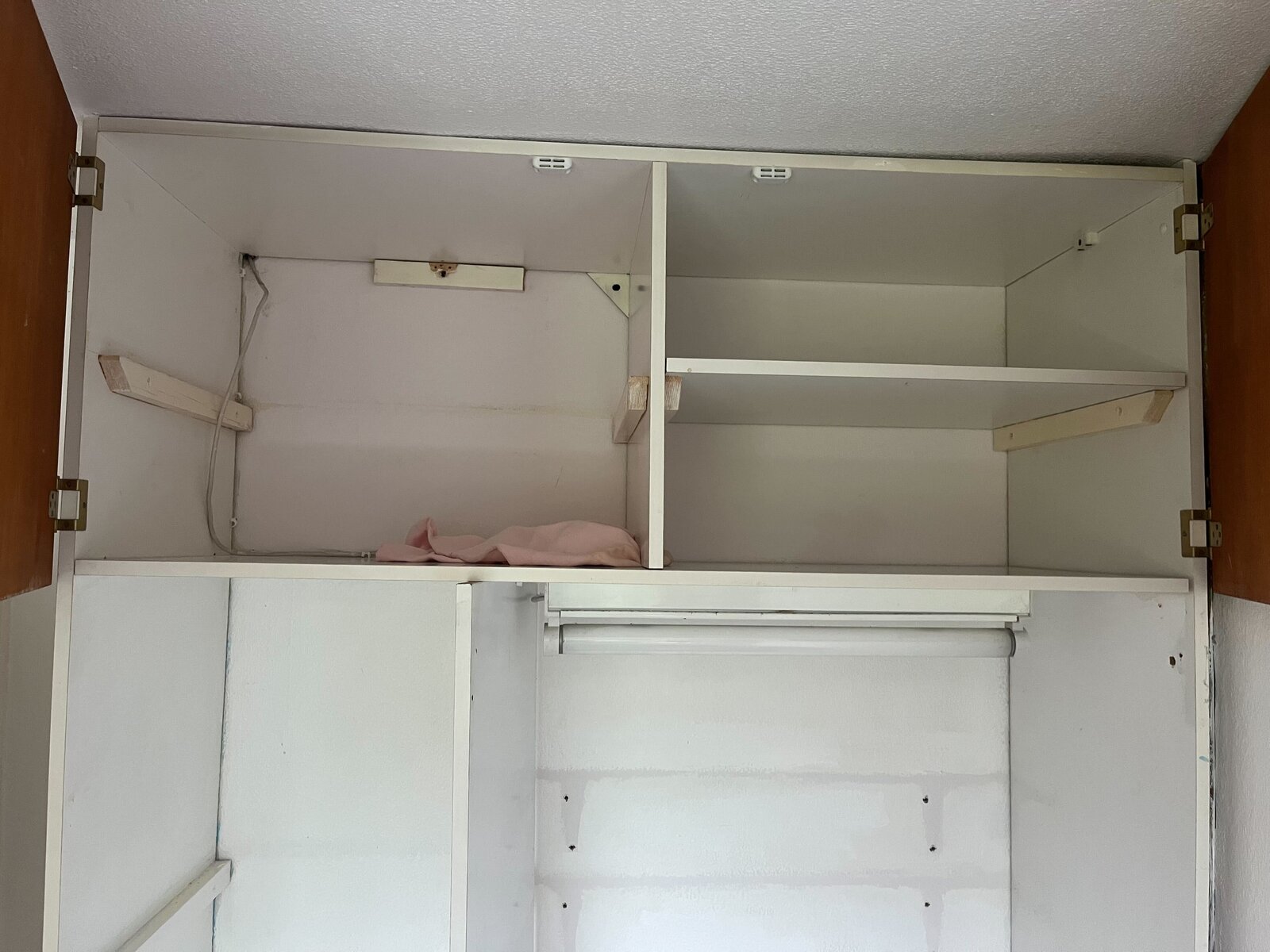

We're wanting to take down the wardrobe in the image attached, which would involve dismantling the light fixture. The light is powered by a wall switch. Rather than have this fixture dangling from the wall, I plan to dismantle the casing and cap off the wiring. This would be intended as a temporary solution before bringing in an electrician in a month or two for a batch of various jobs.

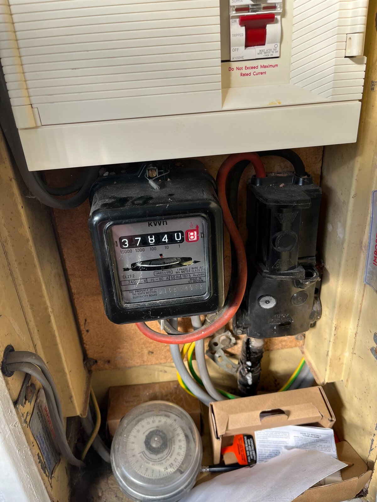

Show us a pic of your consumer unit, and the switch that controls that light fitting.

I won't be back at the property for a number of days so will have to get back to you on that for an image of the two. The consumer unit is a Memera 2000 RCD ... could well be this one (https://willrose-electrical.co.uk/p...a-double-pole-80a-rccb-memera-2000-a80he-new/) ... hopefully this old meter reading offers some clues also.
We do intend to upgrade to something more modern soon.

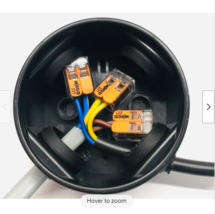

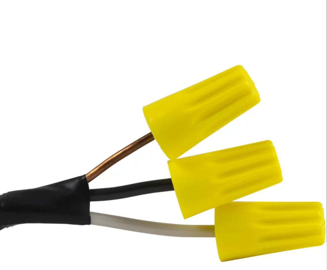

I'm likely poorly communicating my intentions here, I do not intend to use electrical tape to connect wire-to-wire but instead to isolate each wire so that there is no risk of wires being exposed to each other. Similar to the first image -- though using electrical tape rather than US style wire nuts. I know this will cause a break in the ring, but would there be any negatives consequences of doing this? I can't actually find any images for the *UK way* of doing this, so maybe this just isn't a done thing (?) I understand that doing this doesn't mean that these wires can be completely ignored as there could still potentially be a power supply to these wires -- just that they are contained safely.
I believe most suggestions have been to "complete" that ring using connectors as in the second image. I believe I understand this would be the best bet to make sure other fixtures work in the room, however I'm not used to recutting wires to expose the correct amount of tubing in the connector -- which I imagine could be a risk in itself if I do a shoddy job.

Thanks, it should be using the upstairs lighting circuit -- I was confusing terminology there -- though I shouldn't make any assumptions. I imagine if this is the case then each light fixture should be connected to a junction box/switch through a single light cable so that all I need to do is isolate the 3 exposed wires at the end of that light cable (?)
It could be wired as a spur from a power circuit ,and the switch a switched FCU. ( Hence asking for a pic of the switch earlier)
It looks like the light fitting was an add on ,and it's anyone's guess as to what circuit it's on.
It appears that one cable only goes to the fitting ,in which case it should be a simple disconnection ,and safe termination of conductors into wagos and enclosure.
