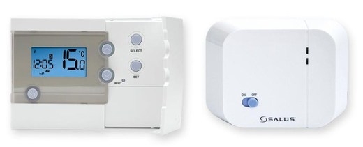

Looking at this thread as trying to 'fix' my thermostat also. Box is constantly showing LO temp and flame always on in bottom corner. Got a red and green light on receiver with boiler but don't understand why heating is always on, house is like a sauna! Can anyone help?
1) First of all, are you sure you have a Salus RT500RF as shown below.
The reason I ask is because I can't recall ever seeing 'LO temp' showing on a RT500RF thermostat. If yours is, then:
2) have you followed the reset procedure carefully as outlined in my post above, so as not to miss anything?
3) One of your neighbours may have the same thermostat and it may be switching on your receiver. Try changing the RF address code setting. Details can be found on page 9 here.

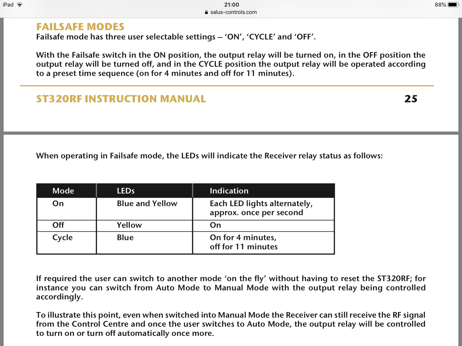

Hello,
I have an issue with my Salus thermostat (model ST320RF). All of the sudden, the lights on the main have gone blue and red (dimmed) and the heating stopped working. I have to mention that we had to turn off the electricity a few times today, I am not sure if this had an impact on it? Any ideas what the problem could be, please? It starts to get cold in the house and the Salus support team are not in until Monday. Thank you!
Hello,
Hello Oana, You have hi-jacked a 4 year old thread and would have been better starting your own, however, it could be in fail-safe mode?
Hi! Thank you for your reply! Sorry, I am new here. I have looked at your attachment, but it's not that. The lights on the receiver are solid blue and red and they won't change no matter in what position the switches are. We've tried everything, the lights will not change. Not even after resetting or turning the power off. Just cannot understand what happened?! :( Thanks!
