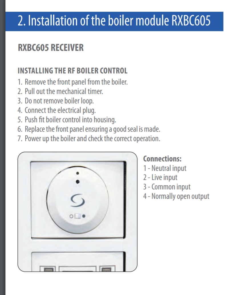

Salus RXWBC605 receiver compatibility
Hello, I’m not familiar with this boiler, might I suggest contacting Salus or Worcester Bosch for confirmation?
Thanks,
Yes, it replaces your programmer. The stat is wireless so can be mounted anywhere.
https://salus-controls.com/files/iT500BM-Installer-Manual-V003.pdf
  • Thanks
Reactions: CBW
Thanks, since posting I've now heard back from both Salius and Worcester.
Salius say no (no explanation given).
Worcester say yes.
Having looked at all the documentation I can find online and the connections used by my existing programmer, I am inclined to believe Worcester.
