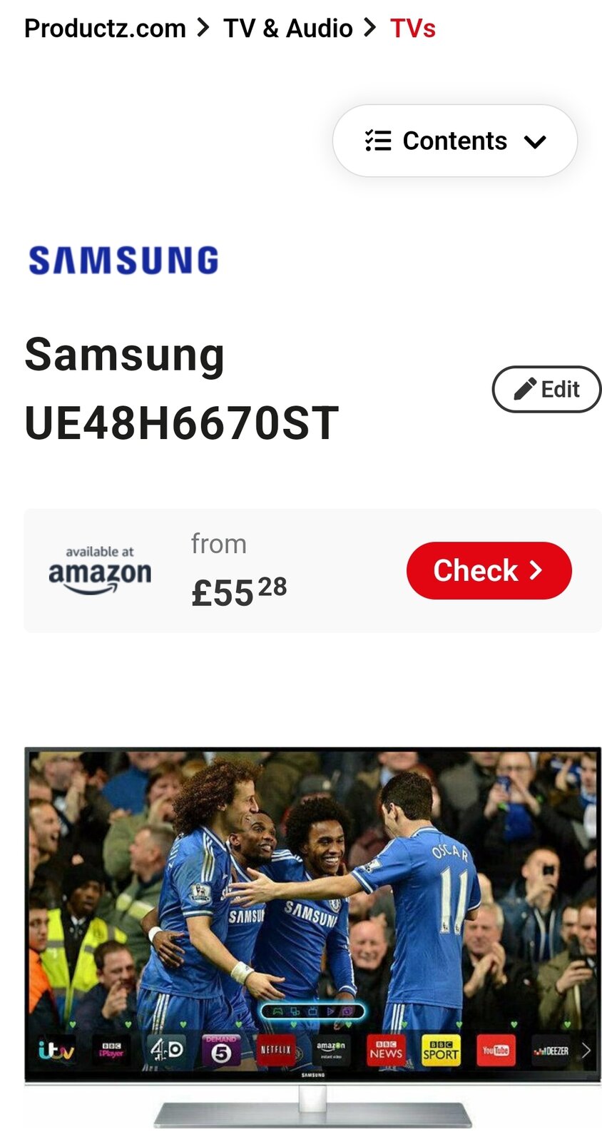

That 5 should be a letter S.
Try UE48H6670 as the product code.

Thanks for all reply's, I'm thinking I might give this model a swerve, after reading comments on forums, if I'm correct this is approx a 10 year old model,? and is 1920x1080, rather than 3840x2160 ? utlra HD?, which I think is better for normal TV watching?
