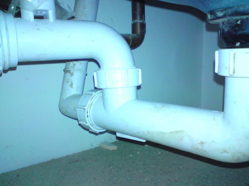

Hi there,
After inspecting our (new) bath/shower plumbing, as the usual shower consists of standing in 2 inches of water, this is what I discovered. (there were no blockages in the reachable parts)
Any comments weather this particular trap could be causing the slow drainage or could it be a level or combination of both problem, would be gratefully welcomed. (and suggested solutions :) )
Thanks for your time.
Harry
I'd second that, trap is perfect, looks to be insufficient/no fall on the waste pipe

I dont have my small level handy and bye eye it looks level and if not then more heading up hill, I enclosed this photo showing the run further down, 2 elbows, and heading down drastically. ( a gradual slope down would be better right?)

conects on horrizontal pipe, same as bath waste as in first pic,

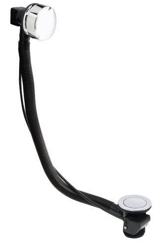

This shoes the overflow coming in
here It seems that the pipe is almost in line withe the bath plug, before it shoots off down!
Lowering this point is my only way to get things flowing right?? bit tricky though when boxed in with glued elbow joints....

does the bath drain quick when filled with water from taps ?
some showers are to powerful for a standard 40mm waste to run away quick and require different wastes.
fair point, it drains ok with a low pressured shower, but when cranked up not so good.
When there is a couple of inches of water in there, a quick plunge seems to get a good whirl pool drainage affect.
Do most these traps in-corporate a overflow connection, guess Im looking for a easy fit, to my limited access.

maybe you could change it for a p trap and it will lower the trap level.
but you'll have to change the bath waste to accomodate the overflow.
least you'll get rid of the two bends and maybe go straight to the horizontal pipe.
