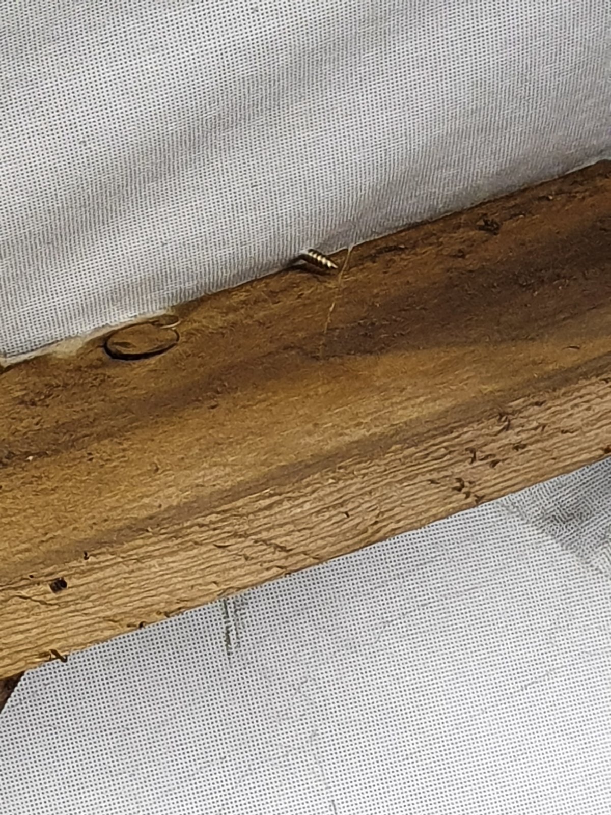

Hi,
I have had my ridge tiles converted from mortar to dry ridge.
I have since noticed in the attic that a screw which I think comes from the conversion has come through the felt (outside to inside) It hasn't tore it, just gone straight through.
Will this cause any future issues?
No , simply cut the tip of the screw off if you are worried you will catch it and hurt yourself
Thanks guys, after having another look it seems they have just missed the roof rafts with this screw.
I assume the rest of the screws will keep this in place ?
