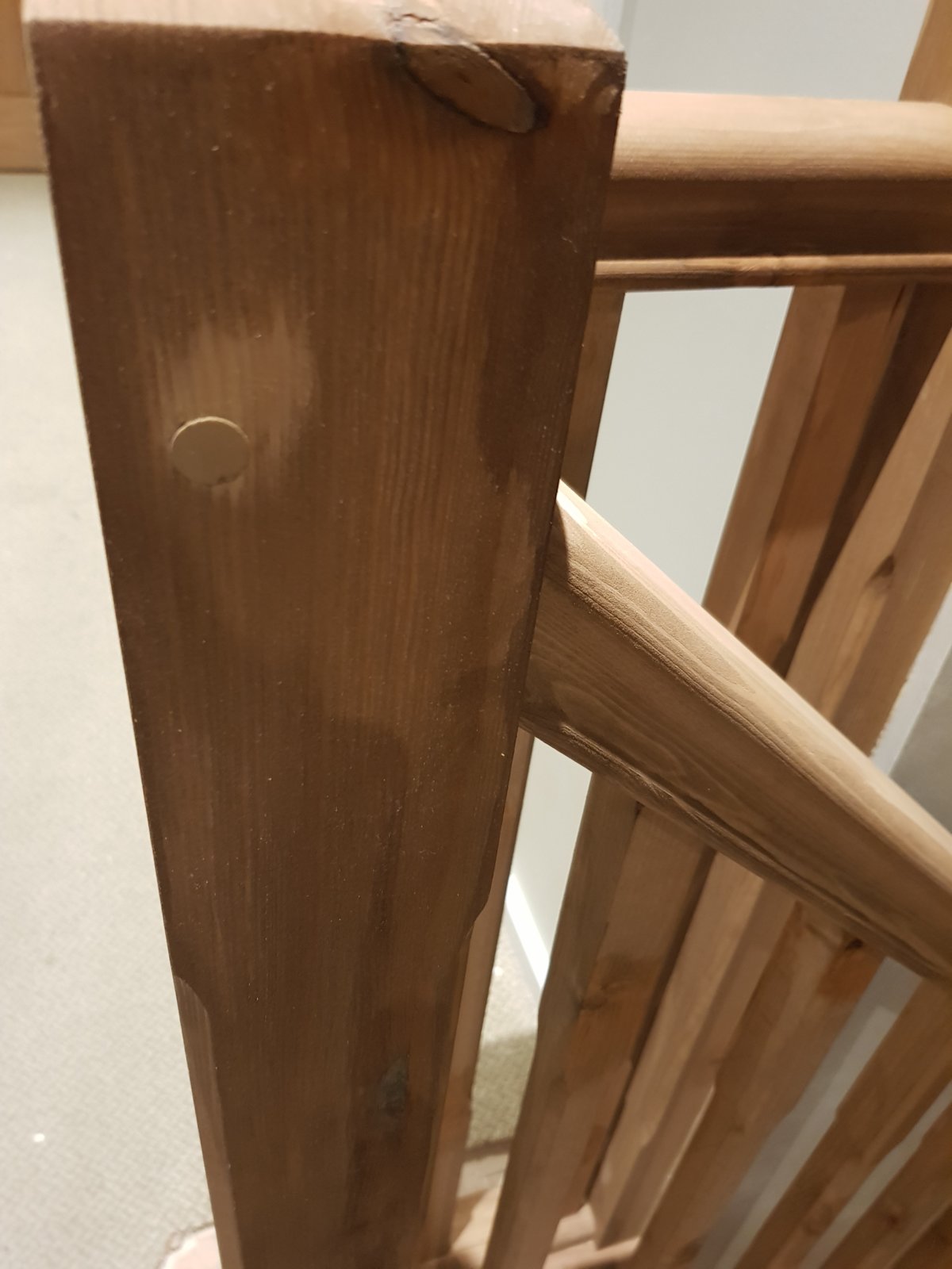

We had a new pine staircase fitted a while back and just got around to staining it.
Now on close inspection I can see that they have filled the screw holes with what looks like a plastic dowel filling. When staining over the wood and these dowels, the result is quite awful.
Any one have any good tips on how I can get around this? I am trying to avoid glossing the stairs as it would be a big shame (all our doors are wood - we had the old white ones removed).

Attached a picture showing one example.

Wood plug cutters are normally used to fill in screw holes out of the same material makes for a nicer job.

I think the final finish is what makes the job spot on attention to detail is one thing that really gets to me just like silicon around sanitary fittings its got to be right' you may still be able to do it wood plug cutters aren't too much to purchase' or take out the plastic plug'
cut some similar timber make plenty of sawdust mix th PVA into a paste fill the hole sand it should look ok.

if these plugs are glued in and any surplus glue oozing out has been smeared around the surrounding wood surface and not cleaned off properly , you'll get patchy colour when stain is applied (as glue repels the stain) and I'm guessing thats what you have got here looking at the image.

the amount required to glue a plug in is so small that that amount would be a big accident or very sloppy practices

Until or unless you try to stain it! Then you'll discover that a wood dust/glue mixture doesn't absorb stain at anywhere near the same rate as solid wood (and often looks ruddy awful IMHO). The only way is to cut solid wood pellets - and be prepared to make adjustments to the tone and colour when staining subsequently
a sharp chisel will sort that but did you even sand it before you applied stain
dab some dye or stain what ever you are using on the dowel a couple of times to darken its end grain so will absorb quicker than the rest
