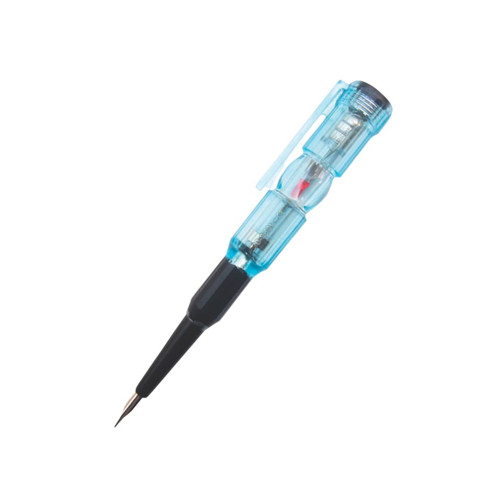

Screwdriver electrical current tester
Test screwdrivers are not regarded as safe or accurate circuit testers, not for the presence of power.

A neon screwdriver lights up when there is sufficient voltage between the conductor under test and the user. The voltage on the user is presumed to roughly earth potential with a sufficiently low impedance to conduct enough current to light the neon. Therefore when operating as expected the tester should light up when there is a significant voltage between the userconductor the screwdriver is in contact with and earth. The voltage on and impedance of the user is not necessarily well defined though, as it depends on stray capacitance. This can make neon screwdrivers unreliable, which has lead professional electricians in the UK to shun them.
In defense of neon screwdrivers though, they can do something which traditional multimeters and two pole testers can't and that is tell you when an entire enclosure and everything in it is live.
Normally the Neutral conductor of an electrical supply is connected to ground somewhere and the neutral conductors throughout the installation are close enough to earth potential that they are unlikely to light up a neon screwdriver. A neon screwdriver lighting up on a neutral wire on such a supply likely indicates a broken neutral conductor somewhere.
There exist supplies though that don't have a neutral, and there also exist plugs that are non-polarised, so the nominally neutral conductor in some situations, particularly those involving portable equipment, may actually be live, not because of any faults but just because of the nature of the supply.

Neon screwdrivers
will/do behave as Plugwash describes.
However LED screwdrivers
ae235
with a battery work at a much higher impedance and there is an extremely high chance they will light if you are touching the metal cap while testing on the neutral. Generally I avoid touching the metal cap and that way they behave more like the neon type.
Touching the top is for checking continuity.
Agreed.
But unfortunately I've never received instructions with any of the LED screwdrivers and assume others are in the same situation. Many automatically do it for voltage detection as that's what they did with their neon version.
