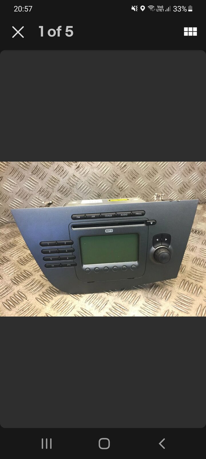

OK.. guys just an update..I think I found out what the problem was...it was the the standard car stereo draining the battery..I took it out and removed the power from it...2 weeks on so far so good..battery is fine car starts ok...just need to get a replacement stereo...
anywhere where i can get the radio code for a replacement stereo ?..gonna be the same type of unit..ta

Just an update...battery gone flat again.. ☹. Car is fine without stereo connected, put new stereo in battery gone flat..after a few days..
No just standard basic car radio..no cd player in boot...this one here..
