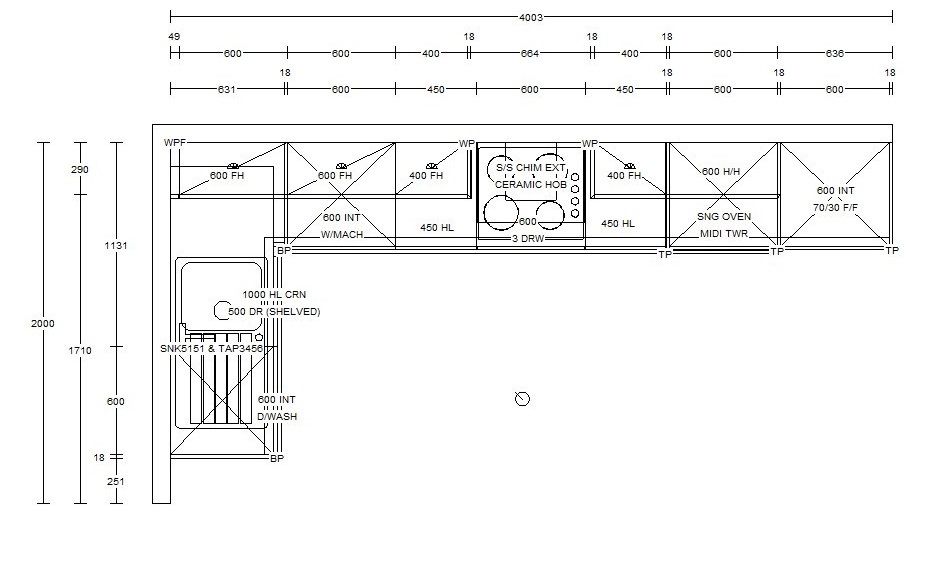

I am becoming a landlord (out of necessity, due to negative equity - needed to move).
To get the old place up to a rental standard, I need to replace the tired and well worn kitchen with something more modern.
I don't want to waste the entire renovation budget on the kitchen alone (property needs a complete new heating system & substantial overhaul), so I have been on the lookout for a second hand kitchen.

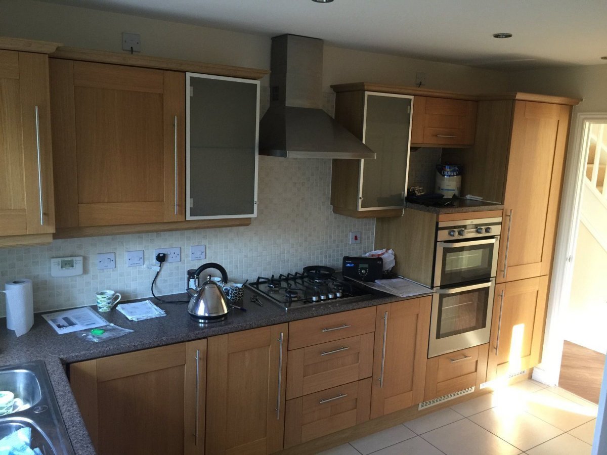

A friend has found one for me locally which I feel would be good (Pictures attached).
Due to differences in the kitchen shape, it would need to be installed differently in my property.
Here are major changes I can foresee at this moment.
  • Kitchen sink and overhead unit (currently next to sink) would have to be positioned at the other side of the kitchen.
  • Tall larder unit and oven would also have to swap sides.
  • The unit to the left of the oven would have to be removed due to my kitchen being a little smaller.
Does anyone have experience in this. Would this present any challenges that I may not have thought of? I don't want to jump in with both feet, then feel like I wished I hadn't. This kitchen is probably discontinued, so it would be difficult to find parts that match to make it fit.
I would get a professional in to do the install.
Any help or pointers would be much appreciated!!!

To be honest I've fitted several secondhand kitchens and really the units are just boxes whether they are new or old . There may be superfluous holes for pipes which are easily covered up with a bit of melamine board . Sometimes the shelves in the unit under the sink has been chopped about too and may need replacing. Again nothing that's going to cost the earth. The biggest problem can be the work tops as they tend to be less flexible unless sinks and hobs are in the same position in the new fitting. Answer there is either to get new work tops or put up with joints in seemingly random places.

Hi - thanks for your feedback. Actually, the worktops are the only thing not included, so that wouldn't be an issue. If you are in the trade, I would appreciate a guideline price for the installation of this kitchen (tech drawing and picture attached to my original post), the old kitchen will have been removed and walls skimmed for a blank canvass on which to install.

Actually, no. The 'new' kitchen is already dismantled. The person selling it is a kitchen fitter who agreed to sell the old one once he fitted a new one....I just have to pick it up...
I don't think I can get replacement doors, but could live with a smaller kitchen installation if this is still possible. There are pictures of the kitchen in the original post.

I'm a joiner rather than a kitchen fitter so probably not as quick as someone who does it all the time which is something to take into account and without seeing the actual job it's always going to be a rough idea of cost but personally I'd say three days work as an estimate. I tend to work on £120 per day so that makes it £360 but I tend to say to customers it could be longer , an extra day perhaps , as there may be unforeseen problems.
For instance on one kitchen I did the units left an odd sized gap so I ended up fabricating a sort of shelf come wine rack type of thing from a spare unit. Easy enough to do but it does take time.
The units are the easy bit, getting all the services in the right place is the key, are you up to plumbing and electrics?

I'd love a kitchen as nice as the one pictured.
