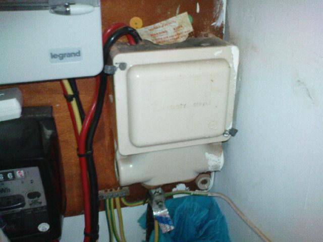

Some time ago, nPower came round to change the meter (not sure why, possibly just due to the age of it). The chap said he couldn't do it because of the type of our service head. We've changed to Southern Electric now, and nothing has been said about changing the meter since.
I've attatched a pic of the service head to see if anyone thinks that it should be changed - apologies for the quality but it's from my phone. Is this type of cutout still safe, or should we call someone to get it changed?
Cheers
Dan
There could possibly a fused neutral in the cut-out which DNOs are trying to eradicate. Also, although DNOs have some different rules, it is not good practice to attach an earth clamp to a cable sheath to obtain an earth (Although it is perfectly acceptable to use the sheath as the earth)
Try and speak to your network operator (ie those that maintain the electrical system in your area - not neccesarliy who you pay your bill to !)
The consensus is that cast iron / metal mains heads are past a sell by date.
Although different district network opperators (DNO's) have different views.
I'd chase it up, and ask for a meter change. You could always pull the DNO's leg a bit by suggesting the meter v a owl monitoring unit show a consistantly different reading. That should suggest that maybe the meter is running slow and is costing them.
There is a constant battle between meter operators and DNOs over this sort of situation.
That design is perfectly alright (known as a tin bath). Unfortunately meter operator staff for various reasons are not allowed to remove fuses from them or other metal-clad cut-outs.
It's worth talking to the DNO but they may already have been approached.
Our company rules state we are not allowed to remove the cover from this type of service head as it has a non hindged metal cover. The reason is that there have been a couple of instances where the meter op has pulled the top down and the bottom has slipped onto the live terminals inside the head. I will say that it is unlikly with this head but our code of practise say "NO".

A slow meter won't cost the DNO, it'll cost your supplier. Even if the DNO and supplier are in the same group (such as EDF), supplier and DNO remain separate companies with separate accounts.

But surely they will all need changing eventually - why charge someone else for changing an obselete product on your network that they are required to access but consider dangerous due to its obseleteness?
We do change them as time and the regulator allows us to expend the monies.
The problem is that some of them have a lot of life left in them but fall under the blanket "we don't touch metal clad cut-outs" ban of the MOPs.
There is one design of 3phase 200A cut-out that was still being installed until recently, investigation showed that the MOPs wanted them changed as they did not want to purchase the correct equipment to work on them.
