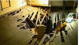

Thanks, that's interesting. The rooms above are a bathroom and also a "plant" room (boiler and invented cylinder). Might having such tightly fitted joists make it very difficult to plumb?
Oh...........
So not just a bedroom then?
If there's a wall between the 2 rooms above and it runs the right way you could possibly hide a timber beam in it to split the span, otherwise you could split the span with a small steel if a 100mm one was up to the job.
