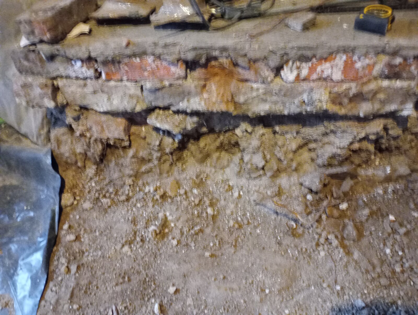

Comedy constructional hearth. Shame cos the tiles on top were in reasonable nick.

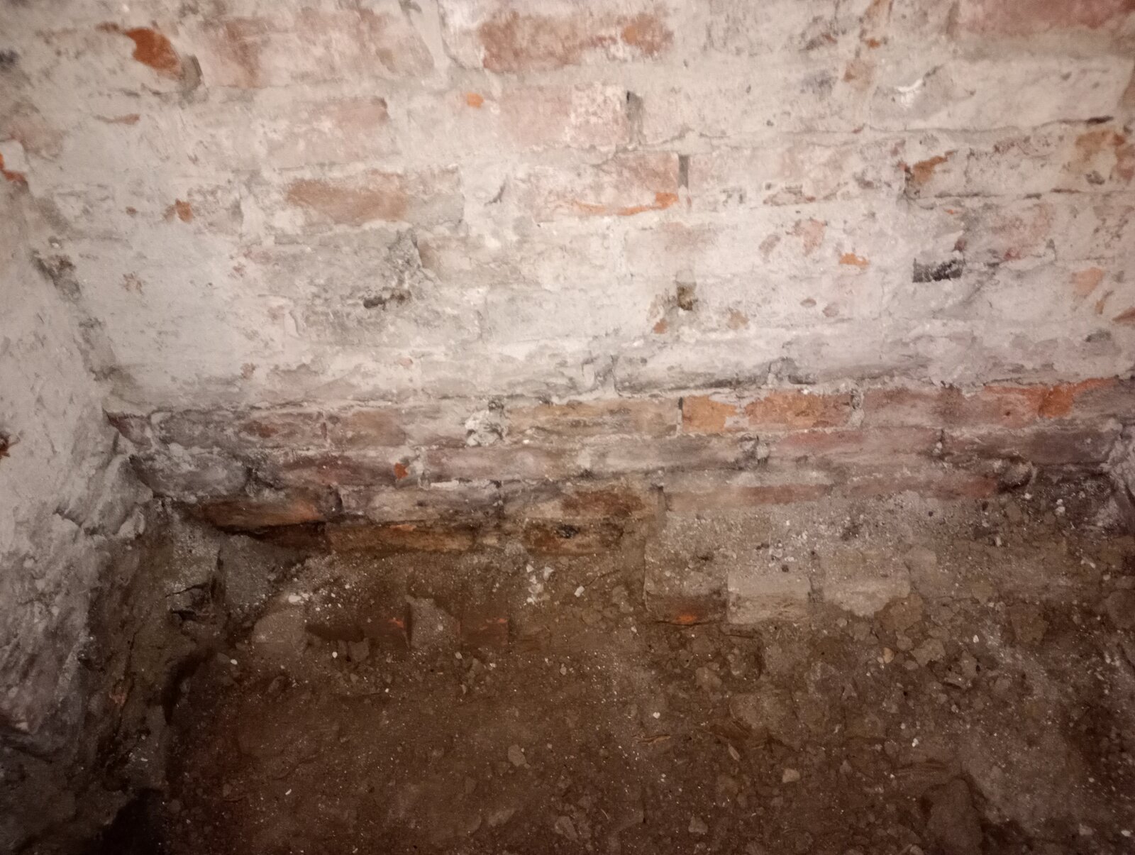

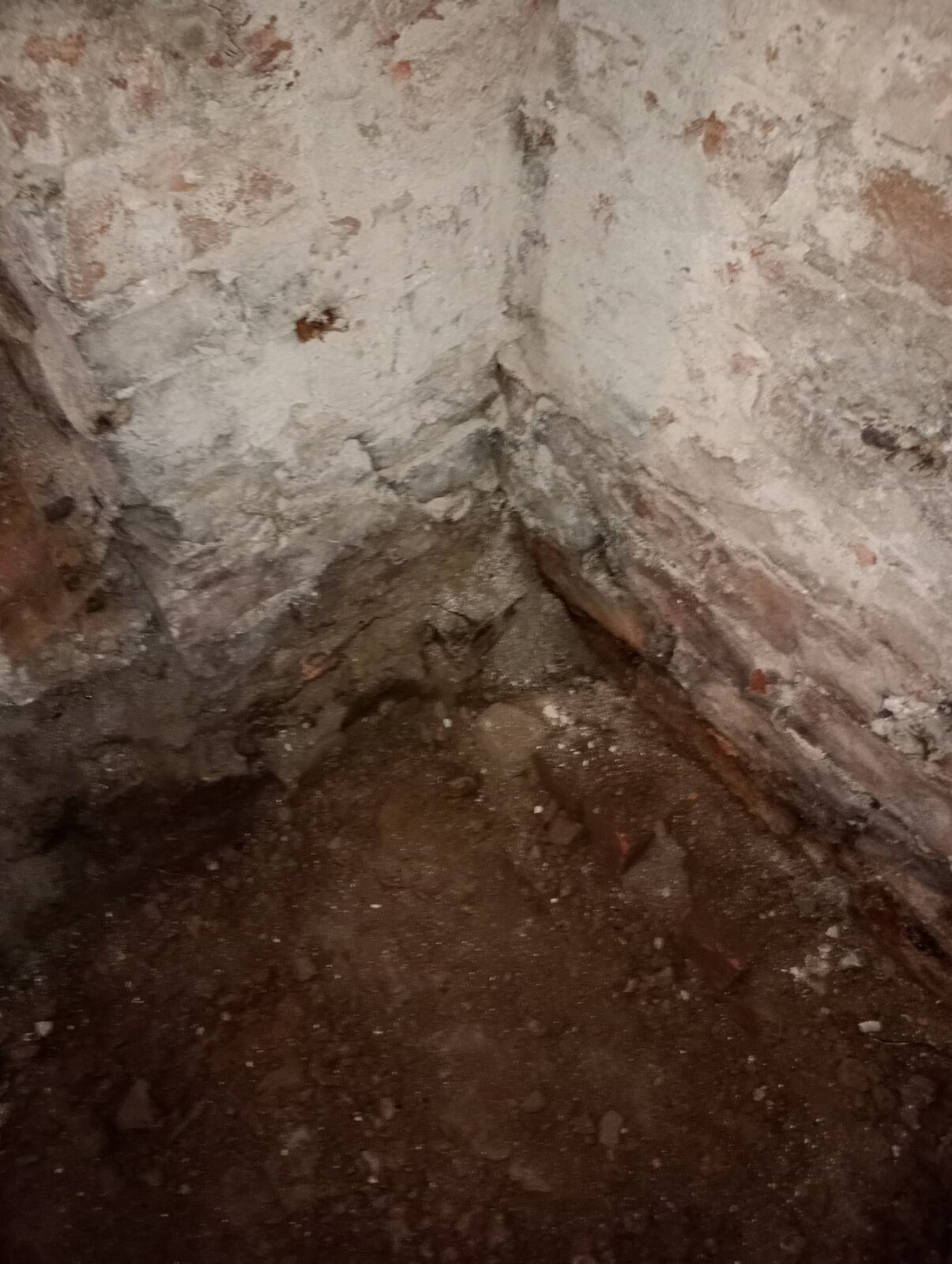

Chimney breast (on left) soldiers at about 450 below. Wall on right starts at about the same depth
But then comes up a course so soldier top now 350 ish below

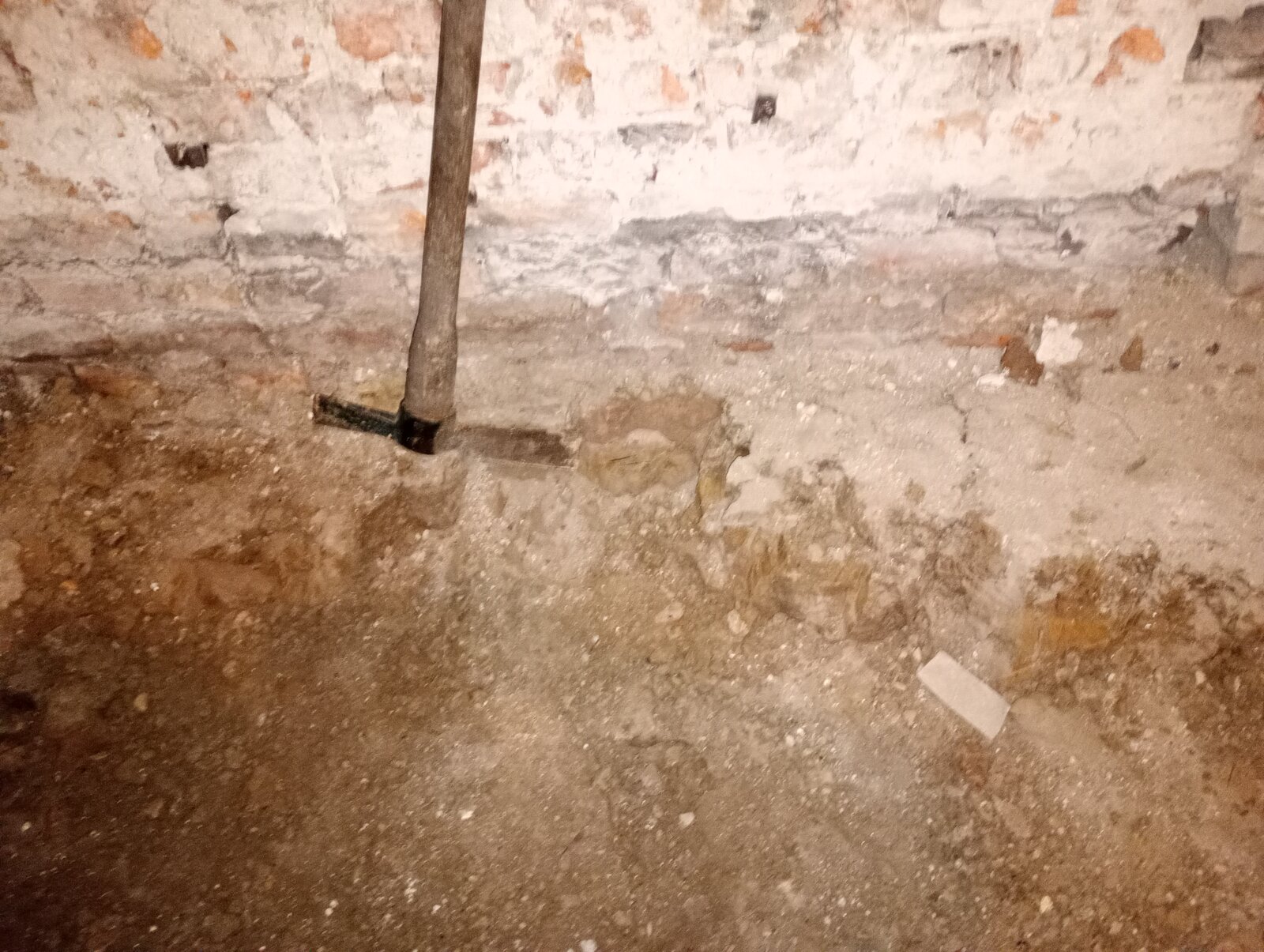

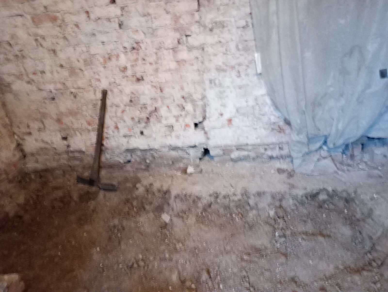

Spine wall- right hand end of mattock level with bottom of soldier at 350 ish below, top of soldier 280 ish.
Don't know what is under that strip of clay but i'm sure it won't be pretty. Leaving it well alone, possibly for ever, possibly til an hour before the concrete pour for floating or halfbreed floor.
