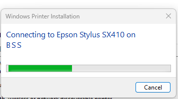

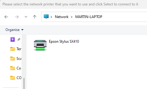

When I try to install the printer on my wife's laptop, I can see my laptop and select it, and I can also see the printer and select it.
But when I select 'next' I get the message:
I've restarted the printer spooler and checked that the network discovery is on, password protected sharing is off, and both laptop settings allow sharing but to no avail. I'm at a loss as to why since I set it up in July it's been working fine but has suddenly stopped without us changing anything.

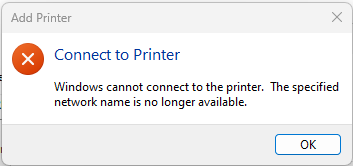

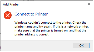

@RandomGrinch. I'd not thought of trying it the opposite way around. However, the same thing happened. I could see her laptop and also see and select the printer. It tried for a while.....
.....before giving a slightly different message.
@CBW. I had tried most of those with the exception of 'Nearby Sharing' and disabling the Firewall. So, I tried both, but unfortunately nothing changed.
