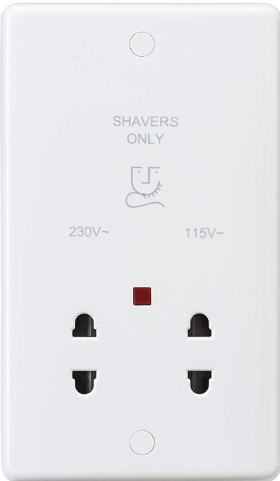

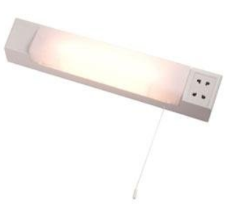

Hi, my shaver point is not working. I have checked power and there doesn't seem to be any. The bathroom fan and lights are ok. I have checked other bathrooms and they all work off one circuit (lights).any help would be greatly appreciated.
Some (most?) only work when the cover is fitted properly and/or the contacts become bent/worn.
Usual electrical things - loose/broken wire somewhere on the circuit?
Where exactly did you check the power and how?
It's a bit like saying "My car won't start". Any ideas.
Sounded pretty helpful to me.
I was only going to add by asking if it has two outlets as trying the 110v socket for example would eliminate a connector problem with the 230v socket. Definitely worth checking if you have power going in to the shaver point though, or if there is an FCU feeding it, possibly vertically up from the shaver socket.
