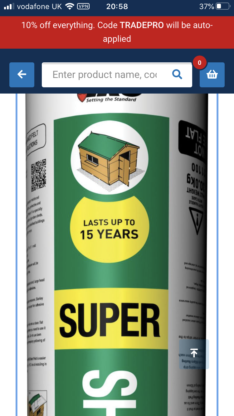

The Felt has more than likely torn, due tu it be tight on the edge & being a standard type Shed felt , I refelt quite a lot Of Shed Roofs and if you go for the Standard Roofing Felt you can
Normally Rip even new Felt , I’d recommend you strip it right off , check out for any damage to the Timbers , then replace with something like Wickes Super 15 year felt , you have to cut this with a Knife or heavy duty Scissors , maybe consider using a Jointing Overlap
Bitumen on the joints ( overlap them at least 200mm )
cheers
Phil
