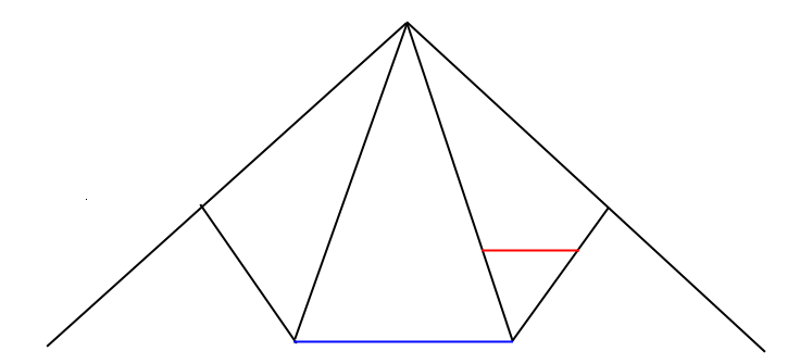

I have just raised the height of the joists in the loft to add extra insulation and have boarded over them.
Whilst up there I was thinking about shelving.
The house is a 70s house. The main loft is nearly square shape and only has outer brick walls - there are no internal brick walls upstairs (except the outside walls).
The roof trusses are a W shape with the centre of the the W being higher to touch the apex. The boarded section of the loft is under the middle of the W.
I was wondering if it is acceptable to screw a baton across the next part of the trusses to allow me to put a shelf across. I would need a baton on two trusses then I could span the gap with a shelf for storage.
I have attached a picture of what I mean. The black bit shows the trusses. The blue is my boarded section. The red is where I propose to put a baton (this could be duplicated on the other side too.
Is this acceptable?
I am not an engineer but have done this on every house owned in last 40 years. Obviously be reasonable and don't use them for car engines!
I think it might be worthwhile putting your battens between the two timbers in the "W" to prevent the weight of the shelf pushing down and wedging them apart, thus no longer straight (and a bit shorter)
edit, yes, like your sketch
