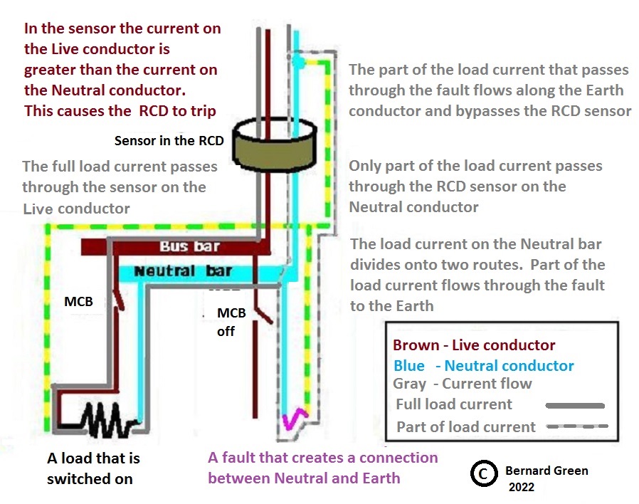

I had an extension socket hanging off a switched wall socket. I turned off the switch and was manipulating the wires in the extension. In the process I managed to trip the circuit breaker. I am pretty sure the wires were not live, although not sure. Is it possible to trip the circuit breaker shorting neutral to earth, assuming the wall socket is single pole switched that did not isolate the neutral wire? I have not checked to see if the wall socket is correctly wired because it's in a hard to access place.
The circuit breaker is the typical domestic thing-box with fuses and flip switches near the electric meter. I did grab all 3 wires to feed them out of a blanking box. All 3 wires touched. I am just wondering if it is normal for that to trip the breaker? It took out power for other people in the house using devices.
As ETAF said, if you have an RCD or RCBO in the consumer unit it will trip if either the live or neutral touch the earth. If, for example you live in a two story house and it knocked out the sockets both upstairs and downstairs then I think you are on a split unit. The upper and lower crcuits might be on separate "fuses" (MCBs) but in the event of a earth leakage problem, all of the MCBs will be rendered in operable until the RCD is flicked up. The RCB deals with earth problems, the MCBs deal with too much current (that is may lay explanation- I am not an electrician)

If the fused spur is only isolating the live, then yes, if the neutral after the spur hits the earth, it will trip.
I am only a lowly decorator but when loosening off face plates, I have tripped loads of RCDs even though I had already flicked the Mini Circuit Breaker (MCB) in the consumer unit. Sometimes the earth or other cables pop out when you loosen the metal socket plate for painting.
This is getting confusing.
The point is when you turn off the circuit breaker (MCB - Miniature Circuit Breaker) for just one circuit, it only disconnects the Line(live) wire and not the Neutral, so when you touch Neutral to Earth some of the current being used on the other circuits flows through the Neutral and through the Earth wire to Earth, consequently tripping the RCCB (double width Residual Current Circuit Breaker) which covers several circuits and is doing its job.
