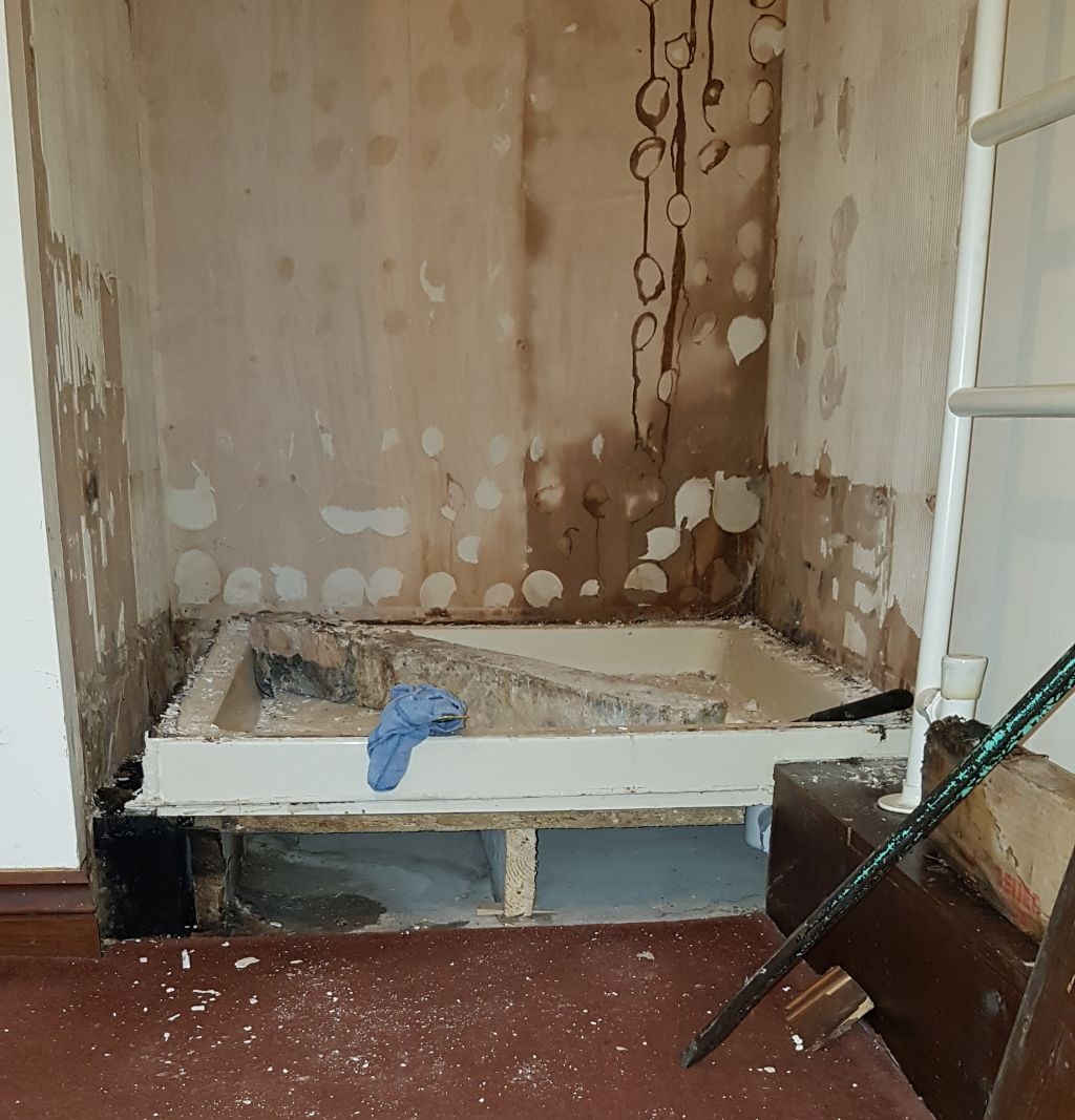

Our house dates all the way back to 1995. It's a pretty ordinary concrete block house with some studding and plasterboard internal walls. The bathroom has a three-sided space in it, which forms a shower cubicle. All three walls are plasterboard with tiles stuck on them. The other day, we noticed water dripping from the ceiling downstairs (some distance from the shower)! I suspected a central heating pipe, but when I cut a hole in the ceiling plasterboard, I could see that the water was running along the joists from the direction of the shower.

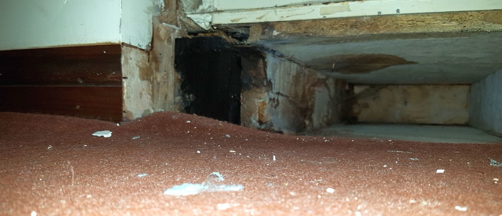

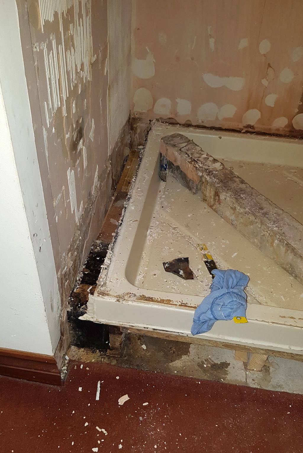

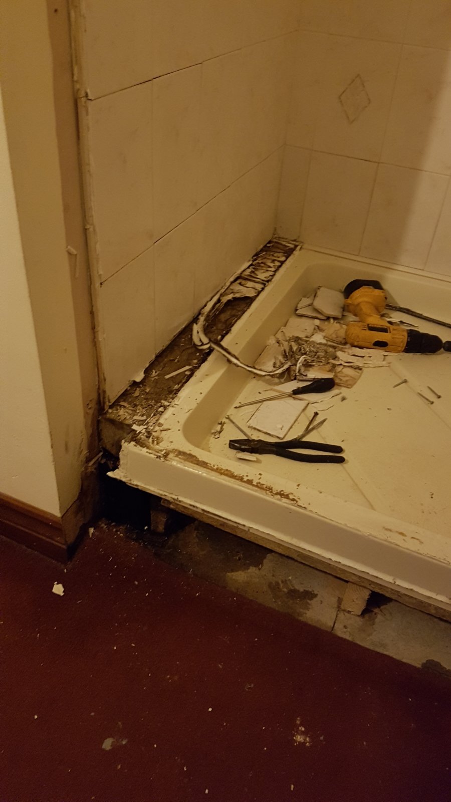

I've ripped off the tiles (many of them simply "fell off")! and the problem seems to have been twofold. First of all, the shower tray is too small for the space, so there are some horizontal tiles around the base of it - clearly, water has been getting under them and the chipboard floor is wet and mushy in places. Secondly, the cold water pipe feeding the electric shower, comes up inside the studding wall, and through the tiles into the back of the shower unit. One of the unions in the pipe was leaking (and had probably been dripping for a long time)!
I've cut (well, "punched"!) a hole in the soggy plasterboard and fitted an isolating ball valve in the copper pipe, so at least now, the leak has stopped. The question now, is what to do next? Obviously, I need to pull up the rotten bits of floor and make good. What should I do with the plasterboard? Will it dry out if left? Should I rip it out and replace? How do I go about waterproofing it PROPERLY next time?

You do not want horizontal tiles around the shower tray . Either get the correct size tray ,or build out the wall to correct distance to accommodate your tray.There are various products on the market for waterproofing shower areas.

Thanks everyone. No, I hadn't heard of "shower pods" - will look into those! I've still to get the tray out. It seems that the original builders put something that looks like a bin bag in the gap between it and the plasterboard and then filled it with concrete! I have a sort of "concrete log" between the edge of the shower tray and the mushy plasterboard... I'll get some photos and post them up when I've got the tray out.

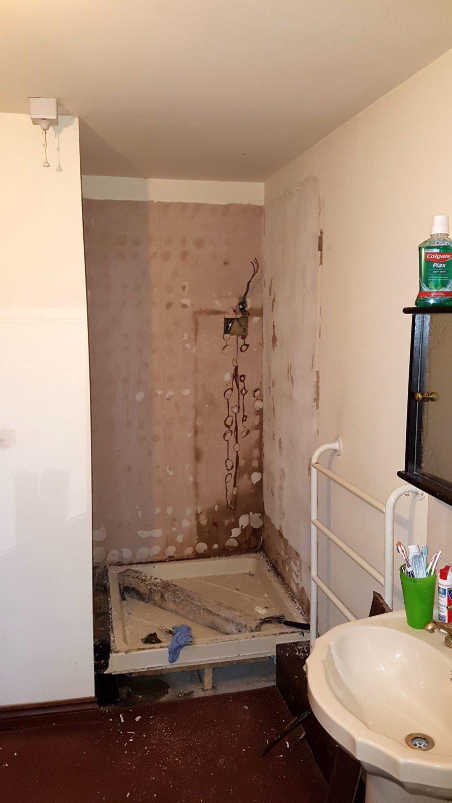

A few photos:
I'll upload a few more piccies when I've got the tray out. I'm mightily tempted by babasd's "shower pod" idea, but they seem to need building and then sliding into the recess and as you can see, I have the towel rail in the way. I'd have to drain down the central heating system to remove it.
The recess is fairly generous, it's 975mm wide and 990mm deep, so I guess I could just pick a slightly smaller pod and make some sort of infill for the gap between the right hand end and the wall?

Does anyone have any recommendations as to how best to get the old tile adhesive off the plasterboard walls in the photos above, please?

Best method- pull the plasterboard off the wall and skip it. Tile adhesive is much stronger than plasterboard...
Replace with cement based boards or Marmox or even waterproof shower boards (google them, the price looks high but actually isn't one you factor in all the costs of boarding and tiling)
EDIT Once you're back to joists/bare blocks you can pack the joists out to avoid the horizontal tile nonsense
