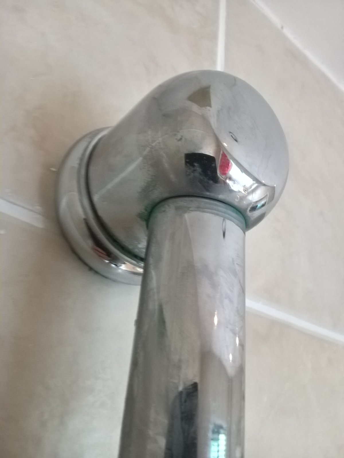

This morning I tried to adjust the head holder on the shower and it snapped. So I need to temporarily remove the riser rail so I can fit a new head holder on to the bar.
However, I cannot see how to remove the rail. There are large fittings that look like washers next to the wall but these are not responding to attempts to turn them by hand and I don't want to force them until I know what I'm doing. I attach photos and would be very grateful for any advice as to how to temporarily remove the bar. Thanks in advance for any advice.

From the photos it looks like the vertical bar unscrews into the bottom bracket and with a wiggle it will come out :) Could all be seized up thou,then hack saw it off and fit a new riser kit
Egmond Have you sourced a replacement shower head holder ?,they do vary in diameter. Usually the complete riser kit is exchanged,the Triton Adam riser kit is ok and comes with a new hose and shower head.(dont buy a cheap riser,there cheap for a reason).
Good luck :!:
Not overly clear from pics but sometimes there’s a grub screw on top/beneath the holders.. 1.5mm hex key sometimes...

Thanks. I can't get any rotating movement on the bar itself so if it is seized up it's seized up good and proper. As for the head holder yes thanks i found a decent looking one designed for 25mm bars, which this seems to be, so if I could only get the rail off it should be straightforward. Looks like it might end up a hacksaw job - thanks anyway.
Have now sorted this and I thought I would post an update on the remote chance that anyone has the same problem (I saw one or two similar threads on removing other riser rails).
The two washer-like rings next to the wall (shrouds), one on each bracket, were what needed to be moved. At first both seemed stuck rock solid, almost as if they were an integral part of the brackets. However, I chipped away some sealant and sprayed some Dw40 and tried turning them with a pipe wrench, turning at first anticlockwise as I thought they would screw backwards away from the wall to maybe expose screw heads. They didn't budge.
However, it worked when I turned them clockwise, as it turned out they themselves were fixed to the wall on an inner ring and the brackets screwed into them. The brackets then came out easily and I can now fix a new head holder.
