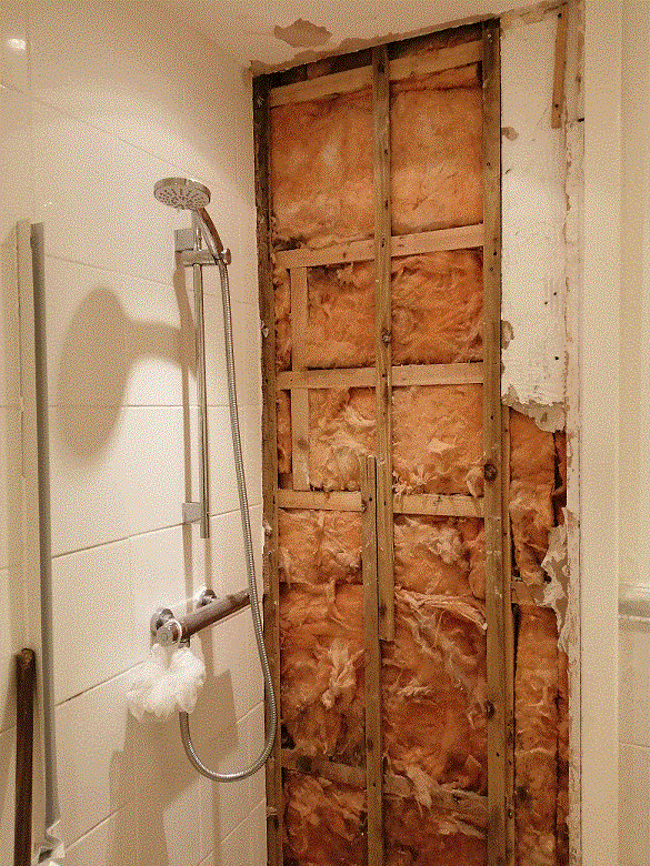

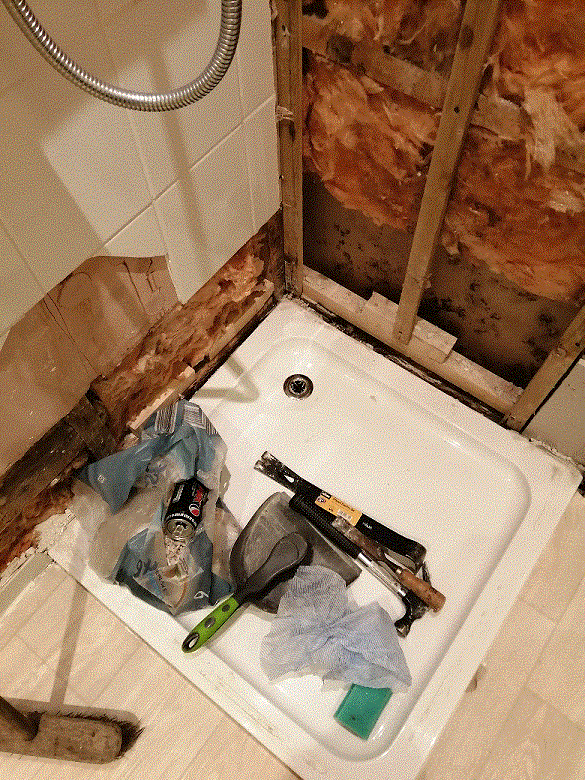

Hi all!
Bought first home last year which had a separate shower installed. Noticed a small leak when it was being used from time to time into the kitchen below. Fast forward one year and I've had several plumbers out and a new tray cubicle installed, but still getting this tricky leak through. We haven't used the shower in over 6 months as haven't had the money to pay anymore tradesmen to come out. I'm now thinking about tackling it myself so any advice would be greatly appreciated!
I have removed the existing cubicle and started to remove some of the tiles. I have decided to buy 'Shower Panels' instead of re-tiling. My plan of attack is as follows
1. Shut off mains water, and remove mixer shower.
2. Remove rest of tiles/plaster board
3. Check waste pipe for faults/flow/drainage
4. Apply new plaster board
5. Apply shower panels
6. Fit new shower tray
7. Fit cubicle
8. Seal everything?
I have attached a couple of photos of what its looking like at the moment! Any advice appreciated

I would rip out the rest - tray and all and start again. Walls could be done with hardie backer cement board.

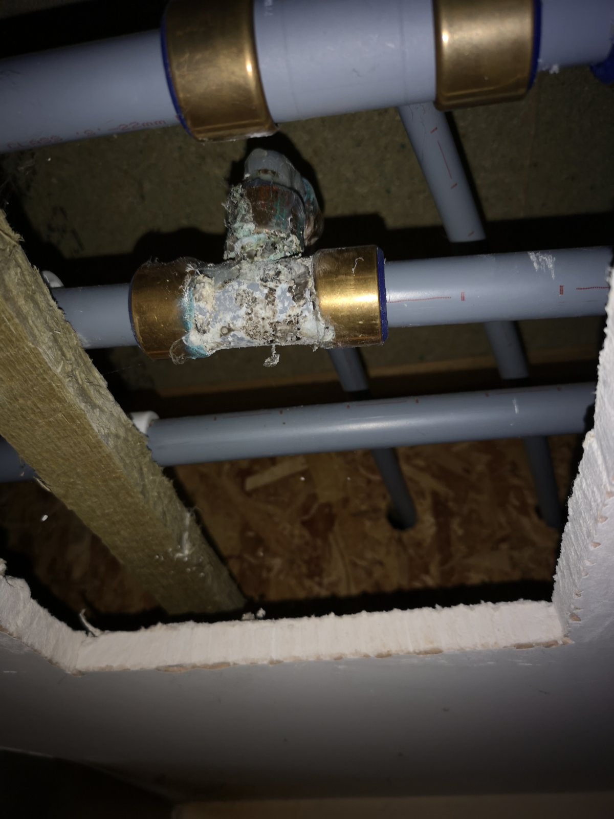

I would have cut an inspection hole in the ceiling below before ripping all that out, so that you could have pinpointed the source of the leak by running the shower whilst looking from below!
Still may have lead to a rip-out but you'd have had some solid evidence to go on!
I did exactly this last week... 2 ensuite showers with a leak manifesting on kitchen ceiling below.
Cutting hatch into ceiling revealed leaking Osma Gold fitting on dhw supply to upstairs. Nothing to do with showers at all :)

Thanks for your responses. After getting the tray out seemed like the waste pipe was sagging. I think it could of been a combo of this along with hairline cracks in the grout. Will continue the rip out mission over the weekend. Thanks again.
