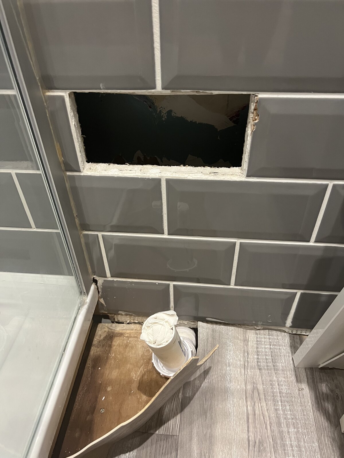

Hi all

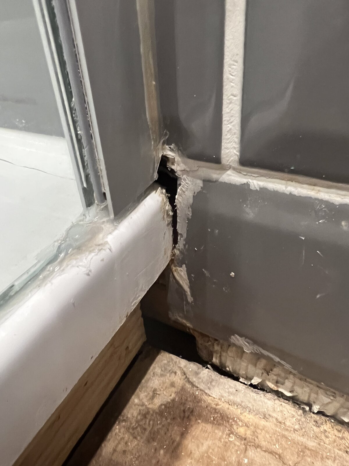

So I noticed a leak in my en suite, and upon removing the sink unit that was up against the wall/shower glass (poor design), it uncovered a lot of wet and a mass of absolute bodge by whoever fitted it. The tiles don't meet the floor and there's gaps everywhere, i've cleaned it up but it looks like water was leaking from the bottom of the glass, and right up in the corner behind the glass profile - which i am totally not surprised given there is not a solid surface that the frame is fitted to at the bottom! See pics..
Of course the best course of action is to rip the whole lot out and start again, which I would love to do if money wasn't an object, so what do I do hear, assuming this is the source of the leak? Do i just cane a load of silicone in there the best i can? Do i try and retrofit some sort of backing so the frame can be properly sealed to? I have no idea

Stand corner to corner on the tray and shift your weight.
Does the tray rock? Just a test to see if it's ok.
If solid CT1 is best bet.
You can use masking leaving a gap. Fill with CT1. Pull masking then run finger along on final time.
Start saving money to fix it properly
You need to establish if the tray is moving.
If it is or if it isn't, you will need to take the cubicle apart from the wall.
Strip out all silicon and clean. Leave to dry for 48 hours. Best put a fan in there.
Once all is dry , be sure that there is no movement with the tray.
All clean, dry and secure, you apply the silicone. Use a good brand. CT1 is too thick.
Leave to dry for 24 hours. Then fit cubicle with no silicone.
Once you're happy how it is fitted then you can apply a clear silicone to the outs of the cubicle. Do not do inside. 24 hours then use.
