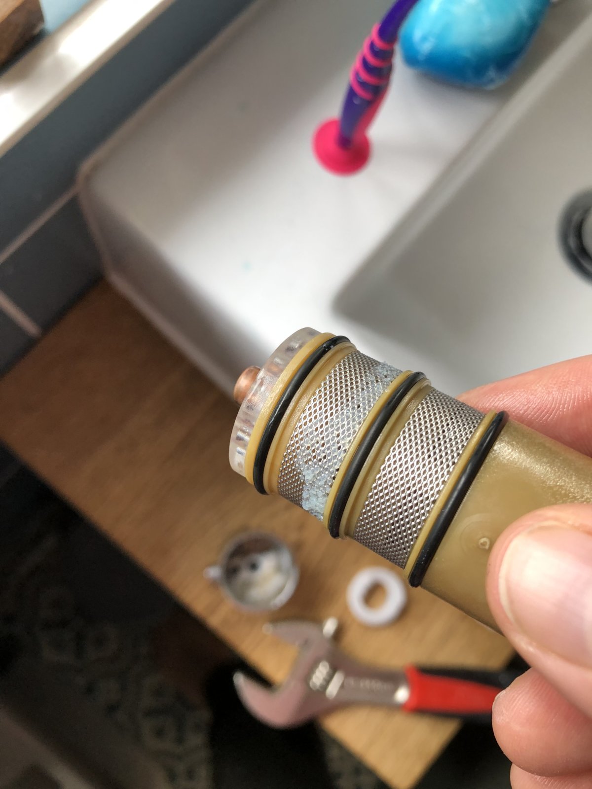

I have an upstairs shower (Aqualisa) which has been losing pressure or flow rate very quickly over the last few months.
Initially I thought this was limited to the shower and replaced the thermostat cartridge but after it happening again I've realised I keep getting a buildup of sugar sized white stuff on the shower filter (also appears on the tap filter in the same room). This substance seems to dissolve when I touch it and is easily cleaned from the filter. Initially after cleaning there was no improvement but after running the water for a while it gets back to and acceptable level. I assume this is due to air locks from having to turn the main supply off to clean the filter.
Annoyingly this seems to be happening in a fairly short period of time and the buildup comes back within weeks. The buildup only appears on the hot feed of the filter (they are separate) and the cold water pressure is always good.

Is there a way to confirm this. It’s not that old and the particles are easily dissolved. I would have thought the situation your describing would fill the filter with something that wouldn’t dissolve?
So filter cleaned last week and now looks like below. Even after cleaning the pressure is poor. Again the filter is easily cleaned and the debris has a sort of blue white colour.

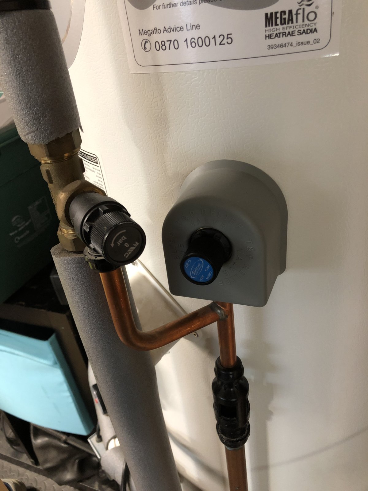

I’ve tried to replenish the air gap in the mega flow again and got maybe a minute of gurgling. It’s on the bottom floor so I don’t really have a tap that’s lower than the tank (slightly lower than the relic valve though). Can I use another method to create the gap and is there a way to confirm it has worked?

Very helpful thanks. I struggled to find those types of threads and that picture does seem similar to what I'm seeing unfortunately. I'm going to contact Megaflow and see what they think. The warranty situation confuses me. Its about 9 years old but installed by the previous owner. Anyway I will confrim the situation with them.
When I turn off the cold supply and run a hot tap it runs for less than 5 seconds (even after I try to replenish the air gap). Is this a sign that the air gap isnt being replenished as most descriptions expect the water to run for a period of time before you open the pressure relief valve?
The shorter the time the water runs the less the air gap.
You may need to drain the cylinder at floor level.
Ah thanks so I certainly don’t have good pressure and haven’t really replenished the air gap successfully. How do I drain at floor level? Megaflow don’t seem to show instructions if your unit in ground floor but surely it isn’t that much more complicated?

So engineer visited and has confrimed the baffle is intact and isn't the issue. Said the tank was collecting a lot of limescale and she believed this is what I'm seeing on the shower filter. Suggested I might be able to get someone to remove the limescale from the tank and that I should use a water softener as this was a hard water area, south east water list it as moderately soft so this doesn't sound right to me, to stop this happening again.
So it seems my issue is some sort of limescale blockage on the hot water feed to the shower so I'm going to have to look into getting that fixed. I also need to get the tank empty of this limescale and look into softening the water. The only thing I can think of that may have caused the sudden change is the use of a solar diverter on the immersion which means it is being used regulally compared to previously where the hot water was from a gas boiler only.
