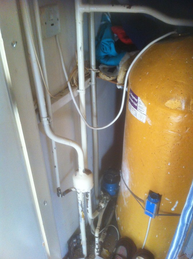

Hi all,
I am going to fit a RSP50 SHOWER PUMP, I have a gravity feed system with the water tank in the loft and the boiler in the first floor, and looking at the instructions it tells me that it will be better to fit near the boiler
I had a look in the loft and there is the cold water tank feeds direct above the shower (one pipe), and there is a hot water pipe in the loft again feeding (hot) the shower from above
Will it make better to have the shower pump in the loft and connect the pipes there?
OR do i put a valve in the middle of the boiler and then send the pipes up in the loft (to feed the shower)and do the same with the cold water, as I must not feed the cold water direct from the mains only from the cold water tank

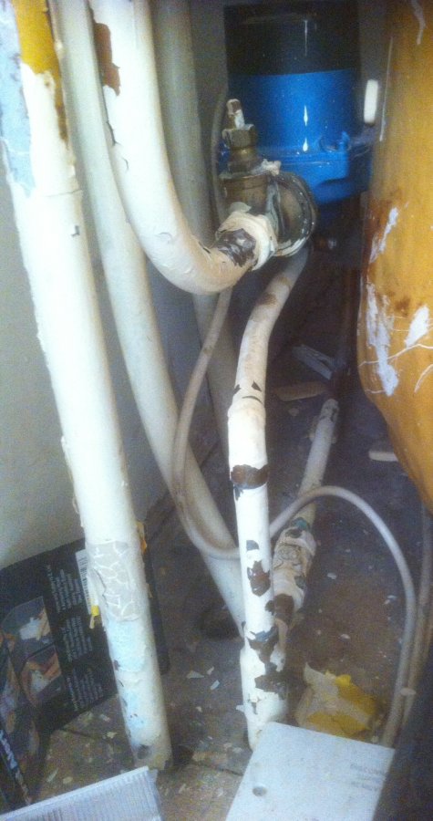

I have put 2 pictures from the boiler area!!!
Your help is much appreciated THANK YOU

Please note that the pics you have shown are of the hot water cylinder and not the boiler. If you put the pump in the loft you will probably need a negative head pump. A normal pump can be sited next to the cylinder on the floor. Either way, the cold supply needs to come from the cold water tank via a dedicated pipe - down to the pump. The hot supply needs to come from the cylinder either teed into the pipe coming out of the top and at an angle of 45 degs or via a flange fitted to the cylinder depending on the instructions supplied by the manufacturer.
As the pump is second hand, you would not be invalidating any warranty if you connect to the white pipe coming out of the cylinder (the almost vertical part) with a tee fitting. Some will argue that you need to fit a flange but I have never had a problem fitting to the pipe.

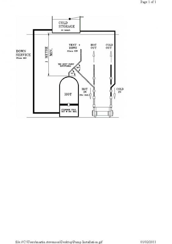

That's really odd. The pump will be pumping hot water from the cylinder, not the sludgy black gunge that normally circulates through the boiler why would it need to be near that?! There is a diagram on Salamander's web site showing an RSP 50 connected to the cylinder. With the comment that "the best position for the pump is at the base of the hot water cylinder and as close as possible to the cylinder" http://www.salamander-pumps.com/how-to/install-shower-pumps.html

That's really odd. The pump will be pumping hot water from the cylinder, not the sludgy black gunge that normally circulates through the boiler! There is a diagram on Salamander's web site showing a RSP 50 connected to the cylinder. http://www.salamander-pumps.com/how-to/install-shower-pumps.html
It is possible to tap into the hot water supply where it leaves the cylinder at the top if it's difficult to fit a special flange just for the pump.
He means the cylinder
