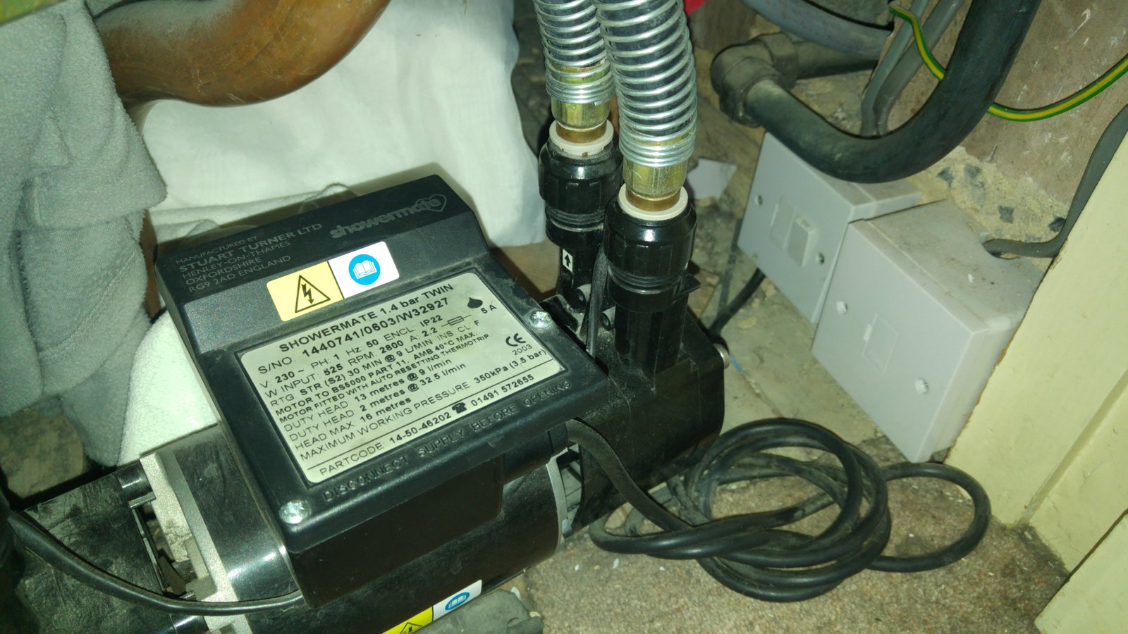

I have a Stuart Turner ShowerMate twin shower pump which has suddenly stopped working properly. It stops and starts and even when it's running the pressure is low. Because this happened a few days after I replaced a ball valve in the header tank in the loft, a process during which some debris including a clump of glass fibre loft insulation fell into the tank, my conjecture is that the problem may well be caused by a blockage of the cold water inlet to the pump.
Does this sound plausible? In theory it should be easy enough to check out, as I believe there is a mesh filter which I could clean. The problem is that, as far as I can tell, the pipe from the header tank goes straight to the pump without any kind of stop valve. This presumably means that I would have to turn of the water at the mains and completely drain the header tank to do this work. Is this normal?

Post a pic of pump and pipe leading to it. Every time I fit one I always use a full bore leaver isolator. Makes sense mesh could be partly blocked or maybe air in pump. Turn pump off and turn shower on and place handheld shower attachment on floor. Run for a minute and then turn pump on while someone holds the shower attachment on the floor incase it's starts going everywhere

Sorry, one of the images is duplicated there. The one showing the pipe coming off horizontally is where the pipe to the shower pump branches off the main pipe from the header tank. The other two are joins further down (including another pipe going off somewhere else, not sure where), and the pump itself. The nearer pipe on the right of the pump is the one from the header tank.
I tried the technique for sorting out an air block yesterday and it didn't do anything. Just tried again now, leaving it for a minute following your suggestion, and still no joy.

I assume the loft tank also supplies a hot water cylinder ,so you may well have contaminated the hot and or cold . no isolation valves on your pics ,unless they are within the final connections to the pump and not showing on pics.in their absence you can fit " bungs" into the water outlets at bottom of loft tank ,but a safer way is to drain out. I would also check the filters at your shower valve inlet ports .
Best best isolate mains drain down and check filter on pump, have a bucket handy to put pipe in once undone to take water out of pipe

Coincidentally, I have the same make of pump, although its a ST Showerforce twin impeller one. I've been experiencing slow start ups, and on occasions, it sometimes takes 30 seconds to kick in. Its 5 years old, and assumed it may be the flow switch packing up, however if there is a filter, it may just be blocked, or perhaps the pipe has a blockage, enough to slow down the flow less that the 0.9 L/min required to start the pump.
Are the filters on the incoming pipes or inside the pump itself?
ps: Just spoke with Showerforce, and they reckon an airlock in the pump causes these symptoms. They recommend:
1. Isolate the pump electrically
2. Remove the shower head, and ideally attach a hose to get more flow
3. run the hot water for a good few minutes, then run the cold water for a few minutes
They reckon this may force out any air bubbles locked in the pump.
Sorry to hijack this thread, but it may help.

If the shower pump has always been slow to start, its worth checking it has been plumbed in properly. Failure to take the supplies from the right points in the system can allow the supply pipework to airlock, or the pump draw in air, muck or both, possibly leading to cavitation, and/or premature pump failure.
