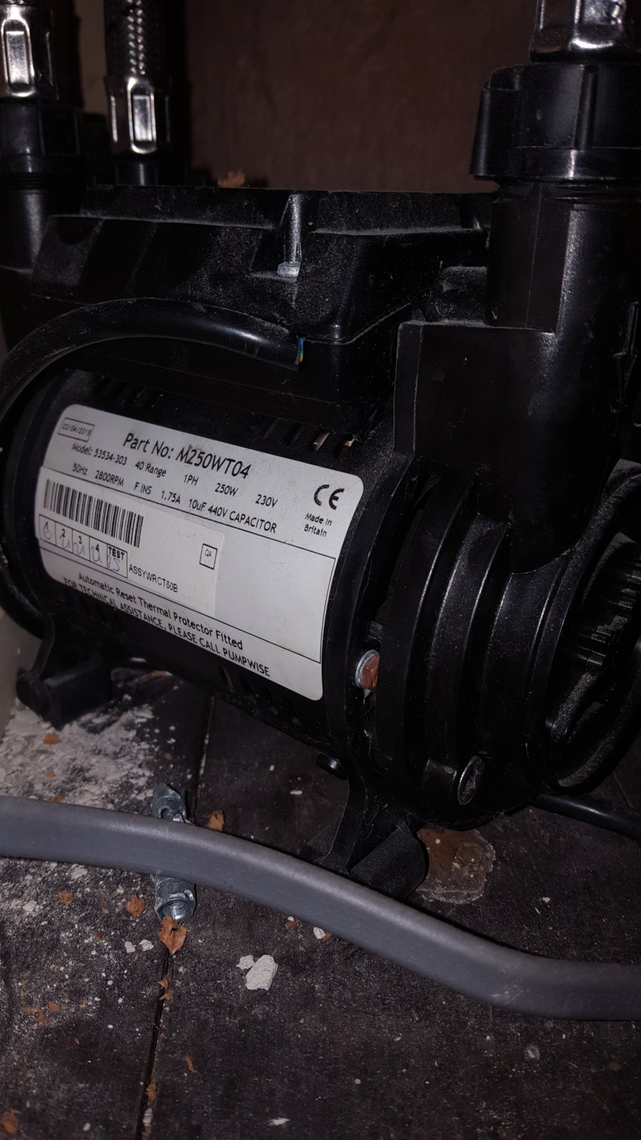

So, we moved into a new house last year. The previous occupiers told us that they had a pump installed to increase the pressure to the shower. This has always worked fine but been very noisy. Yesterday it appears to have stopped working as the pressure has vanished. It still makes a noise but nothing like it did and there is a smell when it is active.
- does it sound like the pump is knackered?
- I have attached some pictures of the pump, details etc. any advice about a decent pump which may replace this one?

I'd recommend Stuart Turner pumps.

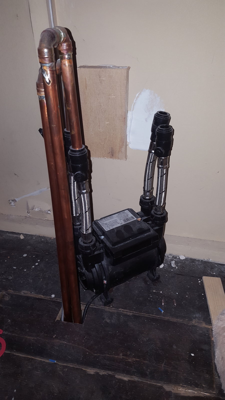

Just noticed the disconnected pipes, has it always been like that?
If so that will break the pump very quickly, if you don't need a twin impeller pump then buy a single.

It has always been like that (since we moved in anyway), doesn't surprise me that it was not done well, been the story of this house so far...

Hmm. First picture shows the original supplier as Wren Bathrooms. In my experience, not a premium supplier.
As above, it looks like you only need a single impeller pump. The noise/failure may be because the unused side has been running dry for a long time.

I guessed that, cannot seem to find much about them as a supplier, appears to have a logo of Salamander on the side too.
