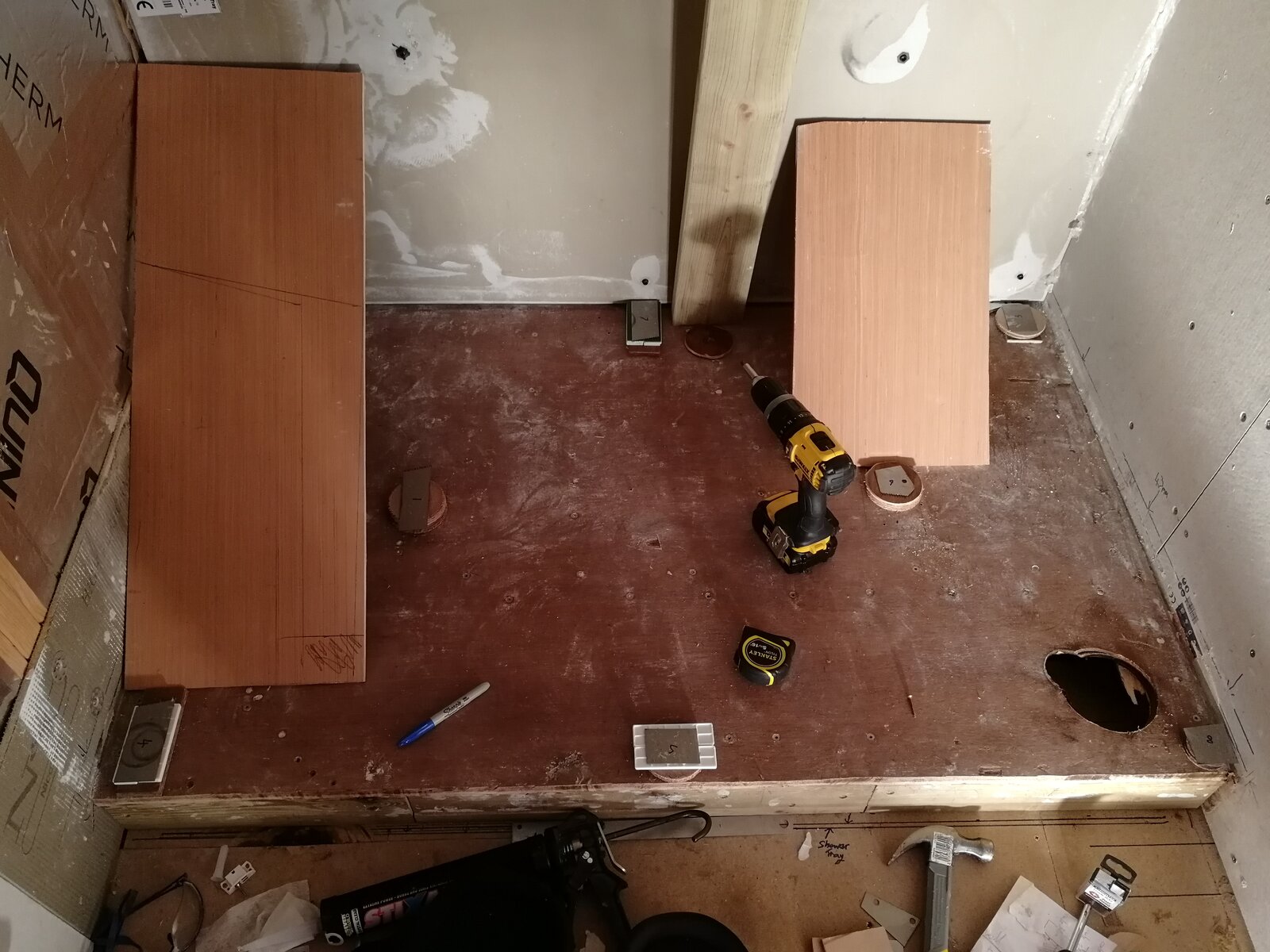

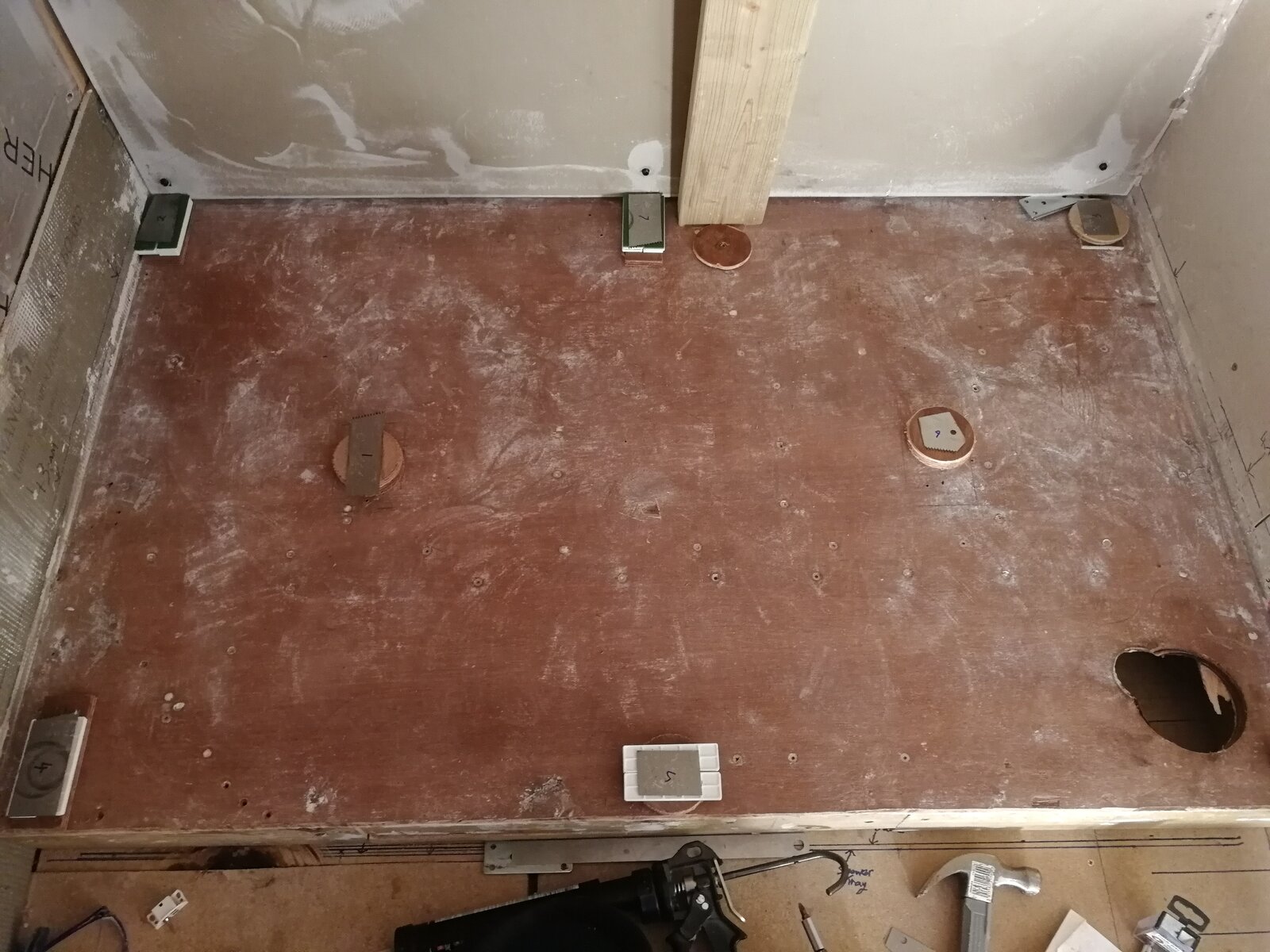

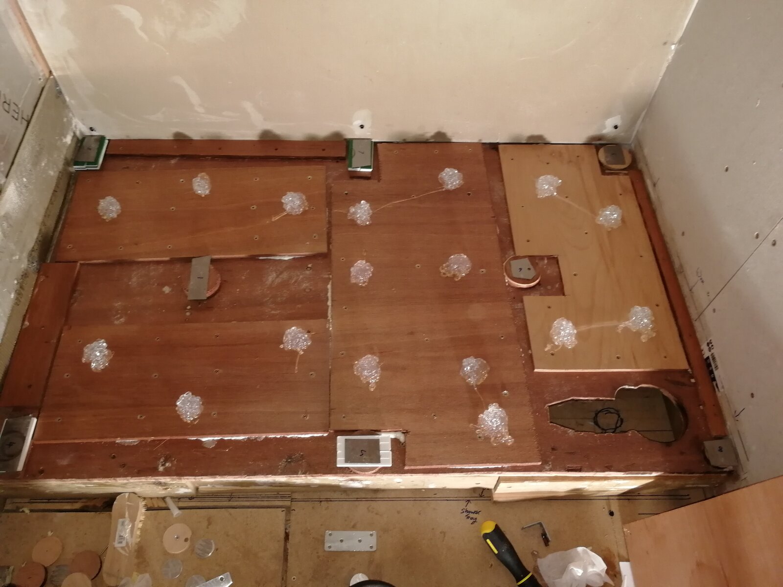

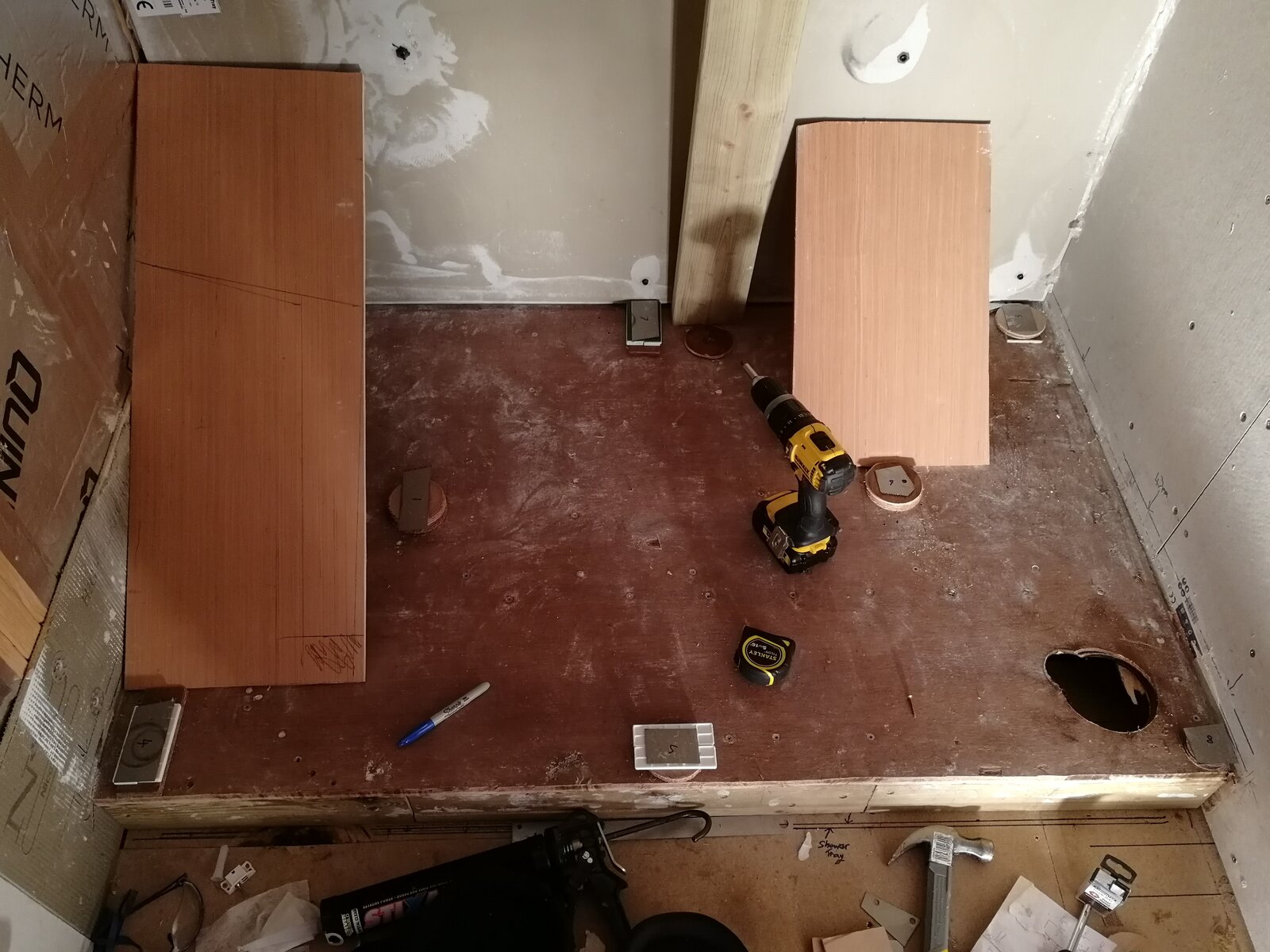

Sounds like good advice to me Rob, thank you. After a load of faffing around, I realised the base/plinth isn't straight, rookie mistake! Gonna have to pack up with varying thicknesses of wood with aluminium on top so the load screw doesn't dig in (probably more economical using 50p pieces the amount of wear with my drill bit, lol). I'm also going to use Stixall underneath and silicone on sides.

That's a very unconventional way to fit a shower tray, to say the least.
I wonder what a professional bathroom fitter would think if found something like this in dismantling a shower tray.
I know what i would say: starts with b and ends in odge.
There isn't really an issue using plates to sit the screws on, if that's really the way that they want their trays to be fitted but I'll be totally honest with you (not like me :whistle:), if it was me I'd be throwing those self levelling screws away and sitting the tray flat to the plinth.
I'd be checking the tray first of course, making sure the base has been manufactured dead level (if not send it back) and then sit it on the plinth and use whatever choice of bedding method was suitable/appropriate.
The tray base will never be dead level, that's why it needs to be bedded into something (adhesive, mortar, silicone, anything else people have used in the past and worked).
To help you, rest the tray on the floor in its final position, level it by using your screws, spacers, anything until you're happy with the level.
As said: only very extreme edges must be levelled, not the inside of the tray which has a fall.
Once you have positioned your spacers/screws/whatever, remove the tray, place your choice of adhesive/mortar, silicone/camel spit/goose fat and then drop the tray in place.
Stand on it to press it down.
Double check level only on very external edges.
It's more difficult to explain it than doing it.

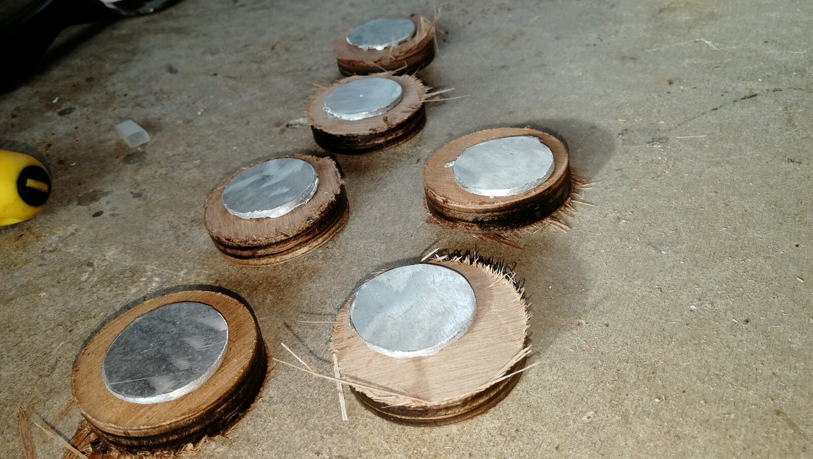

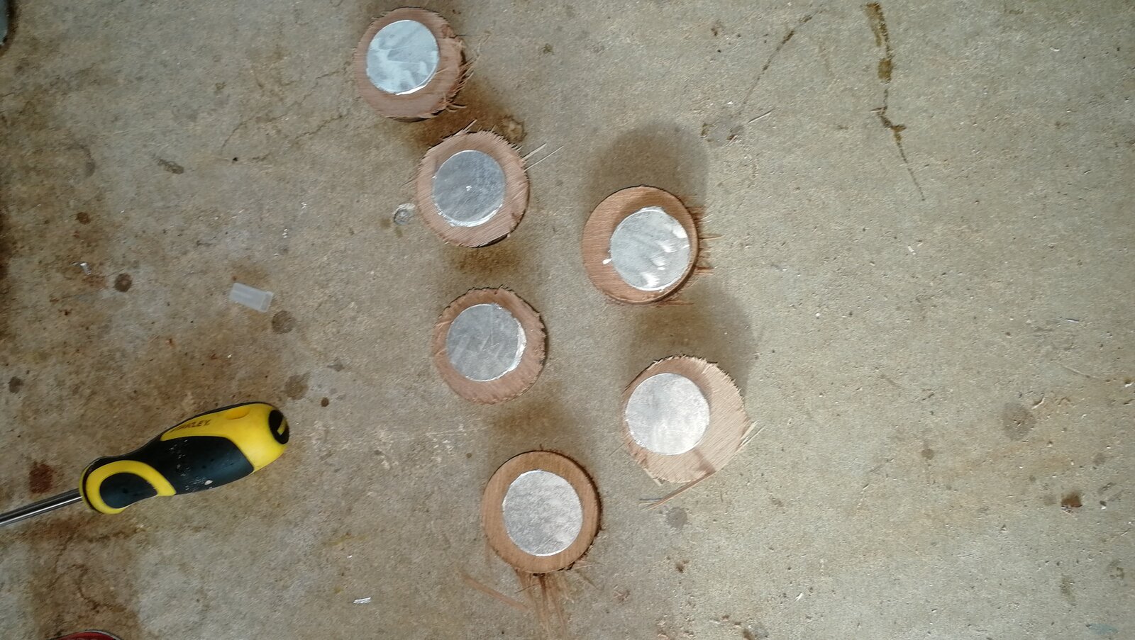

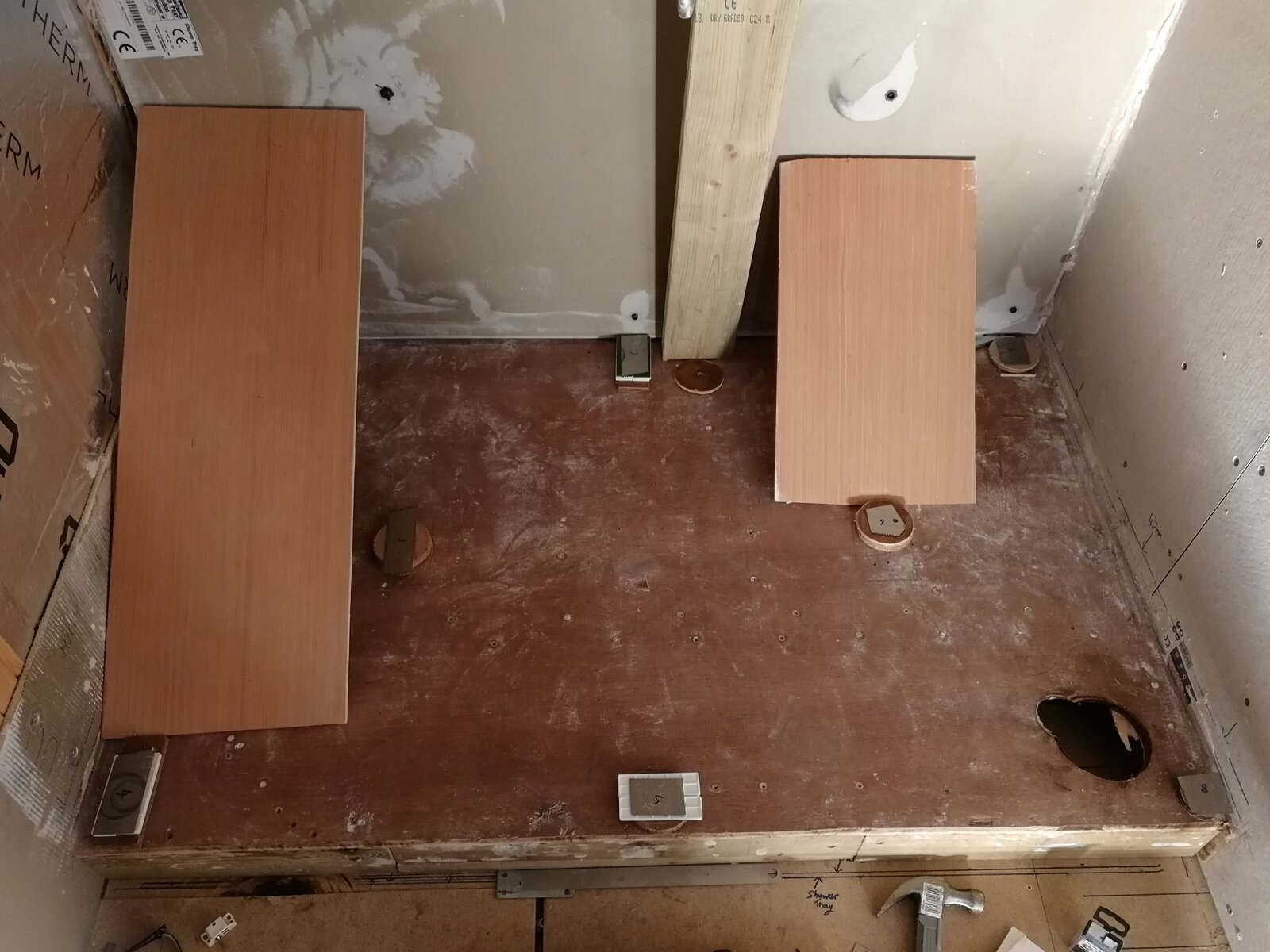

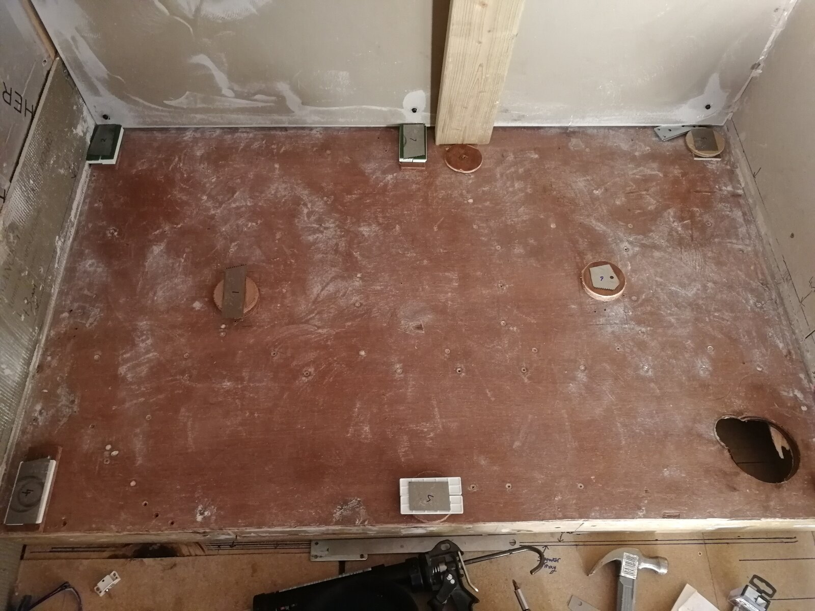

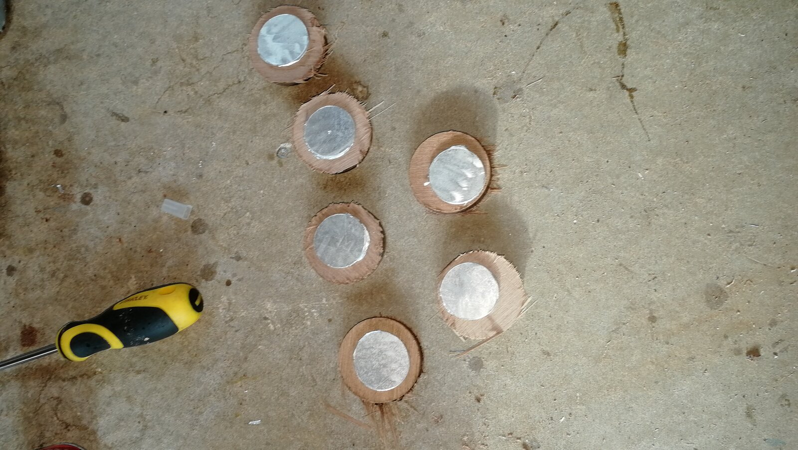

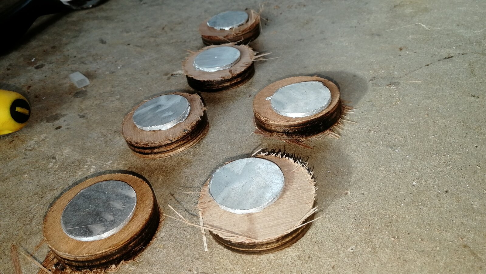

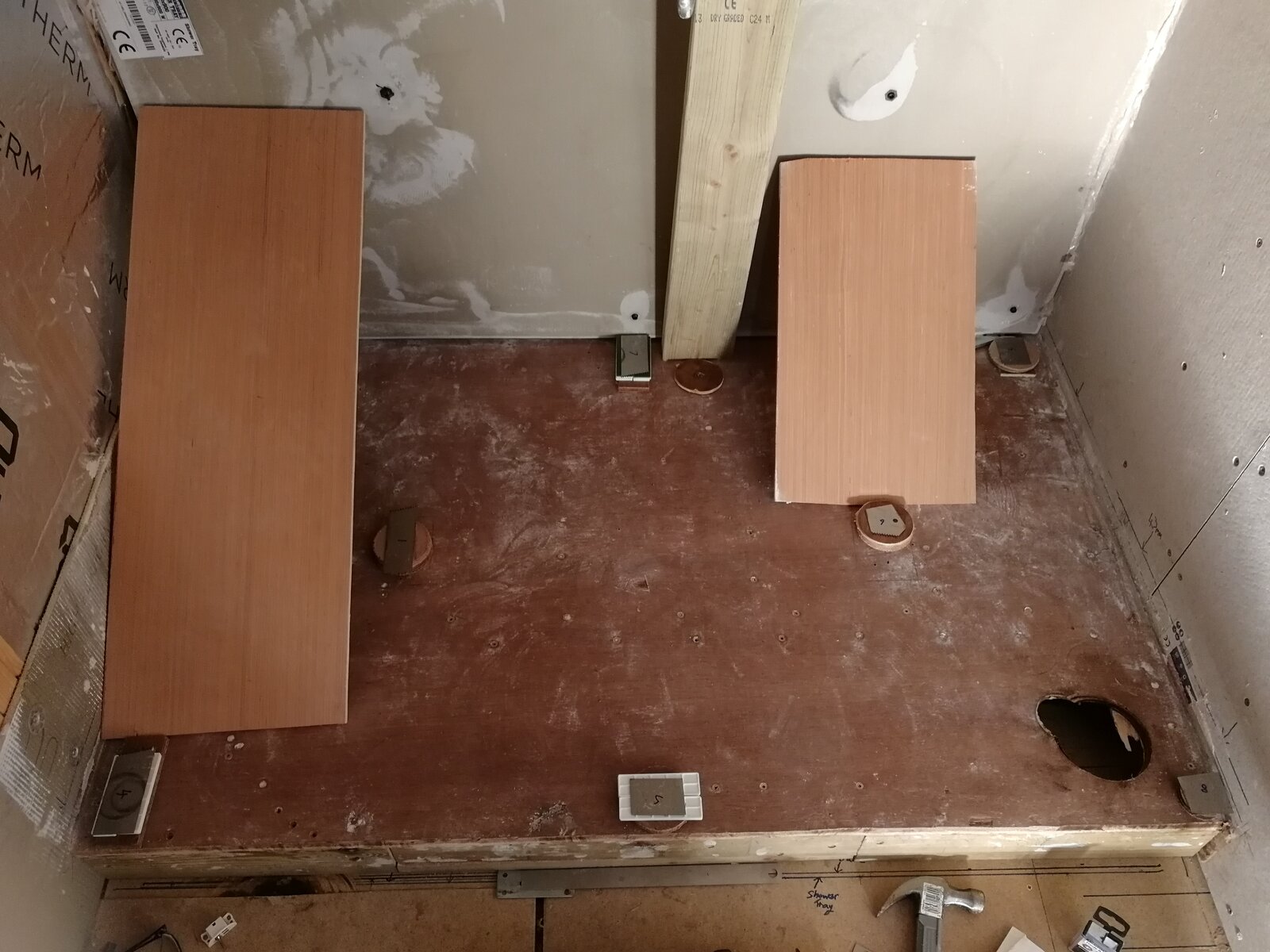

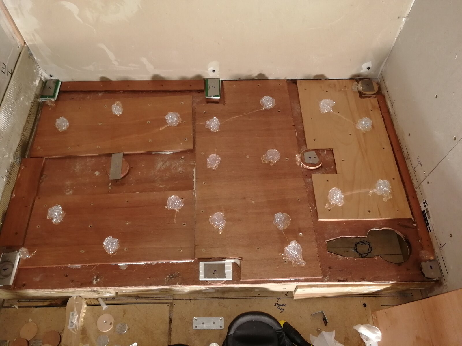

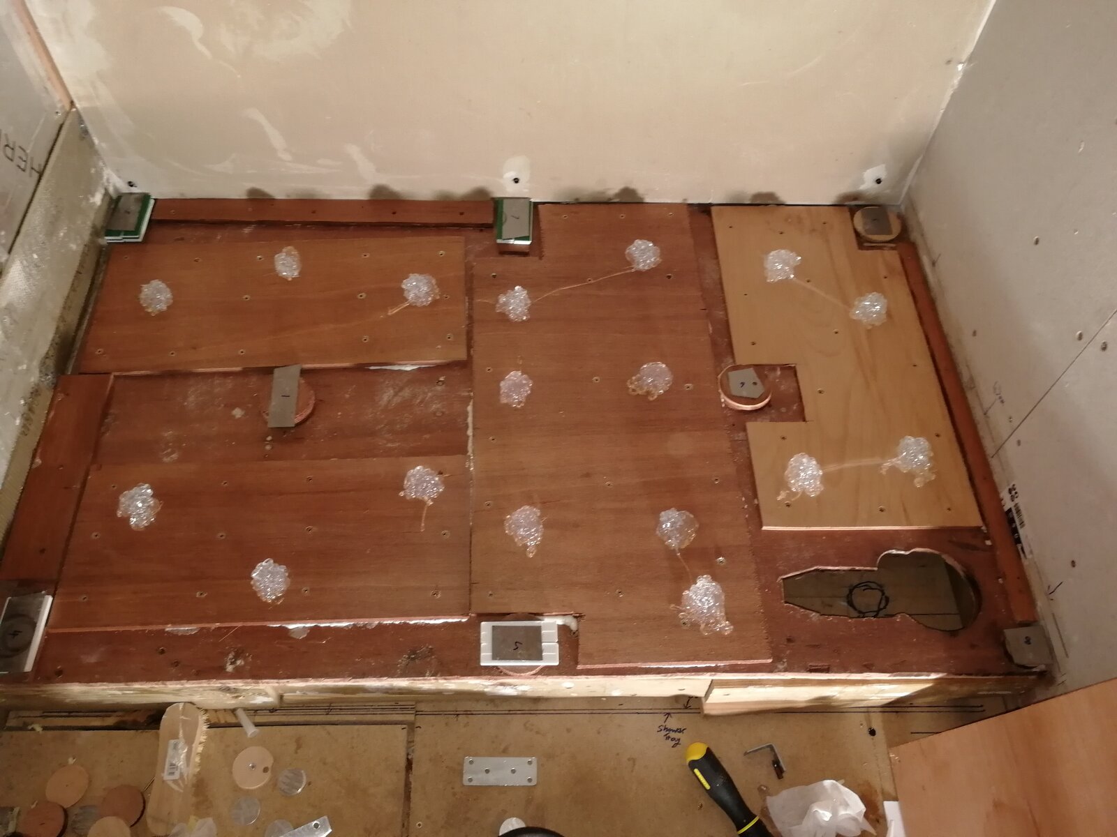

Just wanted to give update. Had a mental block with this and only returned to it yesterday. As the base(marine ply) wasn't level, I had to pack under the levelling screws to get level. Took me hours faffing around but really happy with level now. Used a cut up saw blade on top of packers so levelling screws wouldn't dig in. All the packers have been glued and screwed and left overnight so I'll SBR the base and underside of tray and silicone/sealant it before placing tray back down. I didn't realise how much easier it would have been if the marine ply base was dead level. Any thoughts on which sealant/silicone to use and how much to use? Stixall was my thought.

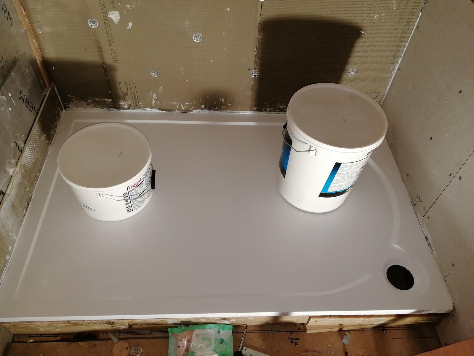

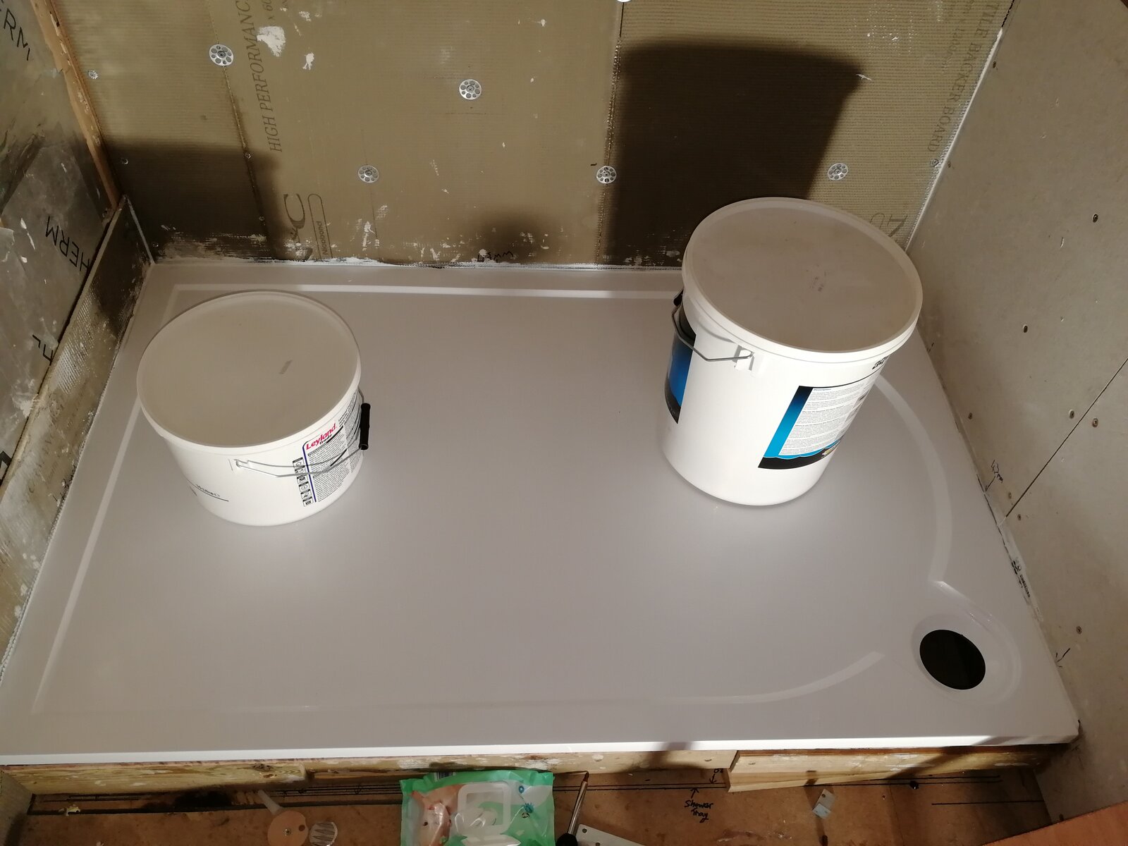

Finally installed shower tray! Top tip for anyone using tray with built in levelling screws, make sure base is level.
I screwed a few pieces of marine ply to build up to the underside of tray to make it easier when siliconing underneath.
As you can see, blobs of Stixall underneath to give it more stability as I just couldn't trust a few little grub screws in the end. So MI out the window and fingers crossed that this very unconventional installation will work
