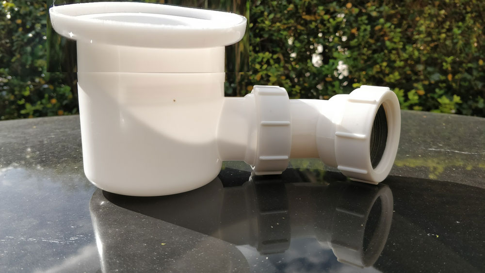

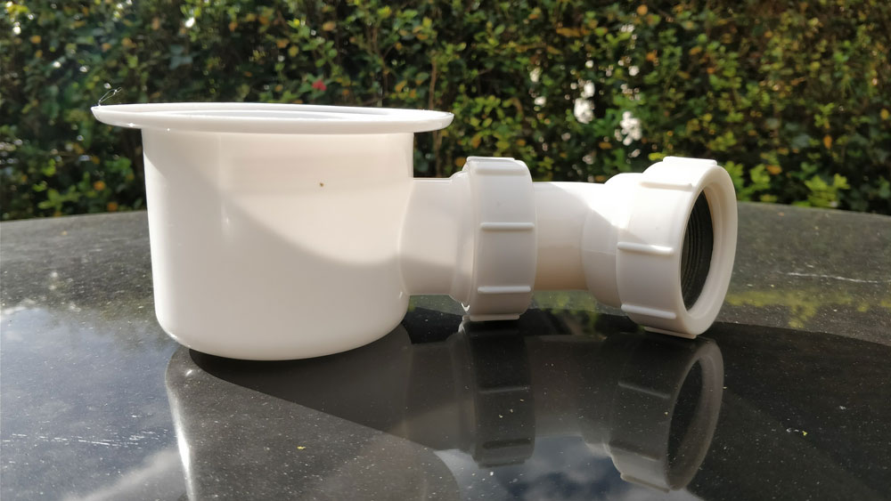

Shower traps are too low profile - help!
5 Feb 2003
111
All the shower traps I can find are, for obvious reasons I guess, very low profile. However because of pipe clearances and very limited room to work or make alterations, I find I need a deeper trap (like the photoshopped pic below), so that the waste exits around 90mm below the shower tray base. All the examples I've found are around 35/40mm. Plumb Centre had no ideas but I'm hoping one of you boys or girls has a solution
Thanks in advance

Have you got the shower tray yet ? if so what is the diameter of the waste outlet.
In the mean time,this the vertical version of a decent trap..
McAlpine Bottom - Vertical Outlet 90mm Shower Trap
It's a 90mm....that looks promising, sods law its too deep!
Thank you.
You can actually cut a keyhole shape in the board directly underneath the tray you know! It doesn’t have to be a perfect circle - that’s what I always do but I have often thought that a deeper trap or trap extension would be useful on occasion!
