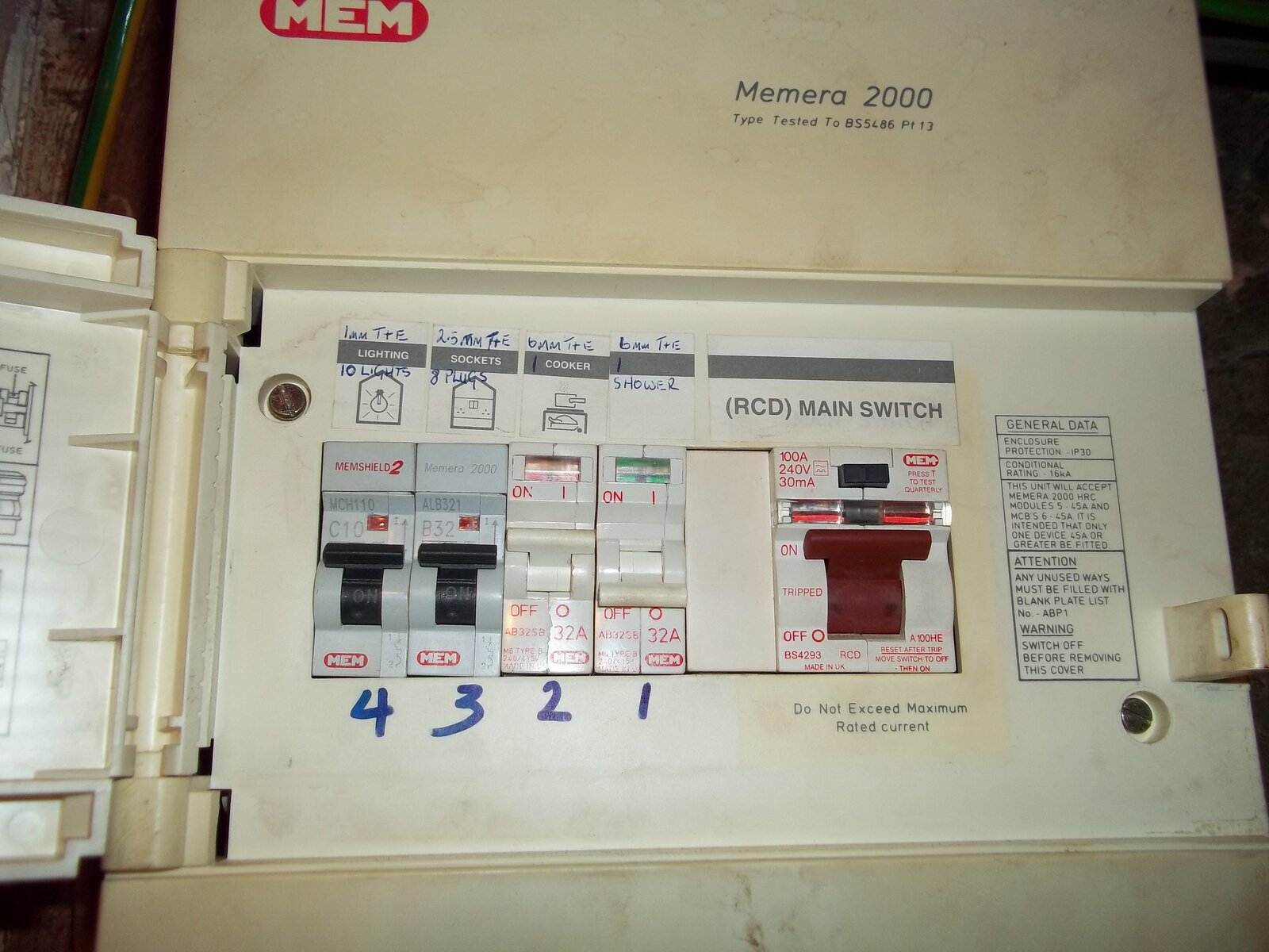

My plans have been thwarted due to foreseeable gas prices.. this has complicated things.
So.. I have decided that my best option is to go for an electric shower rather than running off the combi boiler.
There is already wiring for the long-deceased electric shower.. however it was pretty feeble in the winter anyway... 30A 6mm.. max 7.5kW.
The bathroom (ground floor) is being gutted anyway.. ceiling down.. whole lot. Also not too disruptive to lift floorboards through main part of house, so that's not really an issue.
From what I can gather the existing wiring for the shower from the main fuse box is 30A 6mm (see pic).. if I'm going to have an electric shower I may as well get a good one... 10.5kW.
Is it possible to simply change the 30A in the main fuse box to a 40A module and then run a 10mm cable on a like-for-like basis.. basically a 'system' upgrade?

From what I can gather the existing wiring for the shower from the main fuse box is 30A 6mm (see pic).. if I'm going to have an electric shower I may as well get a good one... 10.5kW. .... Is it possible to simply change the 30A in the main fuse box to a 40A module and then run a 10mm cable on a like-for-like basis.. basically a 'system' upgrade?
A 10.5 kW shower would need a 45A or 50A MCB in your consumer unit (what you call 'main fuse box'), not 40A. Depending on how it is installed (routed) the existing 6mm² cable (if that's what it is) might be adequate - an electrician could advise, and could also advise as to whether a suitable MCB would be available for your consumer unit.
If the MCB were 'upgraded' (and certainly if the cable were 'upgraded') then I think that most people would probably regard that as 'new work' (maybe even as 'new circuit') (rather than just 'replacement') which, in a bathroom, would be work that had to be notified to your Local Authority. That being the case, it would probably not be cost effective to 'DIY' it (if that's what you were considering), since the fee for the notification process would be £££ for you, but only a small handful of £ for a suitably 'registered' electrician ("self-certifying", which really means "self-notifying").

You don't seem to have RCD protection so would have to replace the MCB with a RCBO not sure if you can get a Memshield 2 RCBO so it could mean a consumer unit change, so on top of cost of shower unit also cost of CU so looking at over £500 could be £1000 that will buy a lot of gas.

Having said that, if one is going to have an electric shower, one might as well go for the biggest one that one 'reasonably can' - and in the OP's case a 9 kW one could well be a good compromise - because (with a 40A breaker) his existing 6mm² cable (if that's what it is) would almost certainly be adequate.
