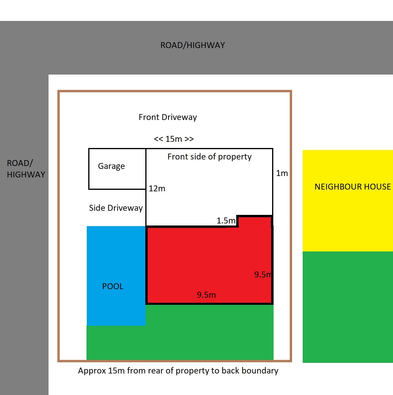

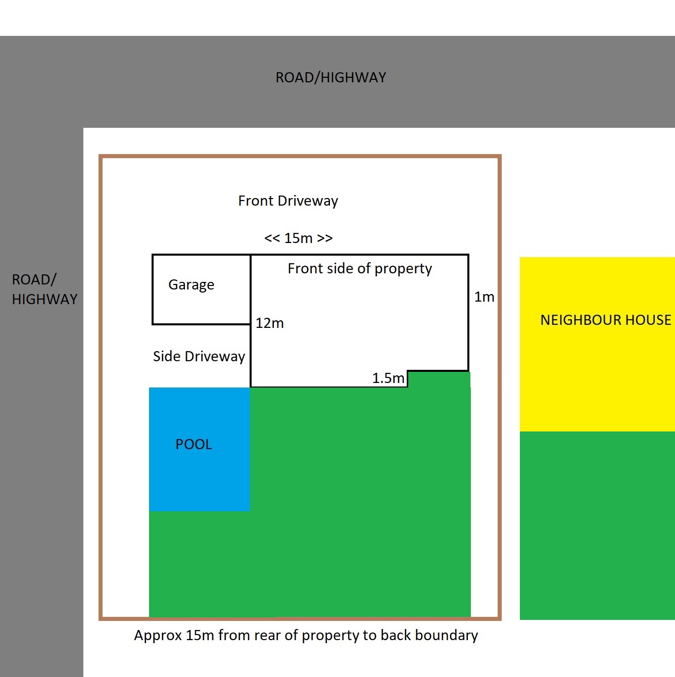

Bungalow rear extension.
See current and planned drawings attached. (sorry not to scale :) )
Questions:
If I limited the rear extension depth to 8m, would this fall under 'Prior Approval' permission? Is there a width restricted for prior approval?
If I am correct the permitted development will only let me go up to half the width of my "original" property? This is 6m (12m total as there was a extra garage built at a later date to make up to 15m)
I have a drop down from the back to my garden of approx. 0.85m. Obviously garden will have to be raised, will this cause an issue?
The dog leg might make it a side extension.
PD has limit of 3m above ground level to eves.
side extension? really?
The height to eaves currently is 2.5m
Then there is a level patio area approx. 1m wide
Followed by a 0.85m drop to the lawn
Sorry for being ignorant but will this cause issues?
I doubt any of that would be permitted development because of the short 1.5m length of wall.
If i go down the full planning permission route... what are the chances of planning officers approving what I have in mind?
Look up your local council's policy guidelines on domestic extensions; the limits they look for on rear extensions will be detailed there (and will likely be less than the 6m/8m limits allowed under the prior notification scheme).

Well it is quite a big extension and you would be left with a garden only 7 metres deep (15 - 8m) :!:
7m is still pretty significant. I am sure I have read some where that as long as I’m 7m+ from rear boundary then that would be sufficient.
Haven't heard that as any sort of 'Planning rule' but I suppose you have a fairly wide garden.
The minimum 7m rule is for two-storey extensions; there is no PD limit on how near a single-storey extension may be to the rear boundary.

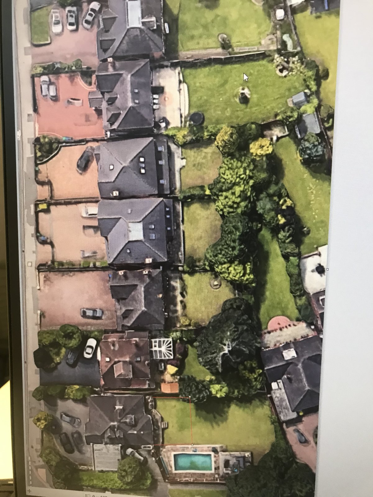

Have attached a pic from google maps, have drawn a box in red where I would approx like to come out to (bottom property)
