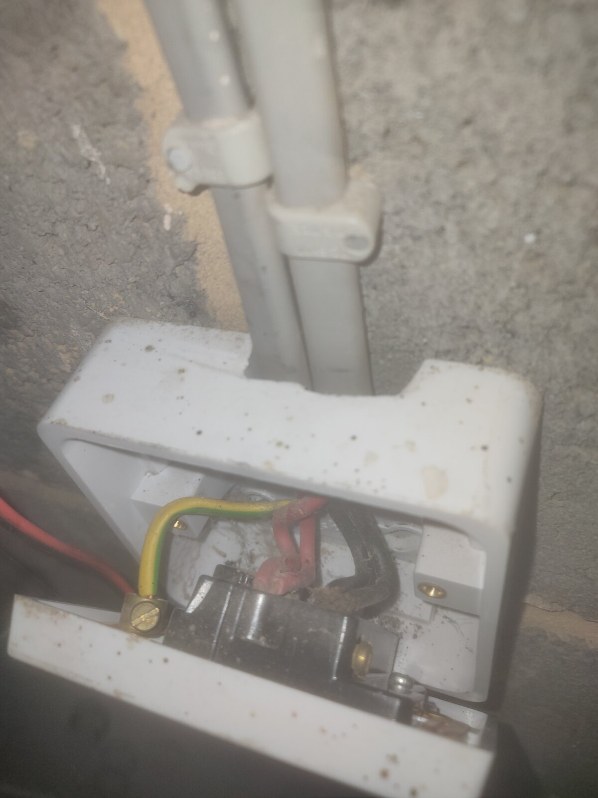

I live in a home built by property development group David Wilson that was built just over 30 years ago.
Today I decided I wanted to create a spur off a socket in my garage. Out of curiosity I decided to see which MCB it belonged to so shut off the switch labelled "downstairs sockets". This did not turn off the power to the socket. So i turned this switch back to on and switched of the MCB labelled "Upstairs sockets". Still didn't turn off the power. Turned off both MCBs and that shut off the power to the socket. This seems highly irregular. Why would a socket need two MCBs?
Do I need to get an electrician out to look at this? The plug has been providing power to my soldiering iron and workshop hoover for a decade but that still doesn't mean it's safe.
Thanks for any advice.
Dan.
P.s. this socket is supplied by two wires and think each go to their respective aforementioned MCBs. See picture attached.

I expect you will find that this little "feature" applies to many sockets in the house.
This is (usually) caused by someone connecting up the two (usually ring) circuits incorrectly and mixing up the final connections in the fuseboard
or
someone adding some wiring and connecting up the two circuits, somewhere.
It's not going to cause a fire, but it is dangerous for the unwary because ( as you have found out) turining off the downstairs sockets MCB should turn off that circuit.
-experienced electricians will always check that off really means off- but your average DIYer doesnt realise the dangers.
I really suggest that you get a competent electrician to investigate and resolve.

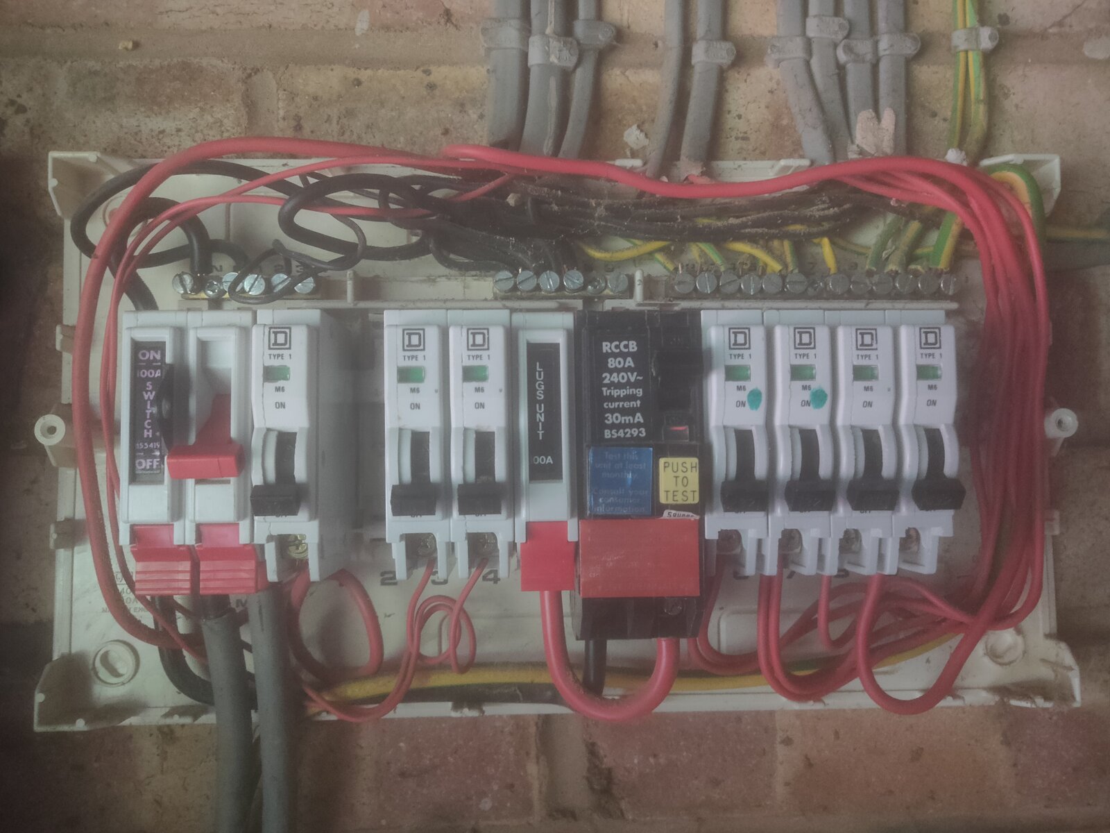

Presumably then, each MCB in question has two wires at it, and someone has mixed them up, in the consumer unit.

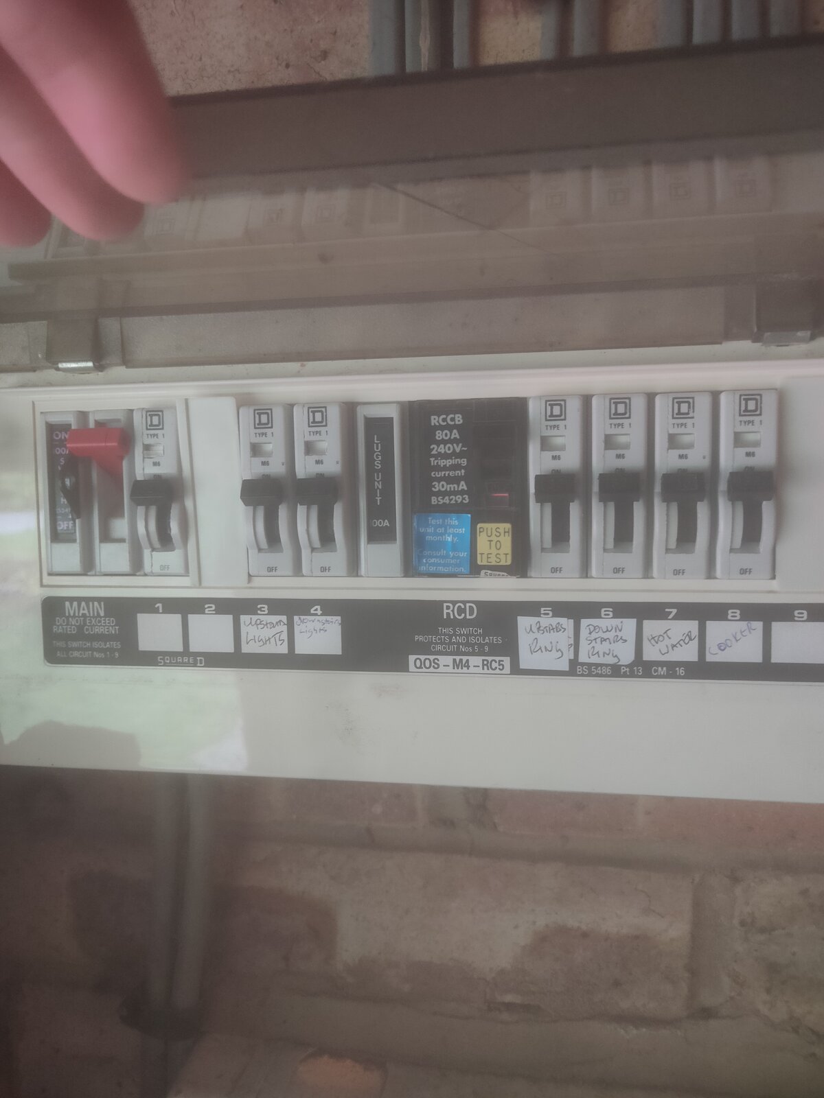

Correct but i'm not sure if this is a mistake as they've intentionally done it to every socket EXCEPT the single socket that comes directly off the consumer unit which i think must have been done by another electrician as it only uses one wire instead of the two and comes off a single MCB. It's how i'd have done it and how i'd expect it to be done. Edit: this is shown in pictures as the only gray wire running horizontally and leaving to the right of the frame.
See pictures attached. I've placed a green dot on the "upstairs" MCB and "downstairs" MCB. Also don't trust the labelling as this was done by a family friend over 5 years ago who isn't a qualified electrician. The dishwasher leaked and shorted a plug and he took the plug out, dried it and then returned it to the wall. I wasnt around for the repair. I can confirm the upstairs and downstairs lights switch off like you'd expect but thats it.
No. They have mistakenly done this to the two ring final circuits.
The single socket is not on the ring.
