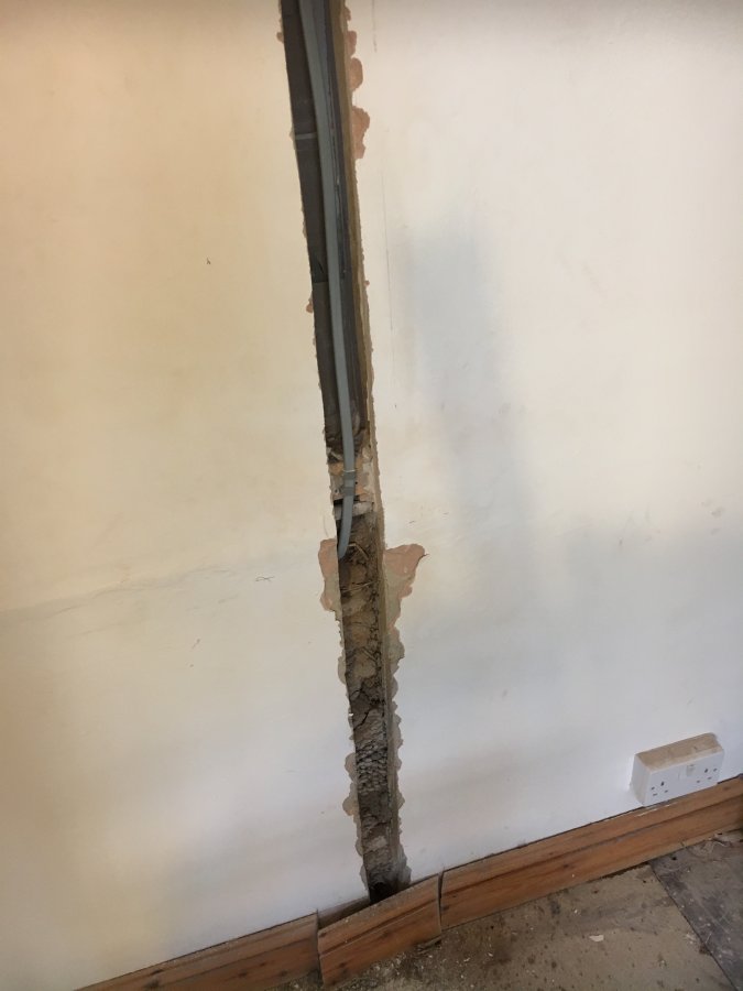

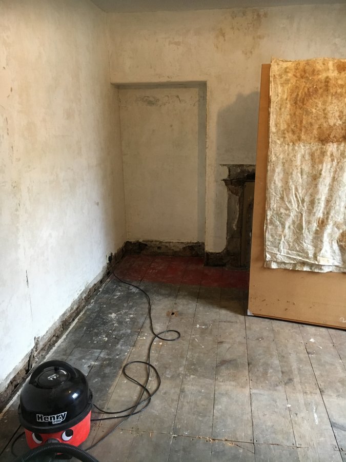

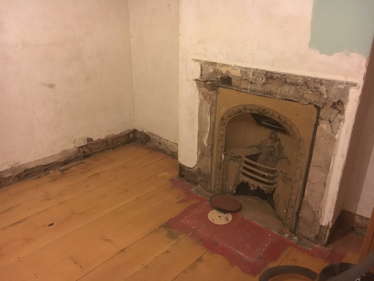

Hi,
I'm aware this may well open a can of worms and leave me more confused than I was before but it's worth a shot!
I've recently purchased an 1850's terraced house in Devon which needs quite a lot of work doing to it. The internal walls in the lounge and bedroom are in a horrible mess and have been hacked about by the plumbers when putting in the gas & central heating, and the electricians when re-wiring the house. Instead of getting each channel individually patched, I thought it would be simpler and have a better overall effect if I just got the 2 rooms fully re-skimmed.
I'm a bit of a DIY novice so didn't realize until I got some quotes for the skimming that my walls are actually lime rendered (over cob-type stuff). Only one of the four plasterers pointed this out and said that you couldn't use the modern gypsum plaster over this (cracks, damp, structural problems etc). I have since asked the other three plasterers and they said it would be absolutely fine, they've been doing it for the past 35+ years and have never had a problem. (One of these plasterers is an old family friend whom I have a lot of trust in).
I don't want to risk damp problems (the house is completely bone-dry, I've not seen an inch of damp so far) and likewise don't want to risk the new plaster cracking and falling off, but at the same time there is no way I can afford to get both rooms re-lime rendered.
What are my options? What are the chances of there actually being any serious long-term problems if I gypsum over the lime?
Thanks in advance

OP,
Gypsum and cob dont mix and match - ever.
What do you mean by "lime rendered"? Are you talking about hacking back to the "cob" or simply skimming over what you've got with a lime skim?
The simplest form of skim for going over your in-situ plaster would probably be "Limelite" finish plaster or a similar remedial skim.
I can see bricks and stone rubble & possibly blockwork in your pics so quite what you have in the way of "cob" is a bit fuzzy - can you post pics of the exterior elevation(s) that show "cob" and/or a pic showing the ground floor thickness of window or door reveals?
There are a number of other issues that you might like to be advised on eg. the possibly dangerous wiring, & possible hygroscopic penetration of soot from your flues.

As for the other q's, I don't have any of those photos to hand right now (at work) - the house seems to have been made from a hotch-potch of materials but the internal walls are a mixture of mud and twigs between a wooden frame (you can sort of see it where the skirting was in the third photo). The ground floor external wall is around 900 mm deep.
