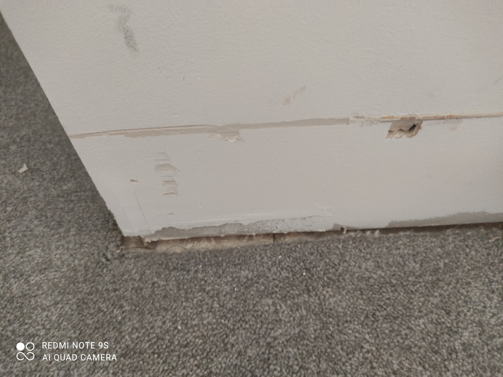

I've removed my skirting and I'll shortly lay a laminate floor which I imagine will sit slightly lower than the carpet/ underlay..I'm concerned I may have the line of the old skirting around the perimeter. What's the best way of filling /hiding

Taller skirting board.
Or use filler and sand off.
