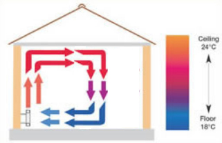

As to electric you have three methods to heat the home, convection, radiation, or heat pump. A resistive heater be it a fan heater or oil filled radiator will all give out the same heat per pound. However when a fan heater turns off you feel the cold immanently but when an oil filled radiator turns off the effect is delayed. Also the fan heater will heat whole of room equally, but the oil filled radiator will cause thermals and the room will have warm and cool spots circulation3.jpgso when I lived in a single glazed hot air centrally heated house, the bills were high, as whole house kept warm, but mothers living room with a radiator place thermometers around the room and they could show 18 - 26ºC depending where placed, morning sun could heat area around the window, but the area next to wall to next room was a lot cooler, in time gone by, we had high backed chairs to protect us from cold drafts.

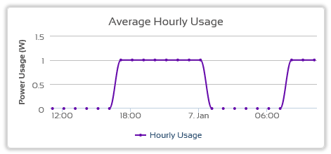

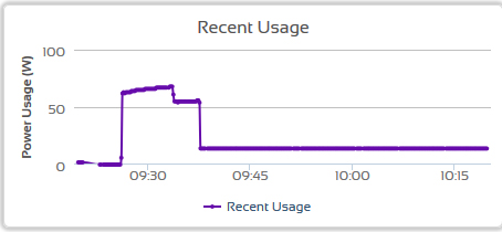

In the main the "Smart" meter is useless, as it is measuring too many items to work out what each is using, Jag-battery2.jpg this shows my battery charger recharging the battery on my car, I used it so I could see when it was charged, but it does show energy used by one device, be it a freezer, or a heater, I can see what each electric device uses. This 1673086628370.png shows my outside Christmas lights turning on and off. The plug in units can use voice commands, although I don't bother, I can say hey google turn on Energy monitor and what ever is plugged in will switch on, the TV advert with a Freddy Boswell look alike clapping his hands is a figment of some ones imagination you can't turn the meter on and off, only the supplier can do that, and using clapping of hands would not be very convenient, too easy to turn on/off in error.
