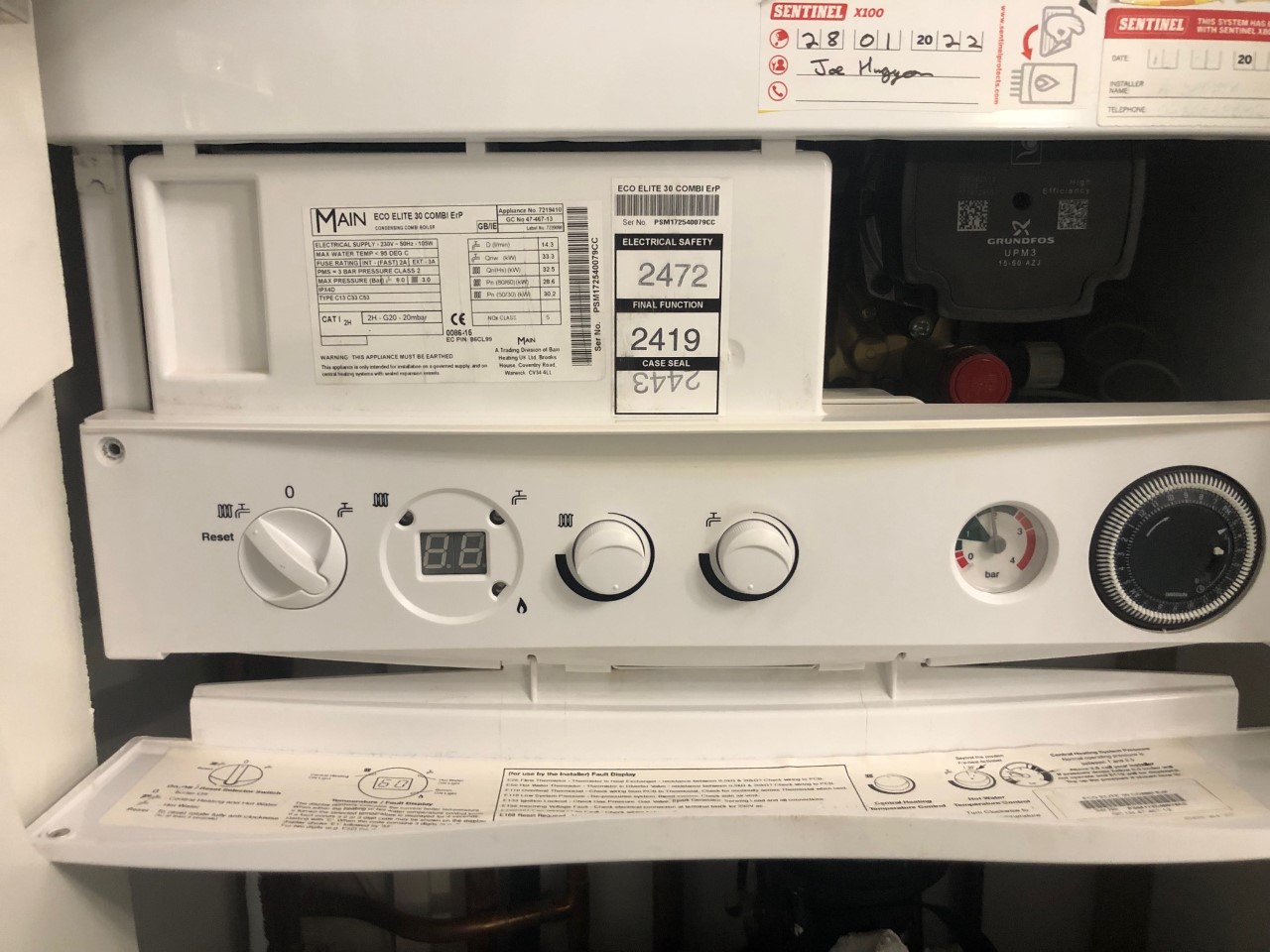

As an aside, I'm just about to install. Does anyone know if my Main EcoElite boiler supports communication module interface? I can't find an industry standard wallplate to wire the hub in that way so I'm hoping so! Might make the wiring a bit trickier though!

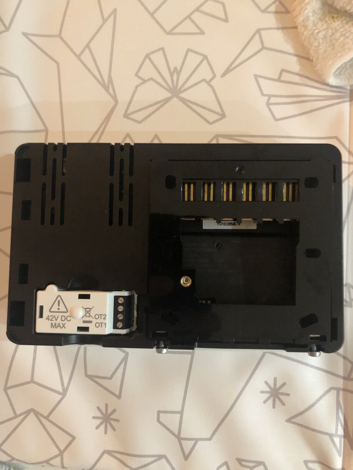

In principle the switching side of the Wiser hub is wired to the external thermostat connection in the boiler with the Wiser power input coming from the same source that feeds the boiler. Any pictures of current programmer and thermostat would assist.

Looking at similar threads, the approach seems to be setting the integral timer to permanently on and then use the external thermostat connection to switch the central heating on/off.

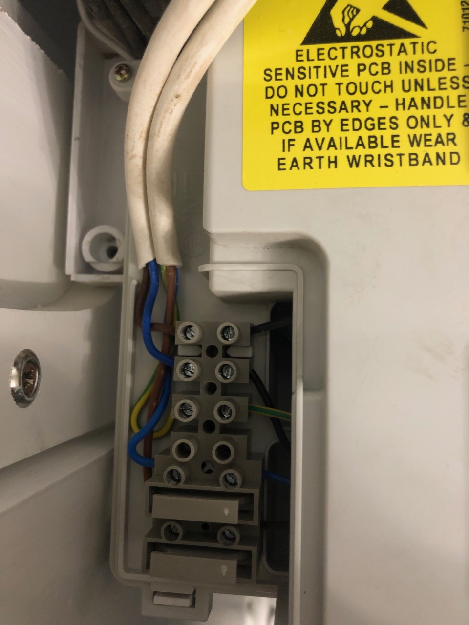

If I have read correctly there should be a control box cover at the left hand side of the fold down panel on the boiler. Under the cover would be the Live, Neutral and Earth connections to power the boiler plus a connection for an external thermostat and/or programmer. The external connection should be labelled 1 & 2. More than likely the 1 & 2 connection currently goes to your wired thermostat but that's something you should verify
Below are some pics.
Pic 1 is in the boiler. The 2 core wire coming in at the top left is going to the current room thermostat.

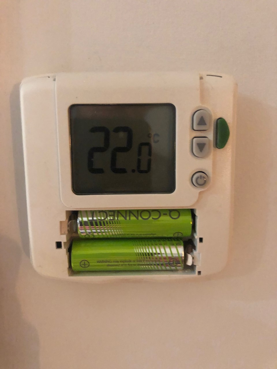

Pic 3 shows the current thermostat which has the 2 core wire going to it.
Pic 4 is the back of the Wiser hub

Depending on how the room thermostat is wired it could be fairly simple. If you can get a picture of the wiring at the thermostat. The keypoint is does it have 2 or 3 cores into the roomstat. If it's 3 the Wiser Hub might just be able to go in the same place as the existing roomstat. However its probably better to locate it next to the boiler.
Only 2 wires at the current thermostat unfortunately. Please see the pics below (pic 1 the top left 2 core is the ones going to the current room stat. How am I best to wire it in in this case?
