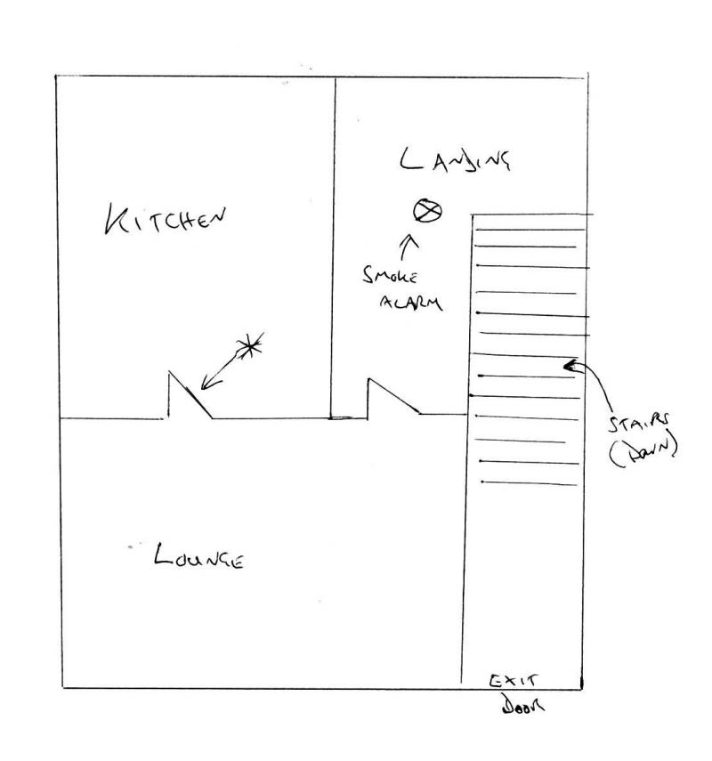

I hope I'm reasonably familiar with the current regs - smoke alarms not to be within 30cm of a light fittings or walls, alarms to be mounted within 3m of all bedroom doors, etc. However I'm a little confused by the "Max 7.5m from any door to a habitable room" clause.
I have a attached a rough sketch of my layout (refurb falling under building regs.) The door between the kitchen and lounge is indeed within 7.5m from the alarm, but that assumes I measure the "shortest" possible distance (ie hugging all the walls across the landing and through the lounge to take the shortest possible route.)
Is this OK??
PS I know someone is going to suggest that I simply put an alarm in the lounge/kitchen, but the place is decorated now and it's going to a major pain to start trunking extra cables around!
:cry:
I think you will find that BC will insist on an alarm in the kitchen, as the most fire 'possible' room in the house it makes sense.
Not sure I understand why the decor would get ruined since its a run on the 1st floor down through the ceiling in 3C+E from the hall unit.
If BC are OK without a smoke in the kitchen then I'd argue that a kitchen isn't a habitable room. It's a functionary room and you are unlikely to spend the night sleep there.

This is the 1st floor of a 3 storey building (ground floor commercial, floors 1 & 2 maisonette) so there is a habitable floor above, hence the decor issue.
If (and it's only an if at this stage!) I put a heat alarm in the kitchen, I presumably don't need to put one in the lounge as well?
Cheers
No you don't, but do check with the BC because there vary from region to region, Council to council.
Rules are hallways on every level and kitchen for Enfield Council.
