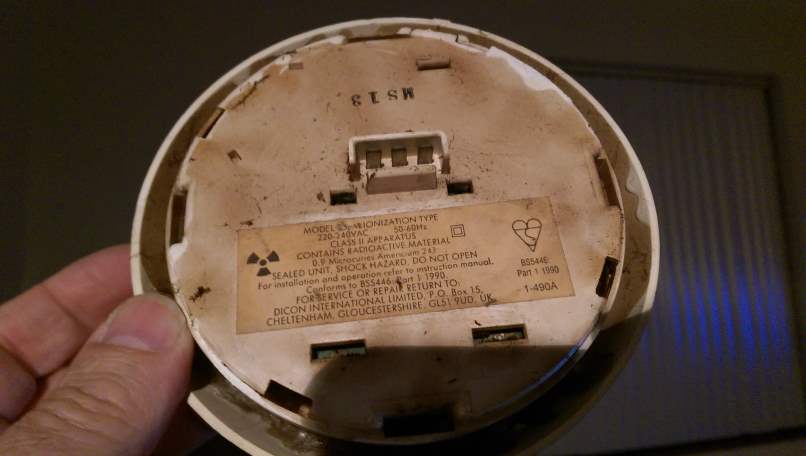

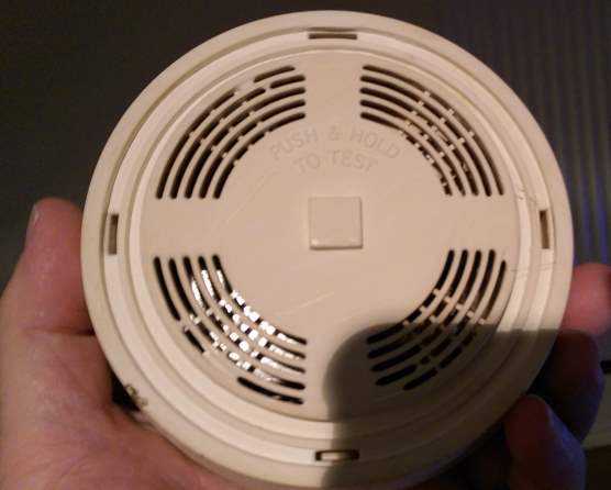

I’ve discovered a fuse missing in my fusebox, with some very faded writing on it which I now realise says “Smoke detectors” (you wouldn’t have been able to tell if you didn’t know, if you get me).
So I assume one or more of them was either constantly blowing the fuse, or more likely going off all the time. If you look at the label, through the nicotine, you can see it was made in 1990 (house built 1994, so about right), so they’re probably all knackered I’m guessing…?
So my (hopefully sensible this time) questions are (1) is that some kind of standard electrical connector which a modern detector will still fit; (2) is my best plan to take them all down, replace the fuse, buy a detector from Screwfix, and try it in each socket to see if it works OK – if so, buy a pile more?

Smoke detectors have a life of 10 years - yours are expired, and being full of nicotine they would be useless even if not expired.
There are no standard connectors - each manufacturer uses whatever they want, and manufacturers can and do change things over time, so it's unlikely you will get one to just plug in.
However the connections themselves are just L, N, E and an interconnect - very easy to fit a new connector should the new alarms require such a thing.

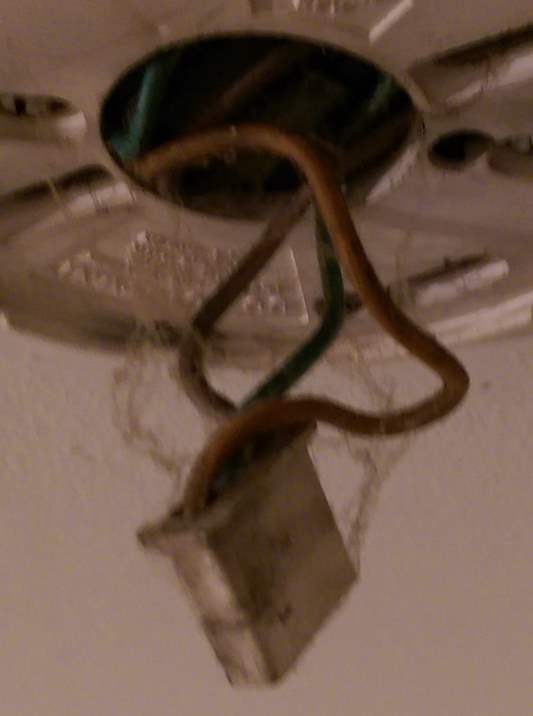

Here's the wiring - not sure which wire is which. Obviously I can check for live if I put the fuse back...
Keep pulling, you might need to take the base down but up there behind it will be some connectors and then standard T+E/3 Core & Earth.
You should have a twin+earth and 3C+E at the first smoke from the board, two 3C+E at the second and a single 3C+E at the last smoke. You may not have a smoke with a twin+earth at it as some people will, unnecessarily feed the circuit in 3C+E from the board.
If this is the case you will need to establish which is Live & Neutral, you will then be left with the spare core which will be your interconnect. The earth will need to be connected to the brass terminal to keep continuity.

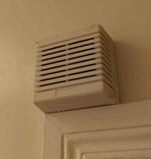

Oh, and what the hell is this? It isn't the doorbell :confused:
Half way up the hall, above the airing cupboard door, with what looks a bit like a telephone wire disappearing into the ceiling in the airing cupboard...
Internal sounder for an intruder alarm.
