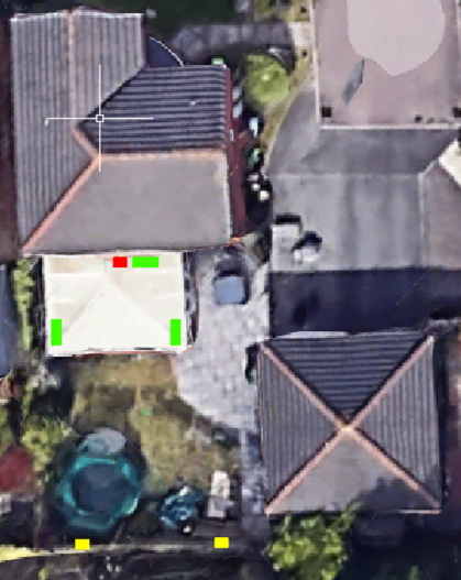

There are 2 security lights on the back fence that to my knowledge have never worked - The wire disappears underground but I would think that these are fed from the garage, everything is still on in the garage. See attached file for a bit of context.
Red - Unswitched fused spur
Green - Sockets
Yellow - Security lights
I will try to disconnect the security lights, see if this makes a difference.

security lights maybe the issue - any rain recently ?

So I checked the security lights & they were full of water, I traced the cable which was behind the fence to a plug that was plugged into........ a pile of leaves on the ground. So that's the lights ruled out.

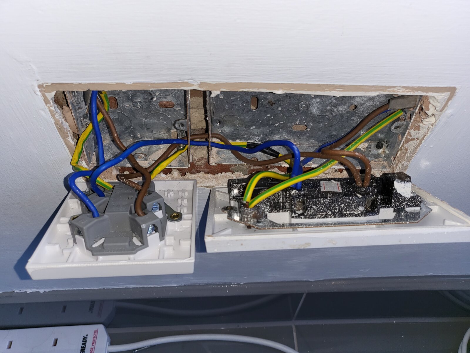

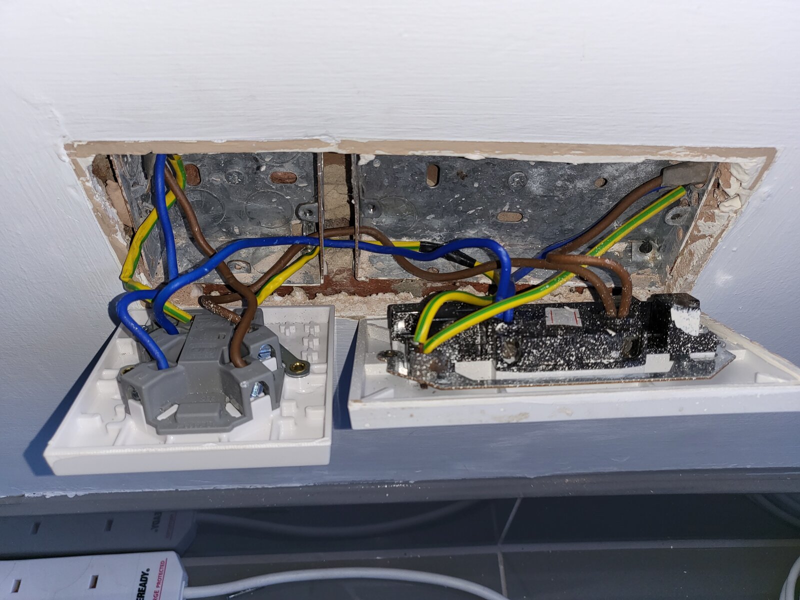

As for the cables, see attached photo. This is the spur and 1st socket, the second has 1 in 1 out and the third 1 in as you described.

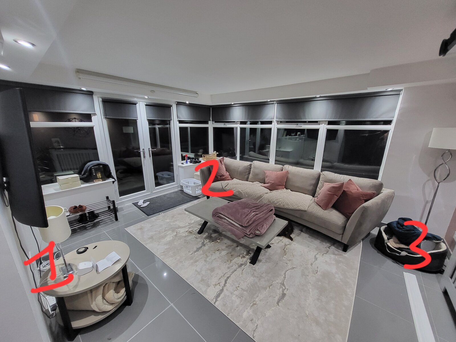

The conservatory has half block walls and a solid floor, the roof has been insulated & under drawn with a plasterboard so the wires may chase up the walls into that roof void? (see photo).

Ok... just done what you suggested and the RCD hasn't tripped so its either socket 2 or 3!

....but the wiring in your photo strikes me as a 'builders' installation, rather than an 'electricians' one!
With, for example, no rubber grommets in the back boxes.
It would also be interesting to know what was under the PVC tape on the earth sleeving (probably just joining two pieces together).
Apart from that, can I just clarify that the projection screen is manual, not motorised, and there isn't another hidden outlet to power a projector?
...and it looks a very nice space :)

Your photo shows single insulated wires passing through the holes of the metal boxes.
These holes need 20mm open grommets inserted round them.
With the sharp edges able to 'dig' into the wires, this is a very possible cause of your tripping.
Check to see if these wires are damaged, and get some 20mm open grommets.
I also see some cables come down the wall to the sockets, so check in case something has been screwed into the wall and damaged a cable.
