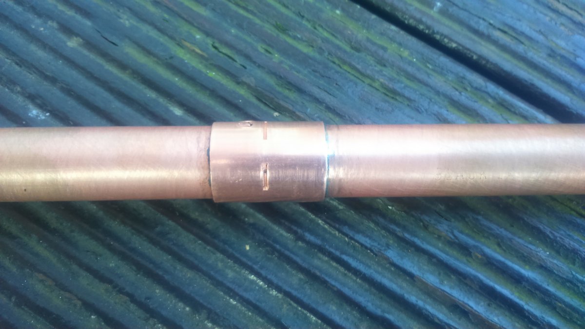

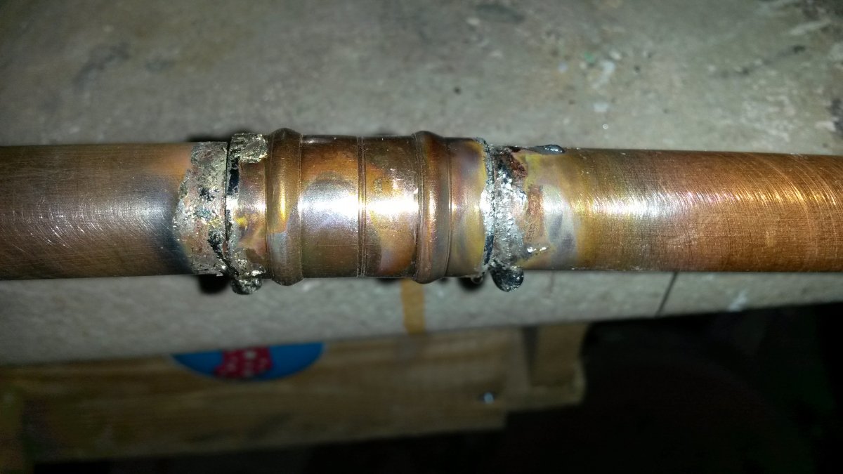

Photos of top and bottom. Note, I did try a number of times on the same bit. I know thats not a good idea but I was just practising :)

Yep, massively overheating the joint. Smaller flame and keep it moving. Don't try to get the joint as hot as possible in the shortest amount of time bring it up slowly. I'm doing a bit in a minute so will try and get a pic so you can see the size of flame I use on 15mm.
Jon
Remember that solder melts at about 200C, i.e. the temperature of a hot oven. Really quite a low temperature compared to a flame.

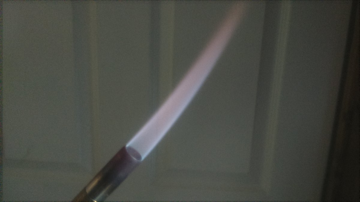

Not great pictures as they are from my phone but this is the kind of flame I use for 15mm

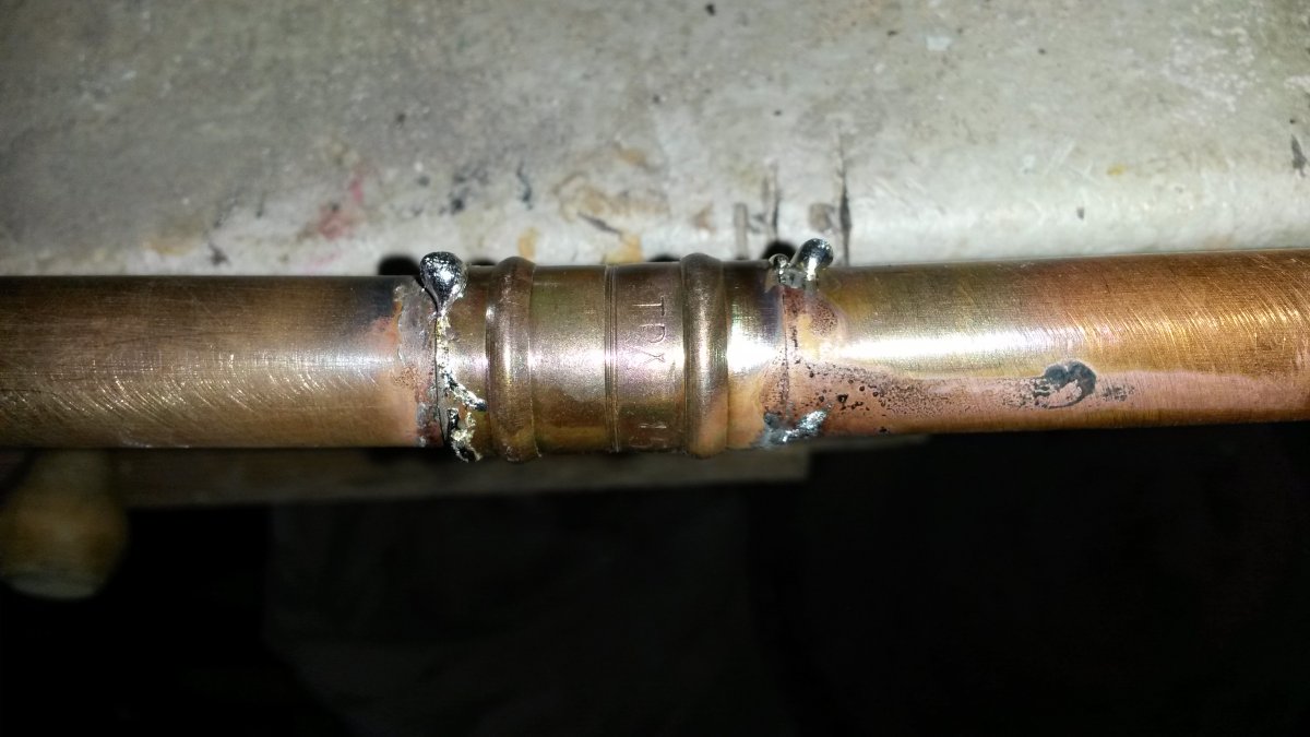

And this is the end result you should be aiming for
Jon
Cheers. Judging by the big blue cone on my flame I guess its WAY too hot o_O
As that's as low as I can go I think I'll need to invest in a better torch or different gas.
Just keep it moving quicker and take the flame away every now and again to build up heat slowly if your torch won't go down any lower. It's all about controlling the heat.
